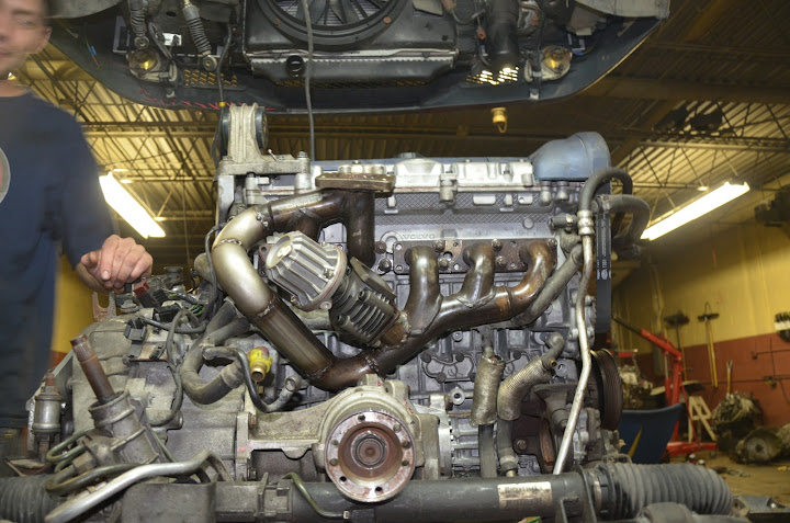

This is a video of my V70R. For those that dont know it is a compound setup with a smaller then stock LPT turbo and then a GT35R. It runs off megasquirt. It is also a 6 speed and converted back to drive by cable from wire. I could not be happier with how good it runs. It really feels like a V8 with the throttle response from the small turbo. There is really power everywhere. I am only running 18psi now but will turn it up to 30 once I wiring it my new map sensor. If you listen you can here the first turbo spool right when I floor it at 3k then the 35R starts to spool at 4.5k. This is even earlier then my GT3076 would spool when I had it. I did this pull in 3rd. It goes from about 40-100 in 10 seconds rolling on the throttle.
