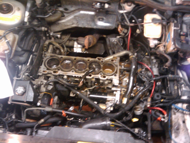

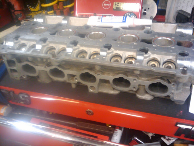

know one else was going big at the time so i started cutting ;)
picked up a front end totaled 00R for 1500 bucks, stripped it for the whole interior and motor, sold off the tranny, turbo, and misc stuff and made back about 900 bucks :D
the build block

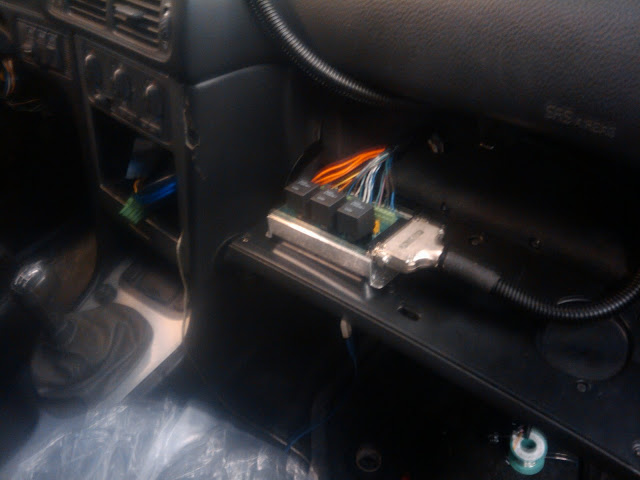

took a little drive down to ipd to visit lucky earlier today, figured i would do a bit of street tuning, see if i could get the boost tuned in...well that didnt work to well, car died in the middle of the road :lol: relays have a bad connection in the harness, so now i need to drop 170 bucks on a relay box and relay harness and redo some wiring :( theres never time to do it right the first time but always time to redo it later :lol: fml.
#17 mdlimy
mdlimy
  • 3,380 posts
Posted 13 March 2010 - 06:46 AM
been soooo busy lately havent worked on it at all till tonight, started installing the relay board since i didnt like the ghetto hardwired in relays.
