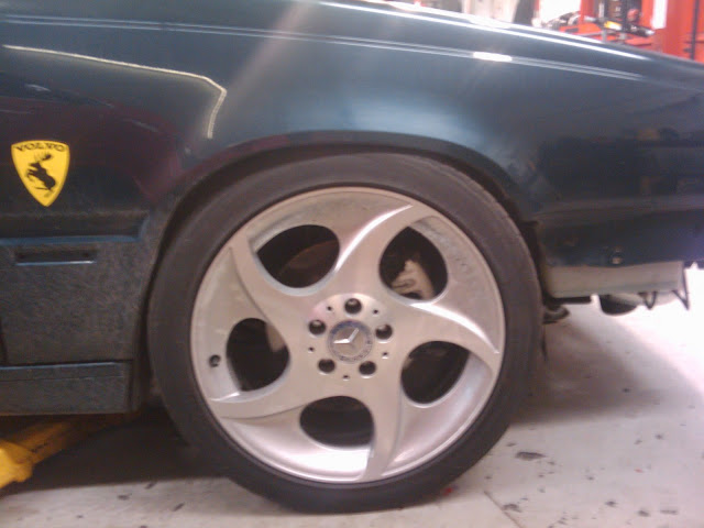

View Postmdlimy5, on 28 March 2010 - 06:58 PM, said:
They are bolted on with the stock lug bolts, tighten on evenly by hand and it bolts up nice and flush on the hub then just torqued down really really tight, works fine, i recheck them very often and i have yet to find a slightly loose lug bolt, no shake anywhere all the way up to 100mph, they are hub centric so i dont have to worry about centering the wheels on the lugs.
the benz wheels are 5x112.
I think the reason you were able to do this is because the log bolts for the benz must be 14mm or bigger while the 870 cars use a 12mm so the bolt is actually slightly smaller than the hole it is going through and allows side to side adjustment enough to act like wobble bolts and allow them to bolt right up. I have a feeling with the p2 bolts being 14mm that I couldn't bolt those on my car without getting adapters.
you are correct, my volvo lug bolts are smaller than the benz ones.

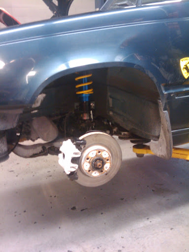

Posted 08 April 2010 - 07:45 AM

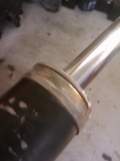

a bit of an update, had a long day at work, stayed after to work on my car till about 10 oclock, got some stuff done.

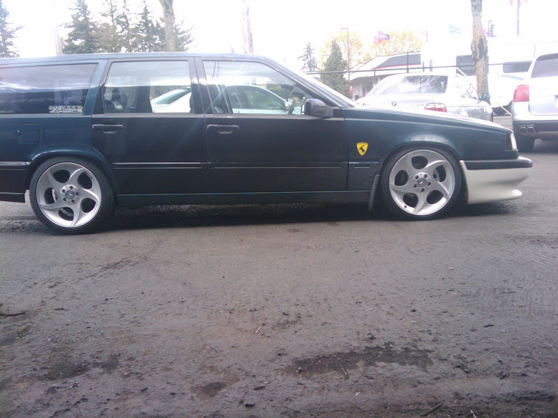

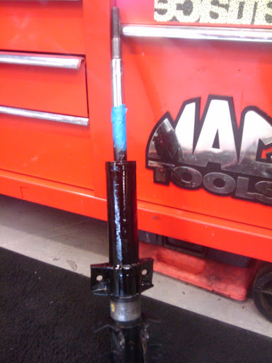

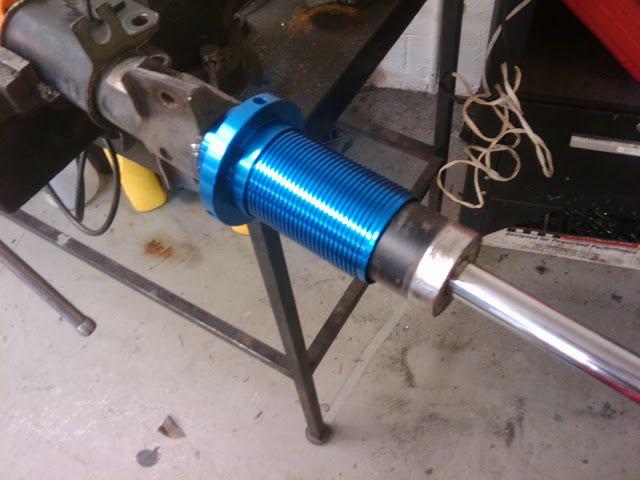

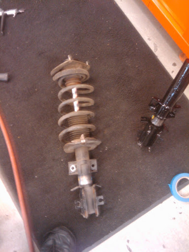

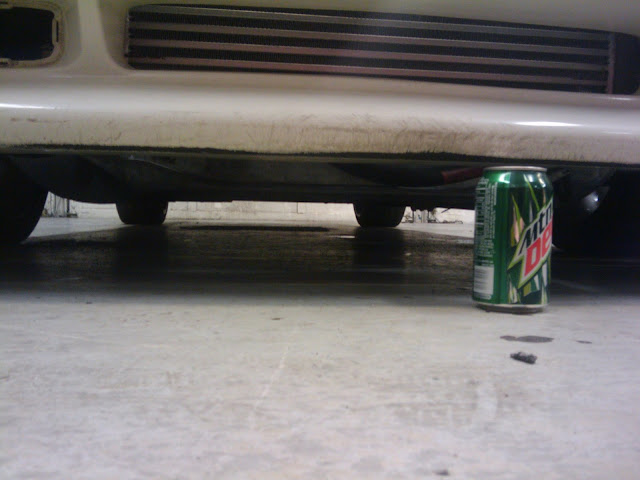

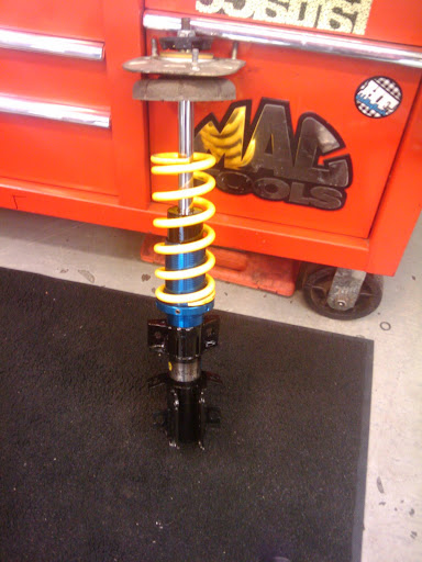

Pissed off that my koni yellows still arent here yet i assumed i probally wont see them before davis so i ripped out the bilstiens and did some diy coilovers, i have nothing to lose, these struts have been taking a beating on the cut springs already and to my suprise they are still holding up pretty well.
Same procedure as koni diy coil overs except a bit more has to be ground on the top lip of the strut housing as you can see in the pics.
out with the old
this needs to be ground down just slightly
then of course cut and grind the spring perch off...and viola!
after a pressure wash and some paint
jesus that is a gap :lol:
dindt bother moddifing or making the upper mount on this setup, it will work fine like this till i get my konis for the real setup.

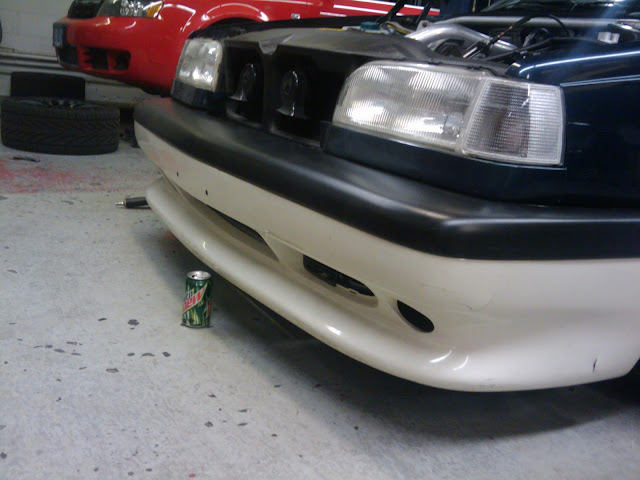

money shot B)

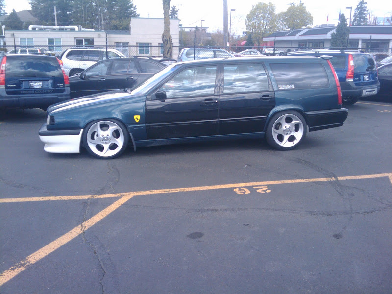

uh oh too low for those tires, picking up the 205/40s tommorow, then winding them all the way down.
too much tire in front but it sits better, flush for sure :lol:

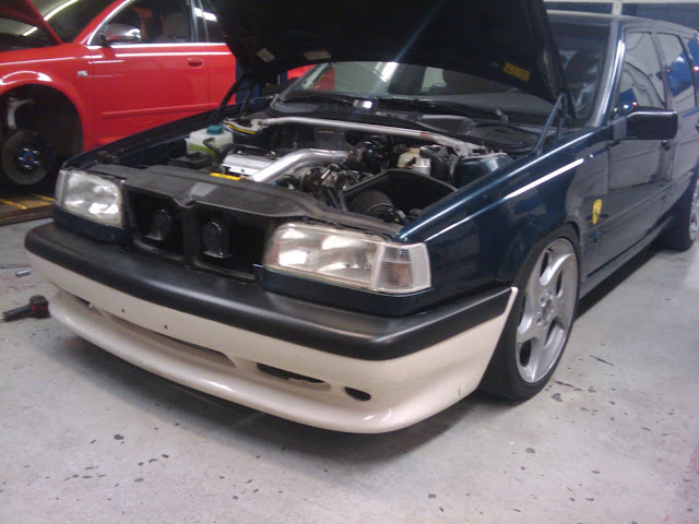

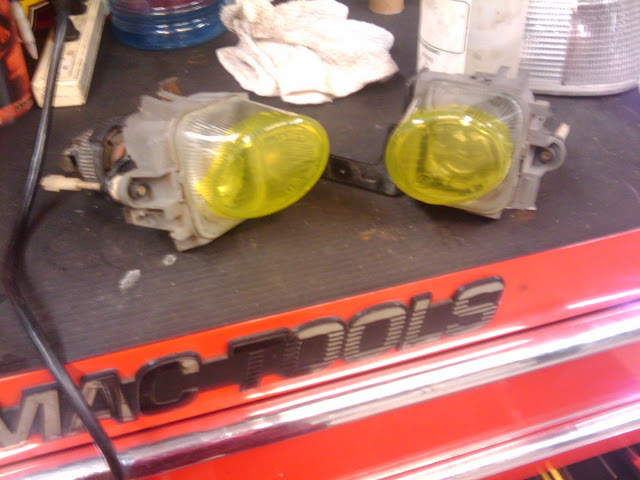

tinted the fog lights, and mounted them (no pics tho, was in a hurry)
threw the bumper on, still need to do a few things in that department....damn fender liners.
getting down there, hope to alot lower with the new tires, might even need a skid plate :lol:

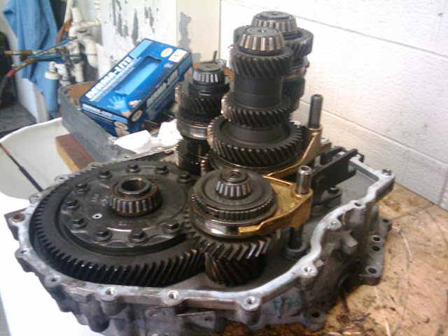

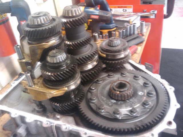

Customer grenaded the dif in the m66, still waiting on the new tranny, customer threw a spec stage 1 at me to toss in while its apart.
tore apart the m66, havent pulled the diff yet but the rest of the tranny apears ago, lots of metal shavings came out of the oil tho. Will be getting a quaife soon B)

  • Location:Milwaukee
Posted 08 April 2010 - 01:36 PM
Those stock struts that you used for the diy coilovers? Bilstein HDs work for diys?

Posted 08 April 2010 - 04:05 PM
i am using Bilstien Tourings, going by the 2 pics i have of tourings and HDs i would think it would work, might even be less work since it doesnt have that top lip, but still the main tube could be bigger.

Posted 08 April 2010 - 04:45 PM
Nice. By the pics the tubes don't look like they're different sizes. After the swap and everything I'm going to look into this. Glad to see someone doing it on something other than the Konis.

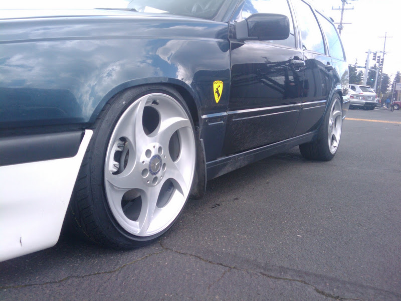

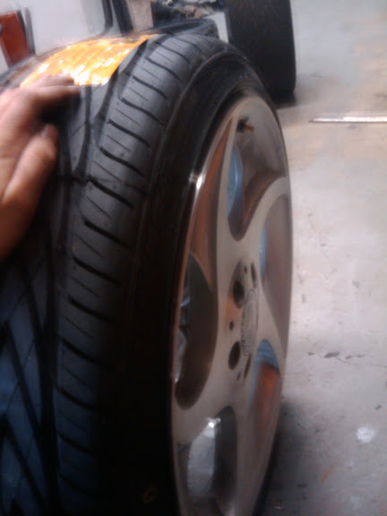

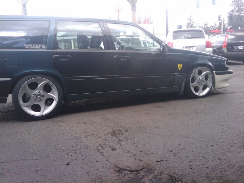

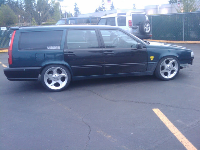

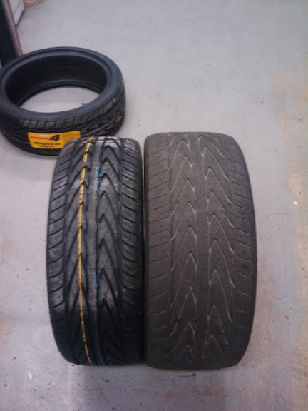

Thanks Matt! on the rear i have 245/40s and i just picked up two 205/40s for the front today, they had some mistake at les schwab and i got them for 64 bucks a peice!
soooo, update.
much better ;)
too much gap <_<
ahhhhh much bettttter! B)
rear needs to come down and out a little
thats all for now, oh and fogs.
ordered my corner light sockets for the Euro corners, trying to get this thing together somewhat before davis!
