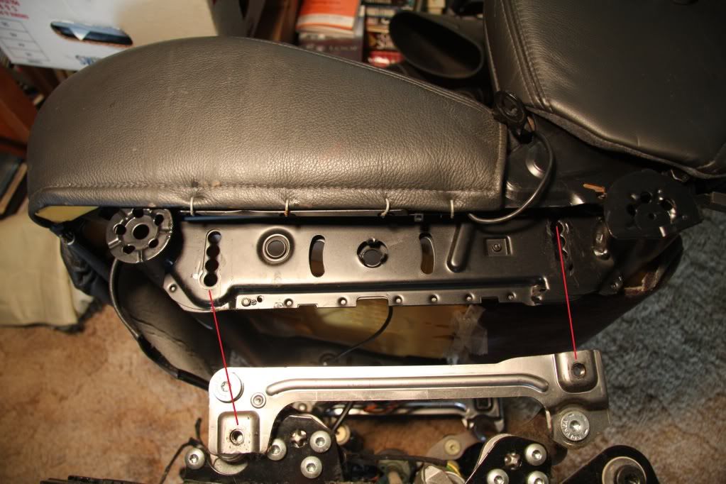

So I looked everywhere and of course when you actually need them, you can't find all of the pictures you need. I found only one picture that shows the S80 seats actually installed in the 850.
Below are a few pictures of the S80 seat that I still have after pulling it out of the 850 and swapping the 850 rails back onto the 850 seats I had. There are 4 bolts that hold the seat to the rail, two on each side. When you pull you're seat apart take note of where the old bolts were positioned in the 4 possible holes, depending on which hole you use you can adjust the tilt of the bottom cushion to a certain extent.
Below is the rail for the S80 seat. The red circles show where the rails mate to the seat. The picture with the red lines shows how everything lines up.
It's a pretty easy swap for just the mechanical part of it, but the wiring is where it starts to get tricky. I've looked for some kind of wiring diagram for the 850's and S80's and haven't found much of anything. I think this may become a more popular swap to do as time goes on and our 850 seats fall completely apart like we know they all do! :)
Good luck and let me know how it goes, and post up some pics if you do it!

Seeing how you got the power seat frame apart has me rethinking my recaro attempt...
on the manual seat, those 2 support beams are part of the base, removing them means no height adjustment. And that beams are screwing with my height (head vs sunroof lolz) whereas on the power seat it looks like i might be much better of than i had thought...
