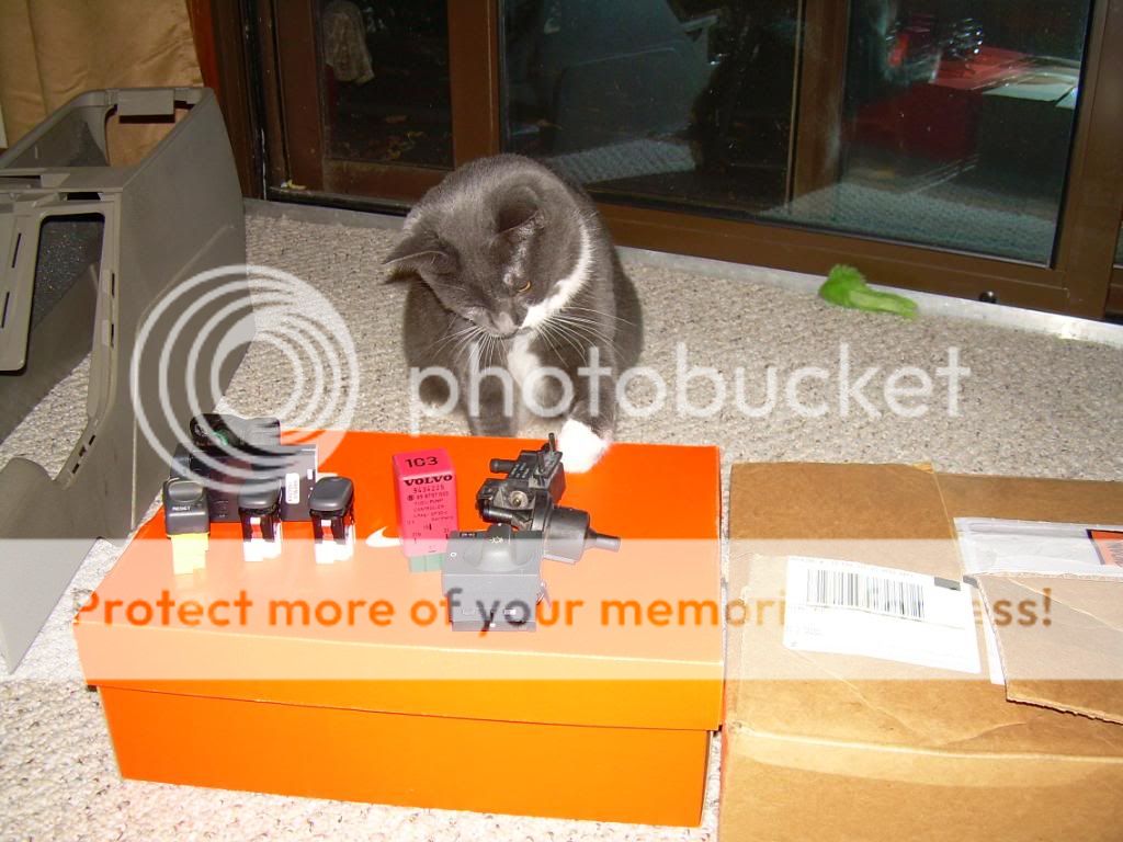

Could be anything eletrical but as you said you tested spark etc etc i would start to look into switches such as the PNP or maybe even the ignition cylinder itself? your getting signal to run the car as the starter engages. this leads me to believe either you start it for a very short period of time & it "mini hydro locks" your car. AKA lawn mower syndrom.
Are you prone to short trips? or a lot of on/off crap like oh move my car **on** 2 sec later okay done **off**?
FRP - Fuel pressure regulator yes but i kinda meant Fuel Pressure RELAY :P they are lovely pieces that i guess people have issues with "103" is on the top of it under your fusebox. I have a FS thread S70 Crap & Crapola there is one in the picture. im not pushing you to buy it im just saying thats what it looks like.

its red & 103 like i said
