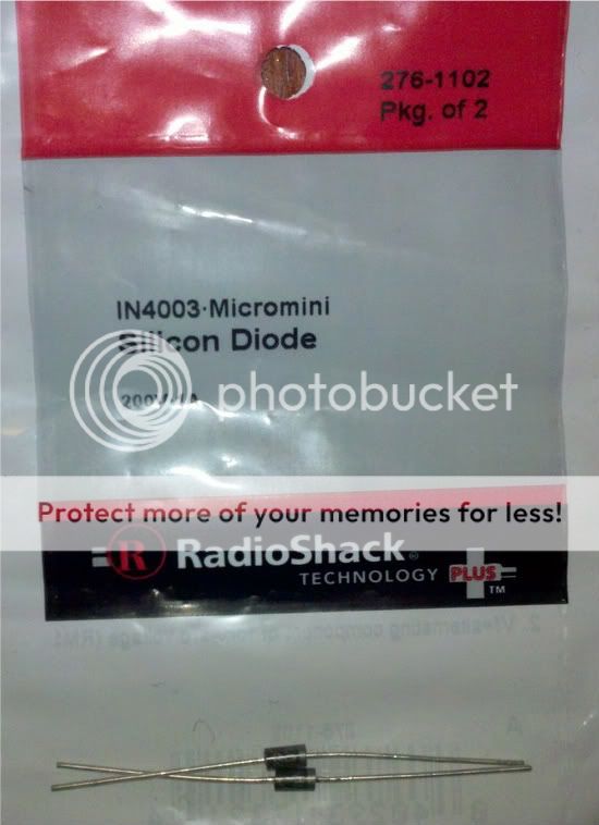

That's the diode right?

Looks just like the one I used :tup:

You can also get them on ebay, I spent 99 cents for 100 count. instead of 99 cents for 2 :lol:

Shoulda ordered them from Mouser...10,000 of would have been @ $20.00...thats only $0.002 apiece. THATS a dealPosted Image

what are you going to do with 98 other diodes if all you really need to use is one? :lol: :P
