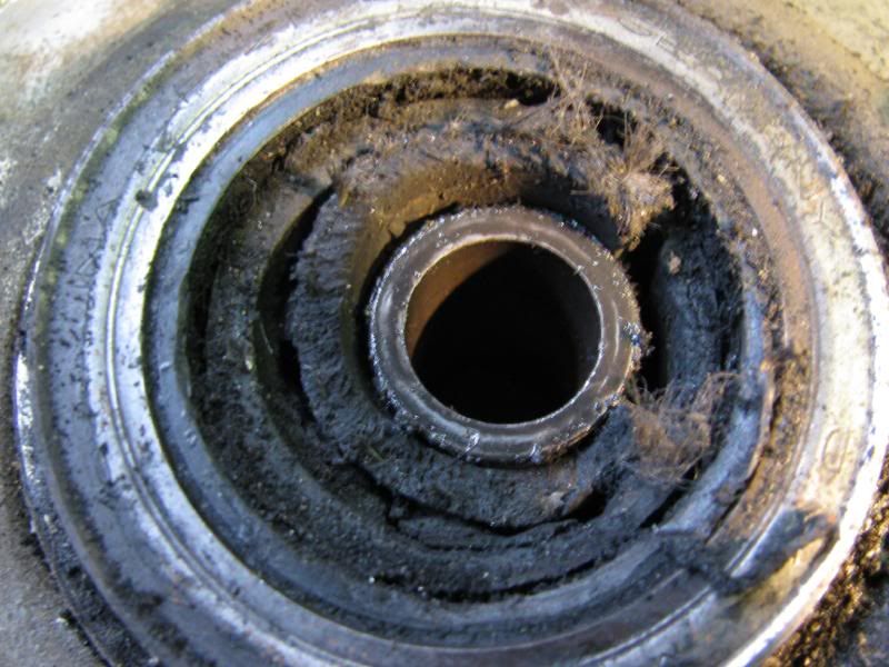

Upon closer inspection It looked like my V70 had the optional chassis lubrication system.
