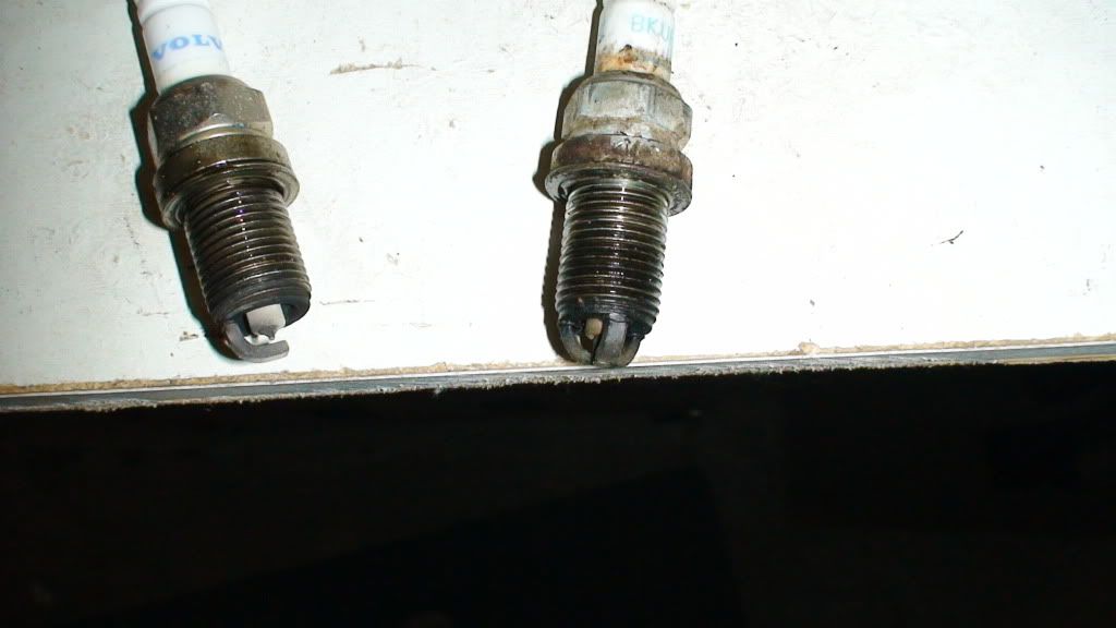

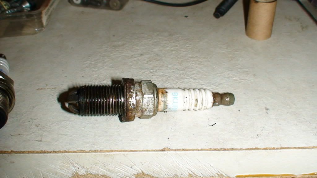

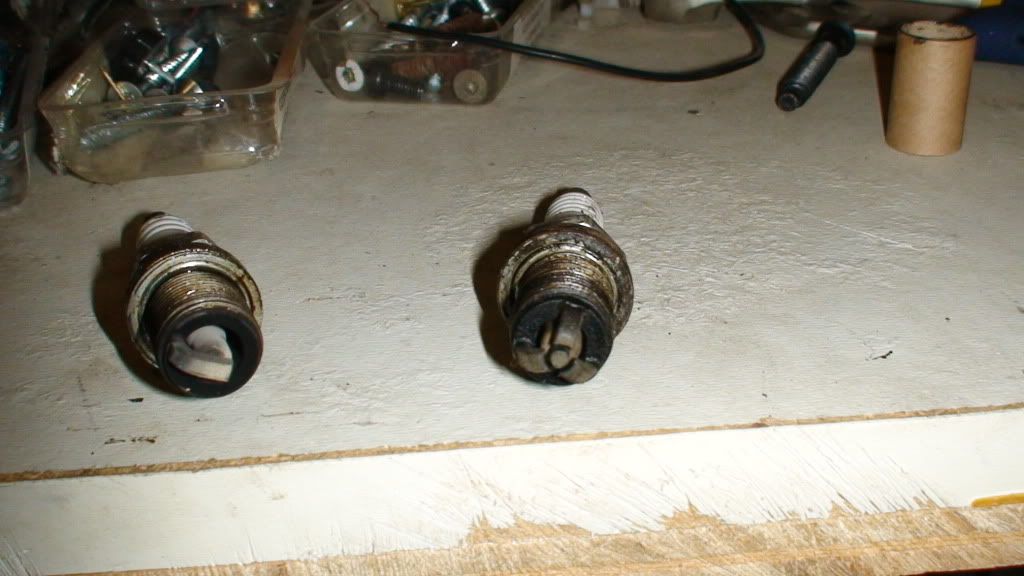

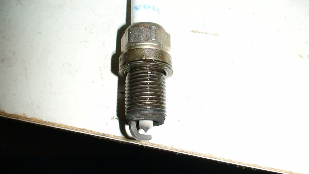

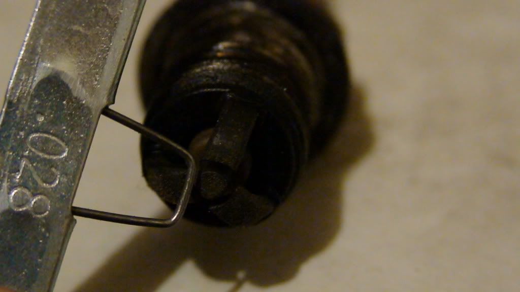

So I'll start off with a some updates, then I'll get into the good stuff...

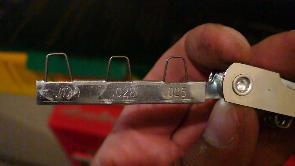

So when I installed the new turbo along with the intake manifold earlier this year, I also installed brand new IPD ignition wires along with brand new Volvo plugs. What I had taken out were a special plug I was experimenting with and had worked out great for over a year in the car. Well the volvo plugs lasted about three months, and then they started to act up, and I know before this gets into a plug discussion this is for anyone who has a car that is no longer considered stock, or has been heavily modified...
So a couple of months ago I re-ordered these special plugs and swapped them out and they have been running great...
Below are pics of the plugs:
The pics above are of the volvo plugs I took out a couple of months ago, and original plugs I had in their before I put in the Volvo plugs. Also before anyone says you cant gap this style of plug, well I did and the car runs phenominally...

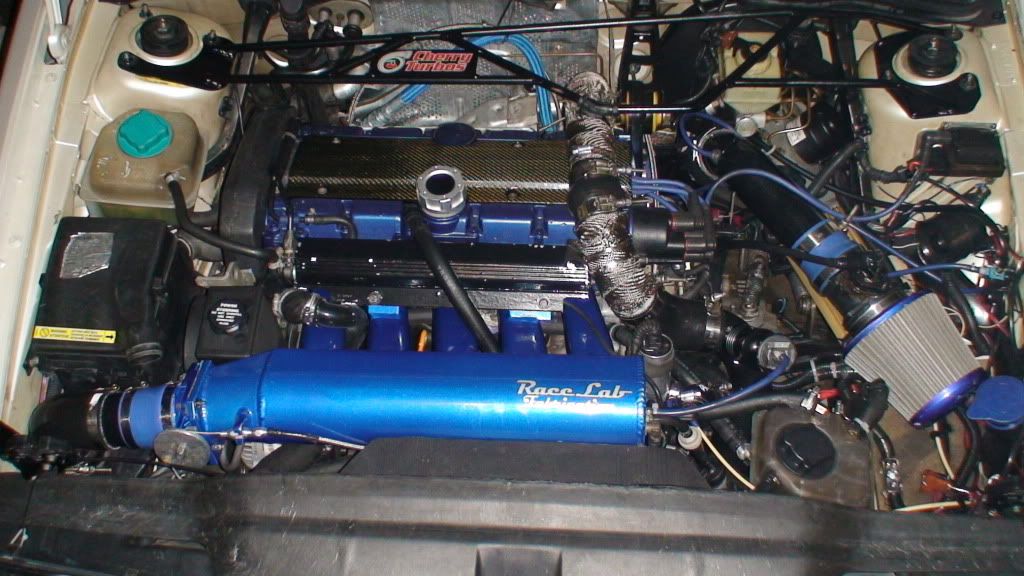

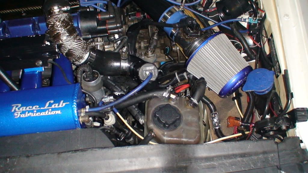

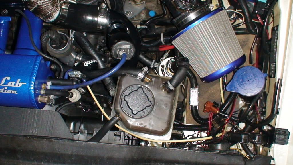

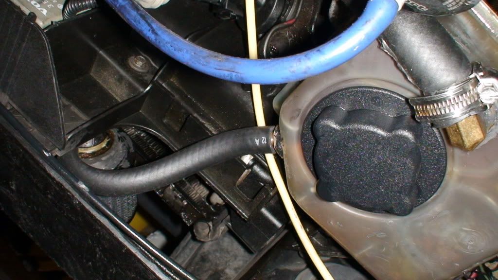

The other issue I had recently has been my catch can, if some of you don't remember I had setup up a dual catch can system, with my primary comming directly off of the the line that would normally run to the PTC, now running into a proper catch can, this instead of venting to atmosphere or dumping back into the intake, I had it run to a secondary catch can (overflow). Also I had vented the crankase at the head and ran a T off of the stock line that runs off the head into the stock box below the manifold, well my T ran a 5/8" line directly to the secondary catch can (overflow). My secondary catch can was a spare coolant tank that I had worked the neccesary barbs and drain to be used for this purpose... My original setup had the vent positioned direclty in the cap of the oveflow/ secondary catch can, which ultimately ruined the caps ability to seal properly. My new reworked setup has a standard cap in place and a new port for the filter/ vent. This setup didn't leak one bit at the dyno session... and all day driving today, so all I can say is so far so good, but only time will tell.
Below are pics of engine bay and re-worked catch can, vent system...
