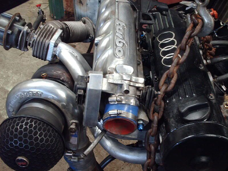

The HX35 is a mean turbo, but its big, I'd imagine you'd need to make more room.
They do have a nasty top end, I have a friend who had a MEAN hx35 setup on his 10v Audi 5cyl in a 88 5000. Thing spooled up 3-4k -ish in RPM's and would pull like a train. That motor is probably a better representation of what it would be like on a volvo 5cyl.
