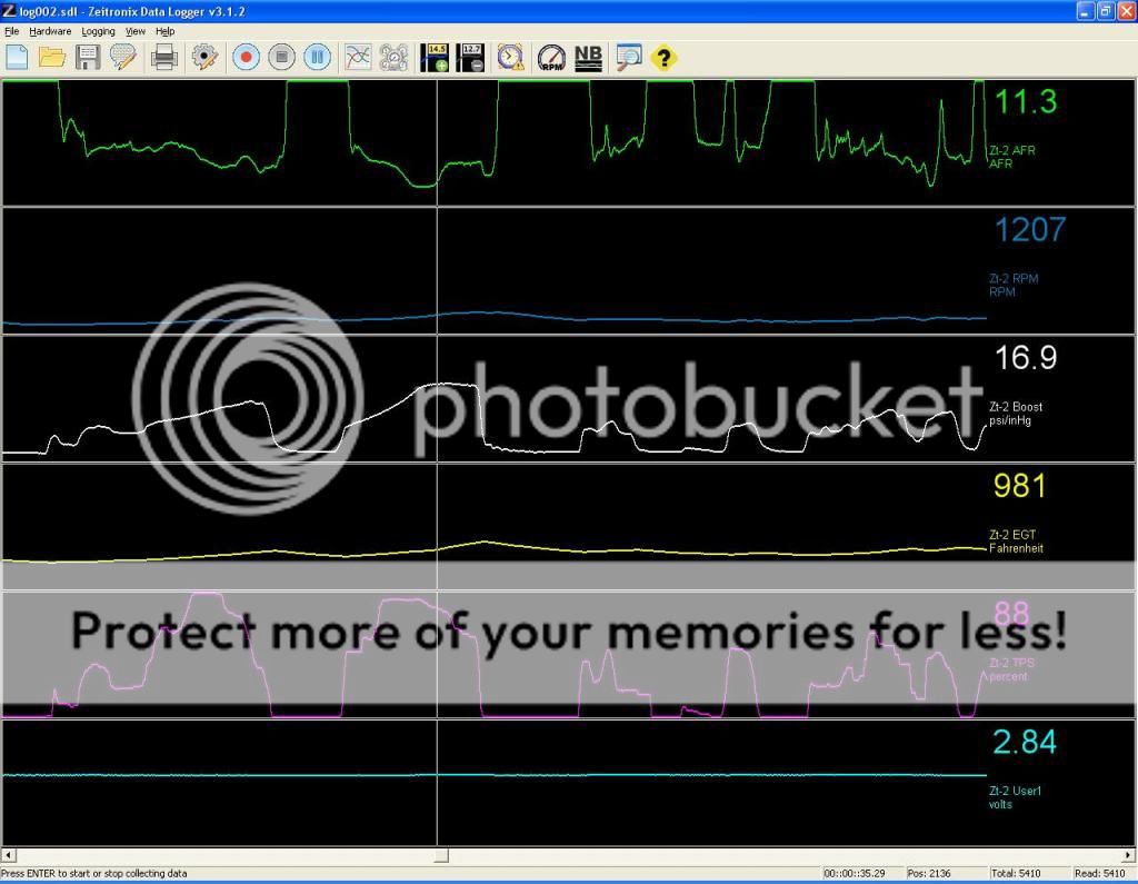

Oh, one other thing. The black box logger rocks!
Autocross logs are the strangest things to try to read. :lol:

Do you have screenshots? I'm curious to see them....
I will try to get a few screen shots of them. Its mostly throttle position changing constantly based on what I am encountering on the track, but very seldom is it 100%
Here is a section from the middle of the run. The RPM line needs to be muliplied by 4 to get the correct number.

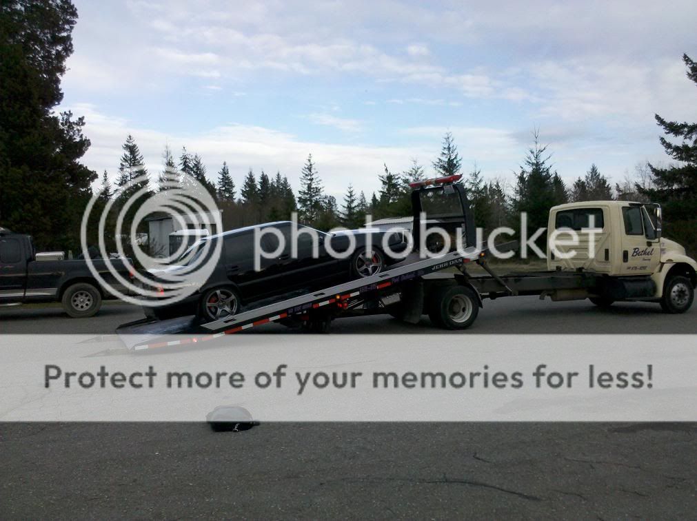

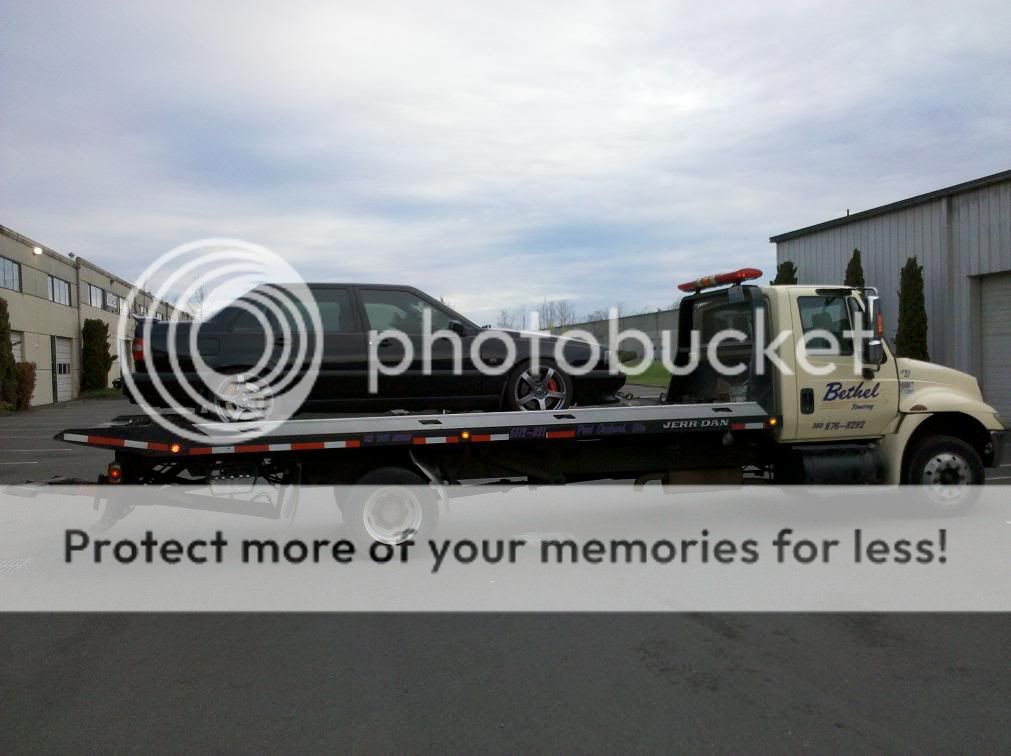

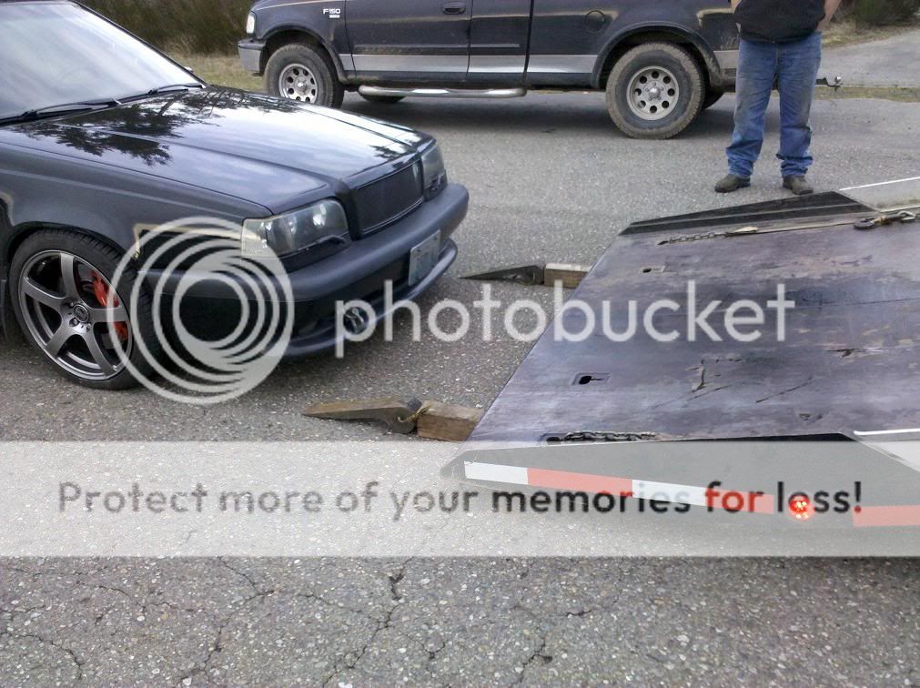

Posted 03 April 2012 - 04:35 PM
Not leaving the track under its own power this time, although it could have.
Dropping it off at TC Motorsports.
Right now thinking broken valve spring given the random tapping at the top of the engine. Something is definately loose in there and moving around.
I hope to know more by this afternoon.
