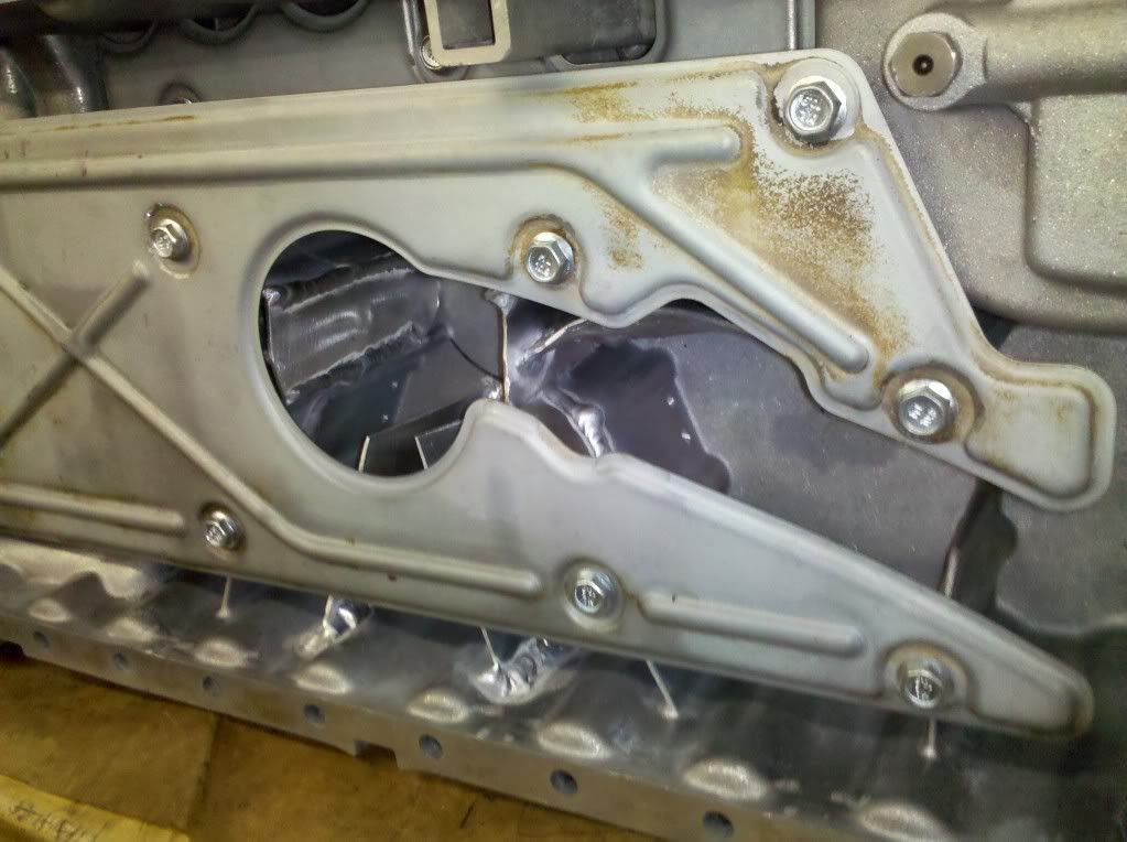

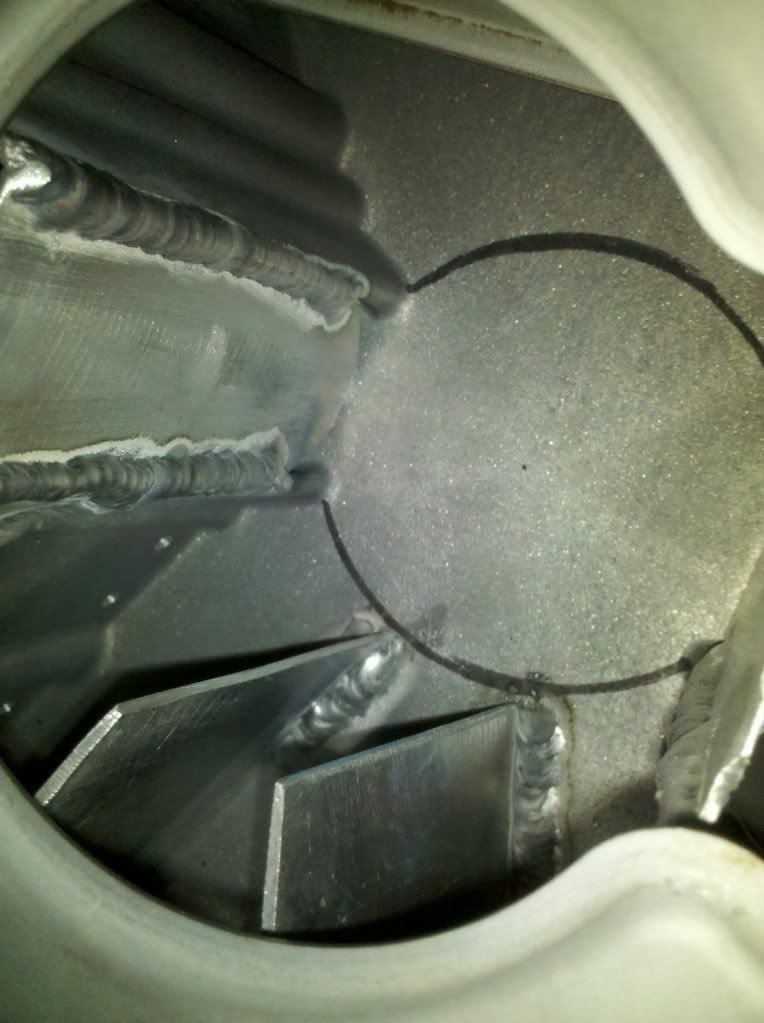

Cosworth pan.

Sucks George. Must be frustrating. I'd probably run Rotella before I ran royal purple.

^ Did you get that off CJ? Looks good!

Posted 11 April 2012 - 05:09 PM
I took his picture and posted it here.
I don't have the pan or anything. :) If I did, I would be far more excited.
I just posted it here as another example of what has been done.
It is frustrating that I am now running into race car problems. I guess I am pushing my street car into race car territory.
I am a pioneer now, at least in the US. :P

^Where can a small guy like me get a cosworth oil pan? or would it be cheaper to build that trap myself?
#277 andyb5
  • 3,291 posts
  • Interests:cars?
  • Location:North Kingstown, RI
Posted 11 April 2012 - 09:42 PM
Are those hinges welded to the baffles? :blink:
#278 Jardim
  • Interests:Being a volvo rat, working for that dollar to feed my addictions.
  • Location:Central Mass
Posted 11 April 2012 - 09:54 PM
Looks like rivets where the screws would go.then weld
#279 gdizzle
  • 20,460 posts
  • Location:La Plata, MD
Posted 11 April 2012 - 10:02 PM
Spot welds.
#280 andyb5
  • 3,291 posts
  • Interests:cars?
Posted 11 April 2012 - 10:40 PM
Look at the bottom left plate, in the middle of the plate, above the tube opening. Sure looks like a hinge
