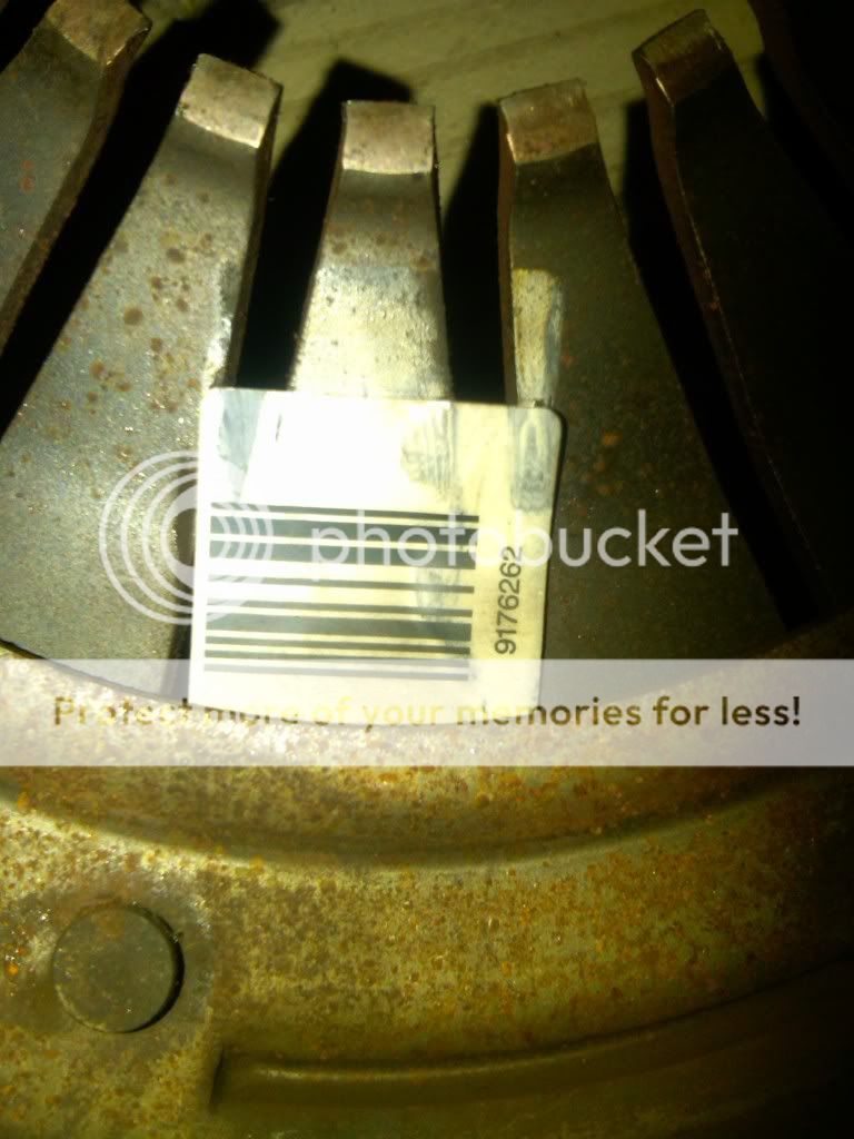

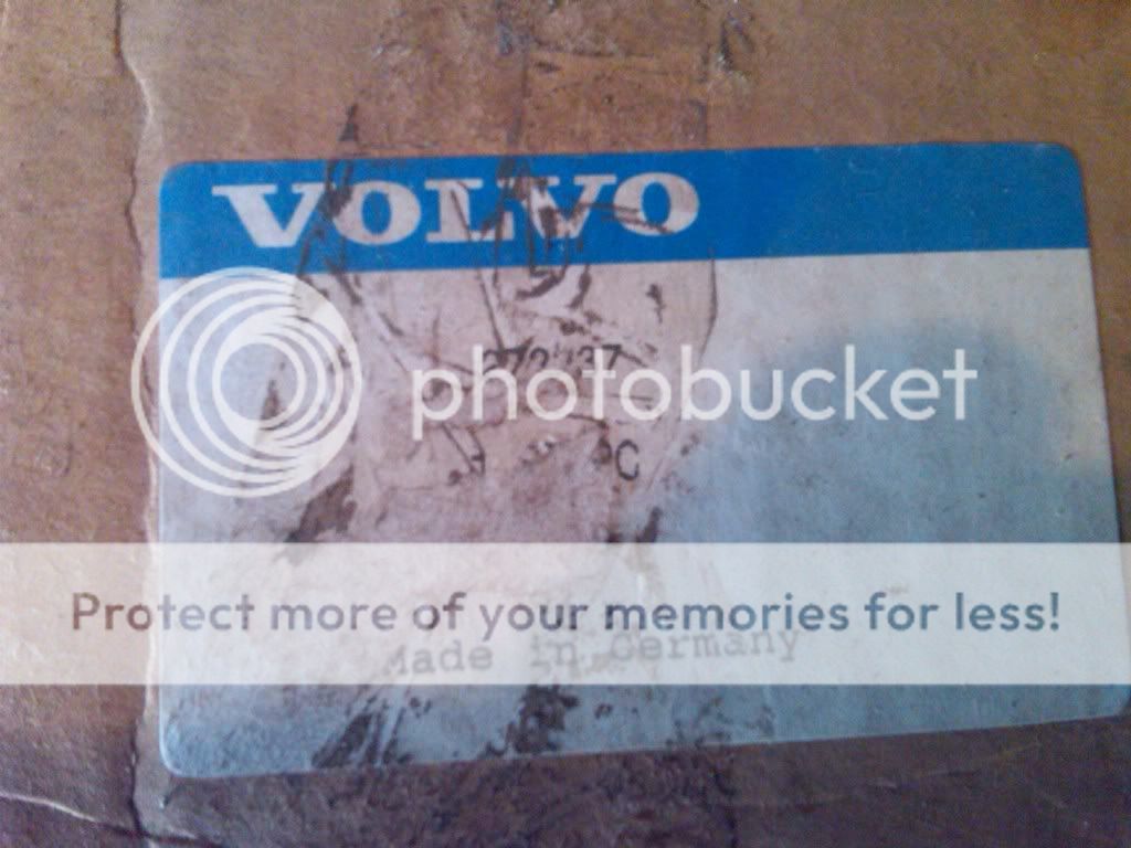

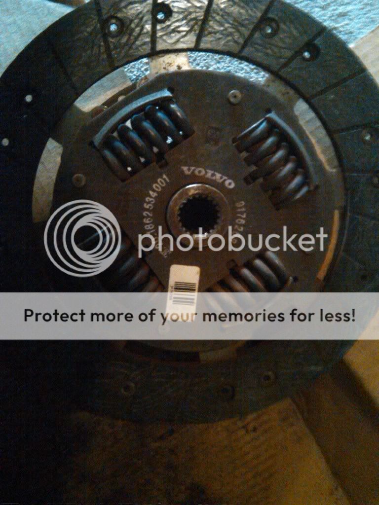

I bought a new R clutch kit / PP and throw-out bearing. It's all sitting in my garage. I'd like to make the noise stop, but since my clutch performs great still I'm having a hard time tearing into this project....
