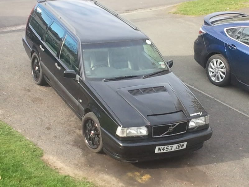

Trying to determine my best course of action after the header install. Underhood/engine bay temps are radically higher. I am going to wrap the header a second time, and try to better wrap the collector, but that's problematic.
I know some just remove the cowl seal & even lift the back of the hood at the hinges. I'm trying to find concrete info on exactly how the engine bay air flow was designed to function; my understanding is that the hood is sealed to force airflow over & then down into the tunnel - so when moving, removing the cowl seal would be a bad thing, no?
I haven't found a universal hood scoop that would work as far as I can tell, I know Falcone slotted his, and 850 Kompressor has a scoop. I'm wondering what is the best path to take here. I'd prefer to build something with an inner run off tray, if I do it at all - I would want it as a year-round solution.
Any thoughts, ideas?

If you're trying to get the heat out of the engine bay, something like this is probably your best bet, disregarding water concerns:
Another option is to bend up a heat shield to cover up your manifold and reflect the heat downward.

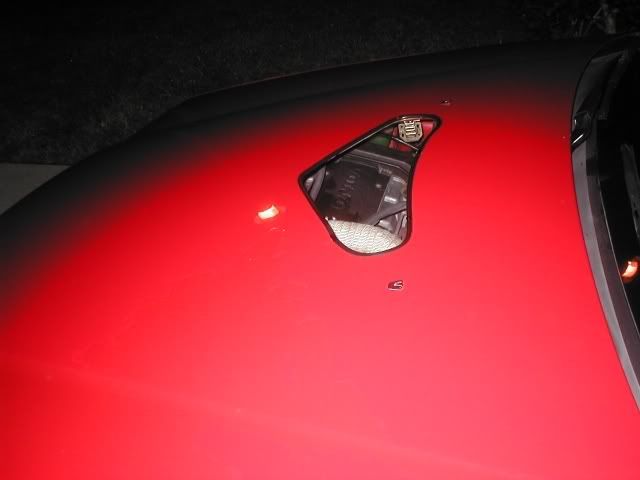

I remember a few different members cut the rear section out above the exhaust mani (the triangle shape that is in between the bracing). I imagine this would be your best bet for an immediate fix
#9 Mesoam
  • 19,833 posts
Posted 01 September 2011 - 03:07 PM
found it
#10 Emiel
Emiel
  • 1,277 posts
Posted 01 September 2011 - 03:48 PM
Florian did the same years ago with good results.
Don't raise the rear of the hood, it will get pretty warm inside with the A/C turned off.
