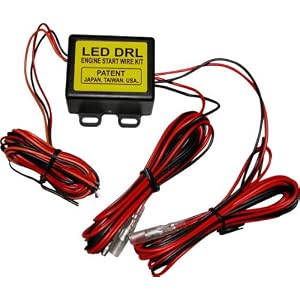

You could try this set up then you can just pick up off your parklight and battery, this device allows the the DRL's to switch off once you activate your park/headlights and reactive when the park/headlights are off.
I connected this type of setup on my Volvo only requires connection to battery for main source and parklights power which the control unit monitors to switch the DRL's off/on.
Does not require any activation of headlight switch once setup.
Only a suggestions you may just want to run your DRL's all the time.
Here is a sample link to one of these devices on Amazon (if this is alright to show).
http://www.amazon.co...d=37M7JDDBS632V
