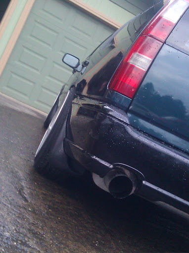

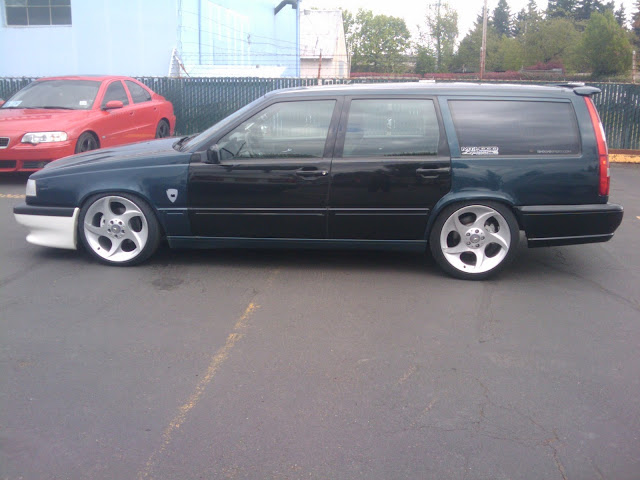

#5 Black Betty
Black Betty
  • 7,000 posts
Posted 10 February 2012 - 02:10 AM
yup et 36 IIRC
205/40 so the small tire helps. If I could have found a 225/40 i would have done that but I didn't want a larger tire OD than stock. I'm still waiting on some suspension bits for the front but after they come in I plan to roll/trim the fenders
edit no spacers in that pic either.
#6 Oreo931
  • 24,519 posts
Posted 10 February 2012 - 02:23 AM
Awesome dude! Can you post some pics of the rear close up and from a few different angles? What rear suspension are you running?

#8 andyb5
  • 3,198 posts
Posted 10 February 2012 - 02:34 AM
Now that I think about it, here's a couple more guys running wide rear wheels on their 850s...
Project_850 has some sweet iForgeds on his 855. Fronts are 215/40s on 18x8 +40, and 225/40s on 18x9.5 +30 in the rear.
rear wheel:
Mdlimy has Mercedes-Benz Alphards on his 855. Fronts are 205/40s on 18x8.5." Rears are 215/40s 18x9.5" +40 w/ 30mm adapters
Rears:
