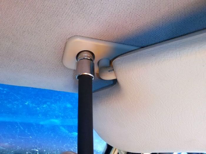

Sun-Visors.
The part circled in Red is the clip to unplug the sun-visors lights. Un-Plug it now or wait until you have unbolted the visors. You'r choice.
Here is where you are going to need your 10mm and either a 8" extension or 2 4" extensions.
No need to break out the ratchet wrench unless you feel the need to and cannot undo the bolts by hand.
Note: There is a different strategy to getting each bolt out... Please note where the visor is in the photos.
And now it should be out.
:ph34r: Ignore the windshield being dirty... windows and doors were open and we've been having 20mph winds all day... so the whole car was dirty after this.
Now that you have your visor out you might be wondering...
How do I remove that little clip? Easy, pry it out like so.
Note: You may find it easier to leave 1 in until you are ready to remove the headliner, makes it nice to not have a headliner fall down on top of you.
