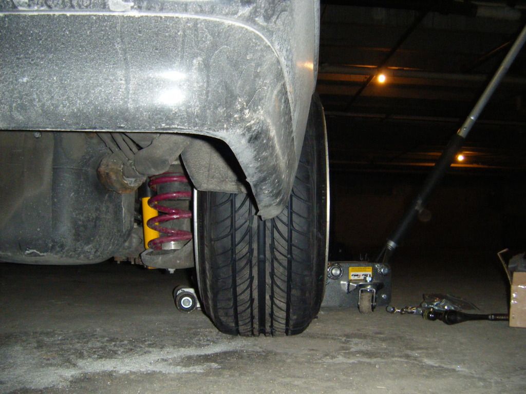

Anyone remove the rear fender liners? The front look relatively simple. Pop out the rivets along the bumper and the fender and then the little plastic nuts on the inside and I'm assuming they come right out. Are the rears the same? Any help would be appreciated. I want to remove all of the fender liners to roll the fenders.

yeah its the same process for the rear.
1 screw on the mudflap
3 rivets where the bumper is
3 plastic bolts in the well itself

Its two layers or metal stitch welded. So is exactly twice as thick. Do not roll rears. Peel back liners, and trim the lip. You can cut off up to 20mm. Then trim the the liner with a razor and rivet it back in.

So just cut off the lip instead of folding it up? Would it be easier to just cut the front fender lips off as well do you think?
Is 20mm the width of the fender lip or is that the width of the lip on the liner? Looking at it, I think it may just be easier to cut them, and then smooth out the edge.

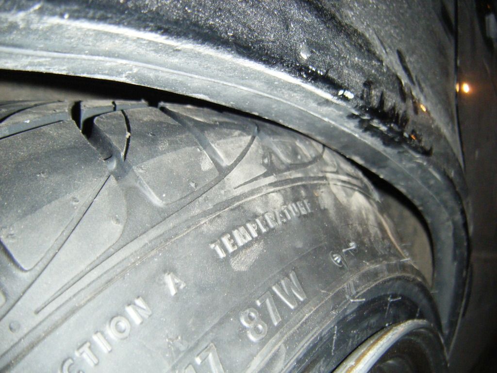

Try 9.5. ;) I think you're missing the point. I wanted to know how to remove the rear liners, so I can roll the lips. I don't care if my fender lips wear through, I'll trim them before that happens, but driving like a nut job for a couple of months isn't going to wear the fender lips down and by that time, I'll have nice awesome grooves in my tires. No thanks.
And yes I plan on keeping them, they're going to stay in the car, I never said I was removing them. :unsure:
I'm not taking the fender liners out right now so I can trim them or delete them, I just want to remove them so I have ample room to work with folding/cutting the lips so they don't rub a groove into my tires.
