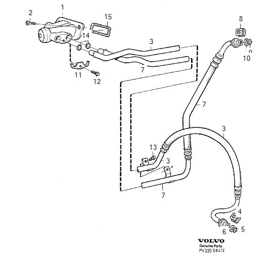

I'm getting a new motor put in my car and I need the oring that goes to the oil cooler line housing at the oil pan, my mechanic said it is a rectangular oring? I have been searching all over and cannot find it. He said he had to take it off and minute he started the car let it warm up for a little it pumped out 5 qts of oil, so its a major leak.

Just did this last weekend. #15 = P/N:1366791

isn't that the one that goes to the cooling thermostat?
nvm your right , my bad, thanks a lottt.
