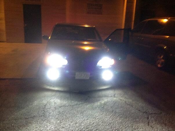

I run 8000k's in my heads and fogs and get compliments on them all the time.. Maybe not as much light outputs as the 5000k's but still significantly brighter than the halogens

Yeah I bet all of the "compliments" you've recieved on your 8000k's came from kids who drive cars like:
I would never go anything over 6000K, because that's a bright white with a SLIGHT hint of blue. 4300 or 5K is where it's at if you're looking for better visibility.

@mattphi.. They usually dont even have cars**
I need to redo the bulbs and get 4300's or 5000's.
I fully admit i went total ricer when i did the 8k's.
Volvo deserves better lol
