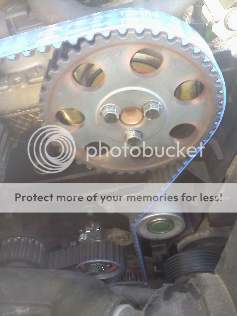

I left the dealership and headed up to my uncle's house to change the timing belt and serpentine belt, which were both about 7 years old, and not in the best of shape. My uncle is a Volvo Master Tech, and walked me through how to do both jobs. Even though I doubt he'll see this thread, I owe him a huge thank you for all his help these past few years.

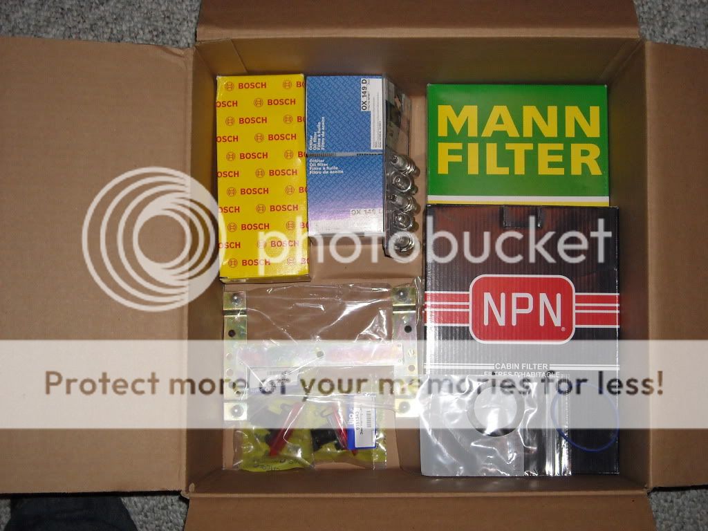

Bought a box of Stage 0 goodies from FCP
Rear license plate bracket, both front door warning lights, fuel filter, oil filters, spark plugs, a filler neck gasket, a cabin filter, and an air filter for the 98 so I could put my K&N panel in the R

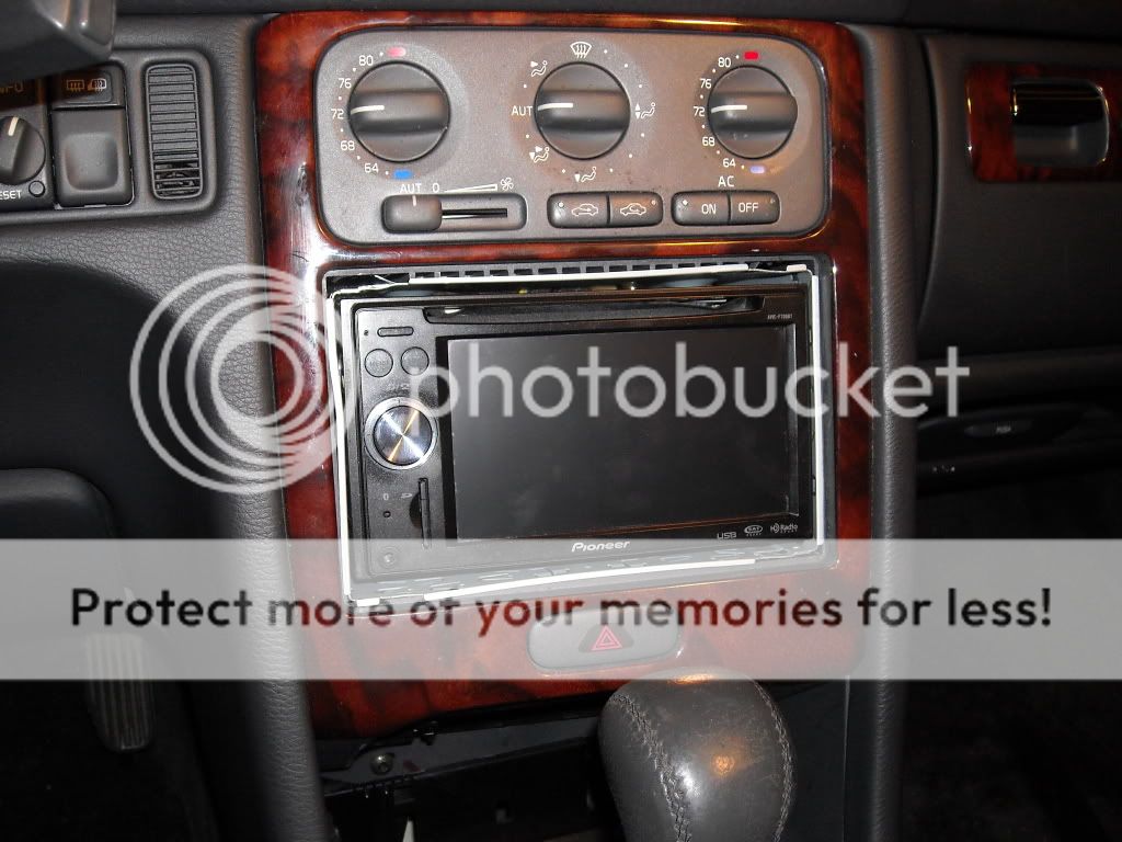

I replaced my SC901 with a Pioneer AVIC-F700BT

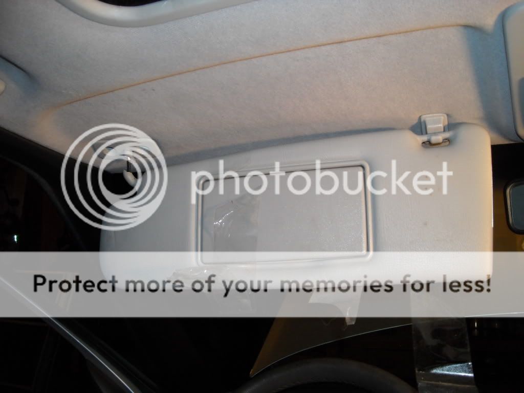

When I bought it, my drivers visor was broken. Total pain in the ass to deal with. That's been replaced, so much better.

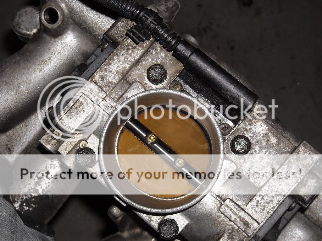

In an attempt to fix a small oil leak, and since it needed to be done anyways, I replaced my PCV system. I dove into removing parts late Friday night, bought parts on Saturday and spent the morning cleaning 12 years of grime out of my engine bay, degreasing the ETM, cleaning the IC piping, etc. Saturday afternoon I installed the new PCV system--hardline around the block and all.
Yeah, that needed replacing :rolleyes:
ETM looks much better after cleaning; and there's no sign of it acting up so far.

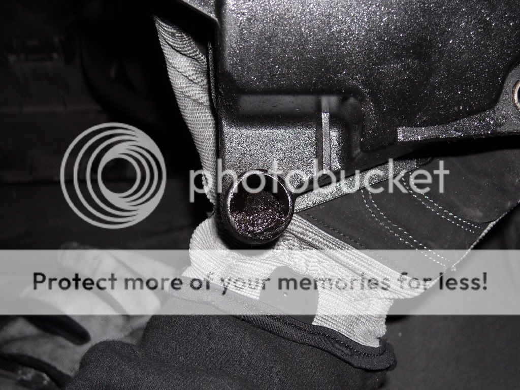

Once I got back to school in January, I went to change the oil, and had some "issues." The filter housing was on so tight that I couldn't break it free. Pissed the fuck off didn't even begin to describe how I was feeling at this point. So I grabbed a drill, punched a nice big hole through it, and jammed a long screwdriver through the housing for more leverage. Lots of swearing later, it finally came off. I got a ride to the dealership and bought a new filter housing.
Unfortunately, the car started leaking lots of oil after that. I was not happy, and basically let it sit for a couple weeks, leaking more oil than the BP's Deepwater Horizon. D S50R was nice enough to lend a hand and fix my car. It turns out I nicked the oil pan with the drill bit, and the scratch was preventing the rubber gasket from fully sealing against the oil pan. This caused massive (2+ quarts a week) oil leak! He used some JB Weld to fill the scratch, and it's still good till this day. He was even nice enough to sell me an IPD front sway bar :D Thanks again man!
