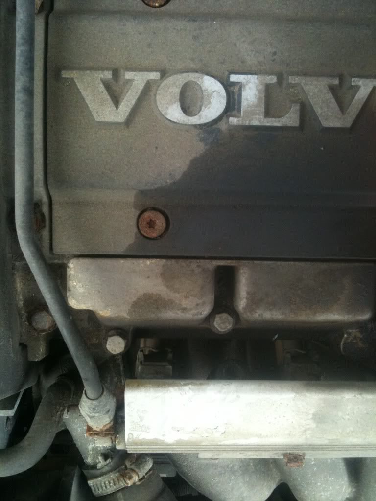

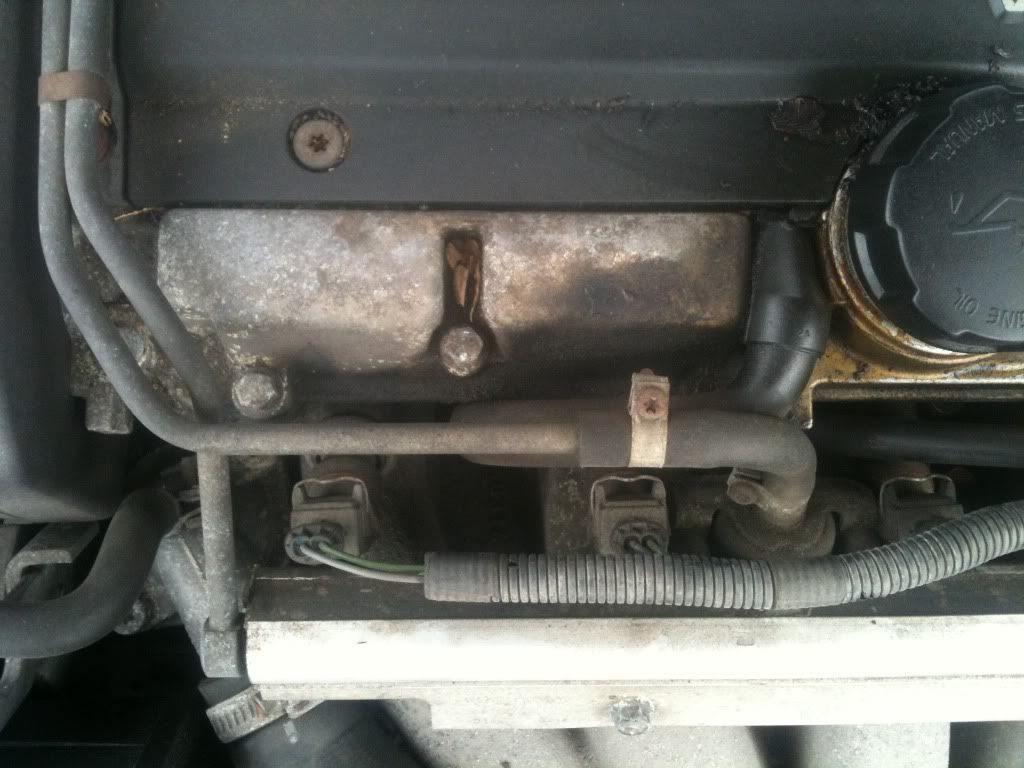

here's a pic of the turbo 850 fuel rail setup VS the NA setup.
NA
Turbo

Does the rail set-up matter much though? as long as the fuel pressure regulator is working then location should not matter? Just as long as you are getting the correct pressure at the rail...
The ONLY item I would be concerned with is the harness leading into the vehicle. Are they the same from older N/A style to Turbos?

on NA-games swap he ran into big problems because the system was setup to operate under vacuum only. My understanding is that without the turb setup you will get misfires and your car will run like garbage. Someone correct me if I'm wrong but you need a return line that's for sure.
