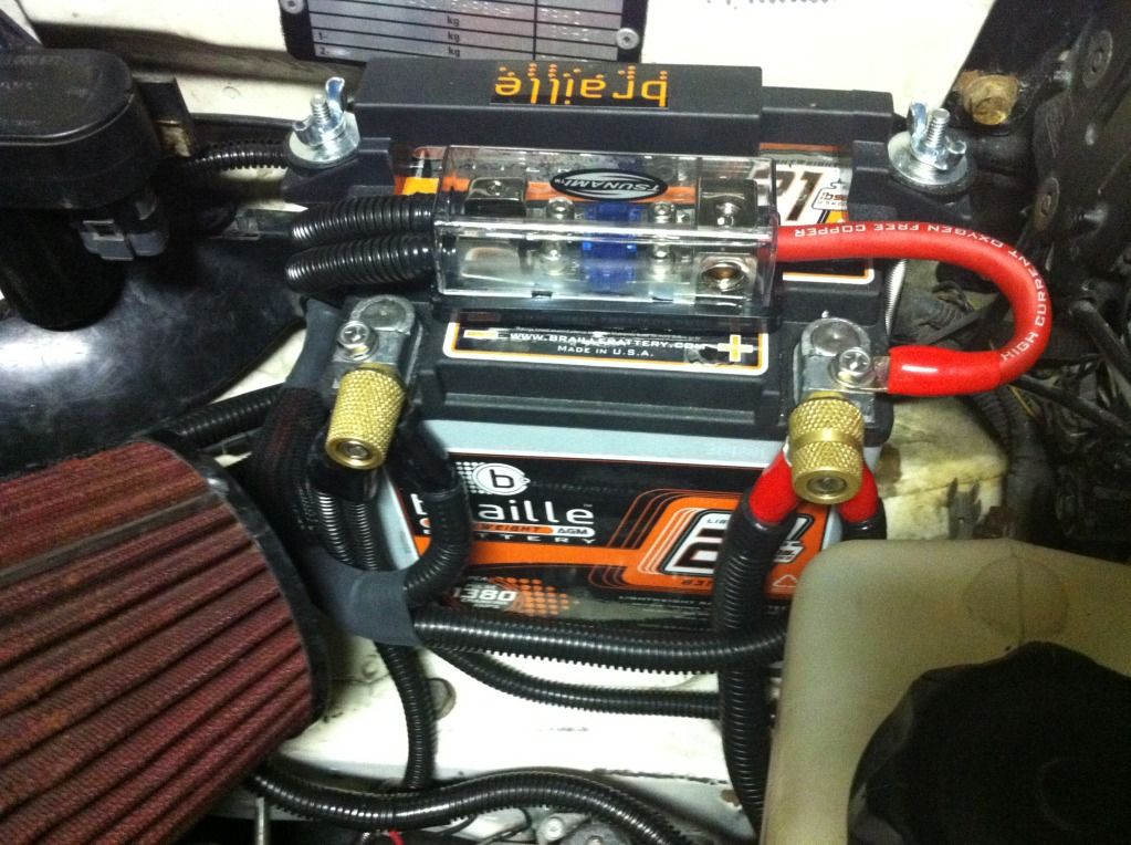

I'm reachin' here, but - Bad battery connections?
If they were a little grungy and you cooked'em with a short, they may have
gotten bad enough to drop out briefly like you described. Getting a little worse
every time fits the bill. If it's as marginal as you said, the starter might not turn over
even if you did try to crank it. That poor a connection probably won't handle the current.
Just for grins - Pull, inspect, clean and reconnect both battery posts.

It's definitely not the battery terminals...
