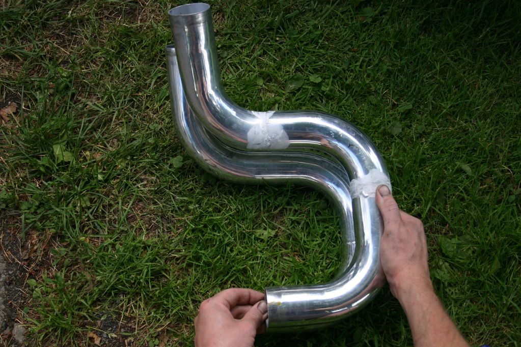

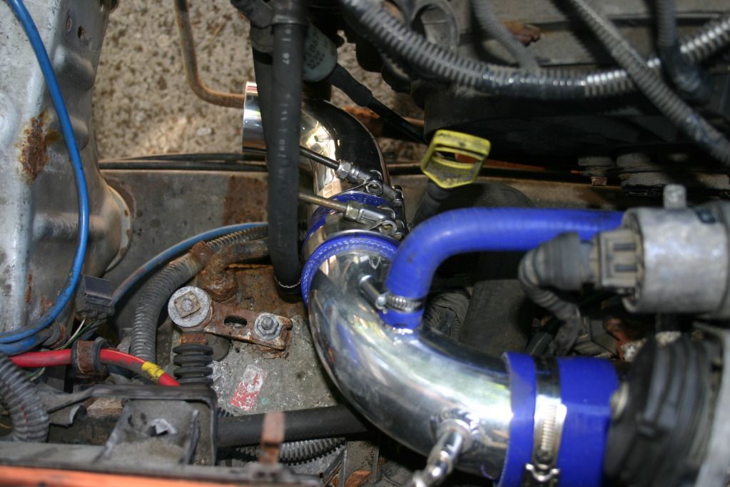

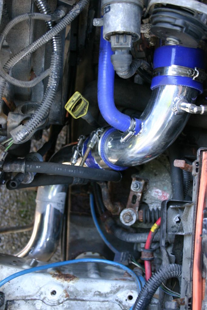

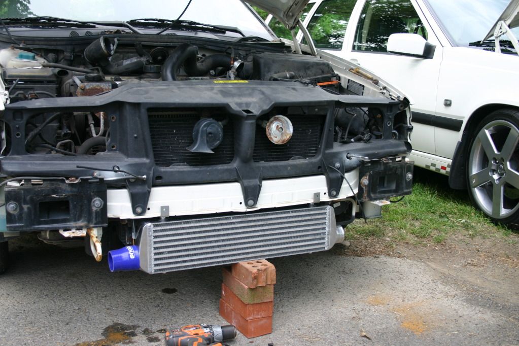

Cold side revision done/ mocked up on a junker auto on loan from my indie. I've sent it out for duplication and I will have the next set of revised front mount kits in about 2 months. Don't worry I still have plenty of the first batch left, just saying Aaron and I got on it Monday and made it happen. There were only two things that needed to be changed to make it fit and I was relieved that I didn't have to redo the upper section!
some pics:

ooo and how large is the piping in that section? still 2.25?

this is great! looks like this will be going on my new project car when it gets in! what kind of intercooler are you useing? is there a flow sheet we can see for it? and will there be different colors? like black?

the cold side is 2.25" and the 90 elbow before the throttle body is 2.5 to help with the transition. You want to keep the cooled air dense when it leaves the intercooler and for this size application (upgraded IC while using a TDO4hl turbo) it is sufficient.
mike
Nice what are you planning? It's generic, but it's a good quality tig welded bar and plate. It's rated for up to 500 cfm /350 hp. Pressure drop of .3 psi.

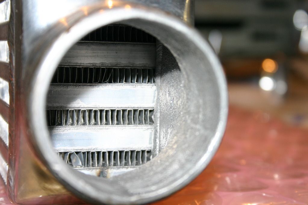

Any chance you can snap a pic of the fins on the inside of the intercooler? (Like looking through the outlet into the edges of the fins)

specs: 15 fins per inch 7 internal 8 external. Internal fins are offset as you would expect.
