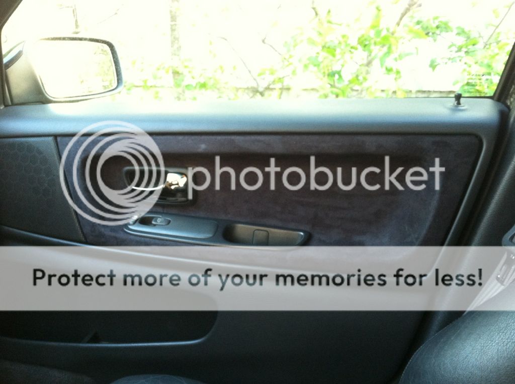

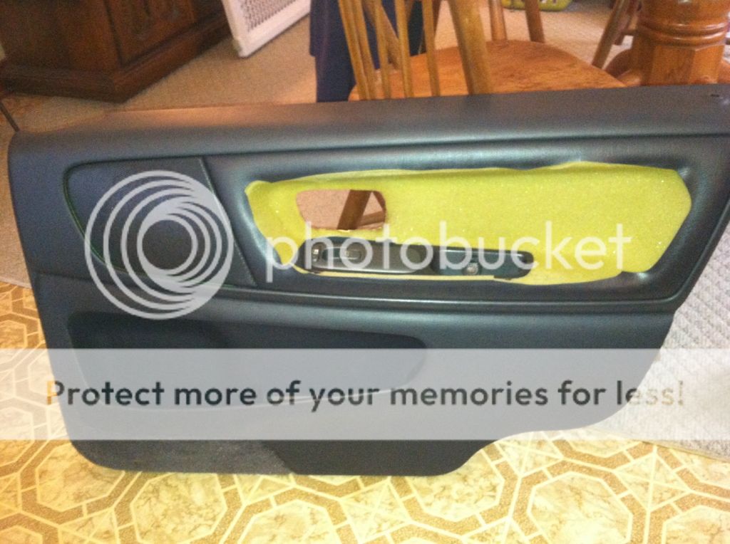

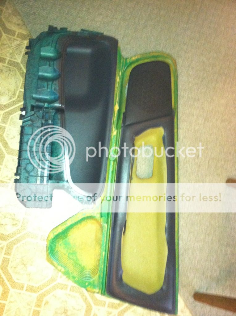

I did mine about a month ago. I went to a Joanne's Fabric store (don't know availability on the locations) and got some of the discount fake suede they had on sale. I was contemplating buying headliner glue, but they had Loctite Heavy 300 glue on sale. Here is a link. We have had plenty of hotter days and since i do not have functioning AC they have seen some intense heat parked in direct sunlight. ::knock on wood:: so far so good... The material had very little stretch but i just laid this out ahead of time, and glued about 6 inch sections at a time and worked it into the shape i wanted. The glue got tacky in about 3 min and it was workable for about 15 or so. Then i baked it in the sun outside for about an hr when i was satisfied with the results. I am not an interior craftsman by any stretch and i admit there are a bunch of things i could have done better. Like not get glue on my hands and then touch the fabric front and get glue on it. But it was a learning curve and have been resolute on getting at least one a month done. By the 4th one I should be a pro! Feel free to comment but I will not stand here and say that it is flawless by any stretch. I am sure one day my OCD will kick in and I will re-do it. Probably when i go to install new co-ax speakers to replace the blown components that are in there now.
http://www.loctiteproducts.com/p/a_cntct_pro/overview/Loctite-Spray-Adhesive-Professional-Performance.htm
Pics in progress
Before
During
After
98 S70 T5M // ARD Green (stock 16T @ 17psi) // EST Intake // EST DP + Exhaust // MSD ignition // EST RIP // IPD HD TCV + CBV

that's not bad at all. Looks good to me..

I am speechless. That looks fantastic. But to clarify, was this a fabric or a pleather. I think a fabric is going to do much better then a pleather. The pleather I used did not form well and left creases everywhere.
