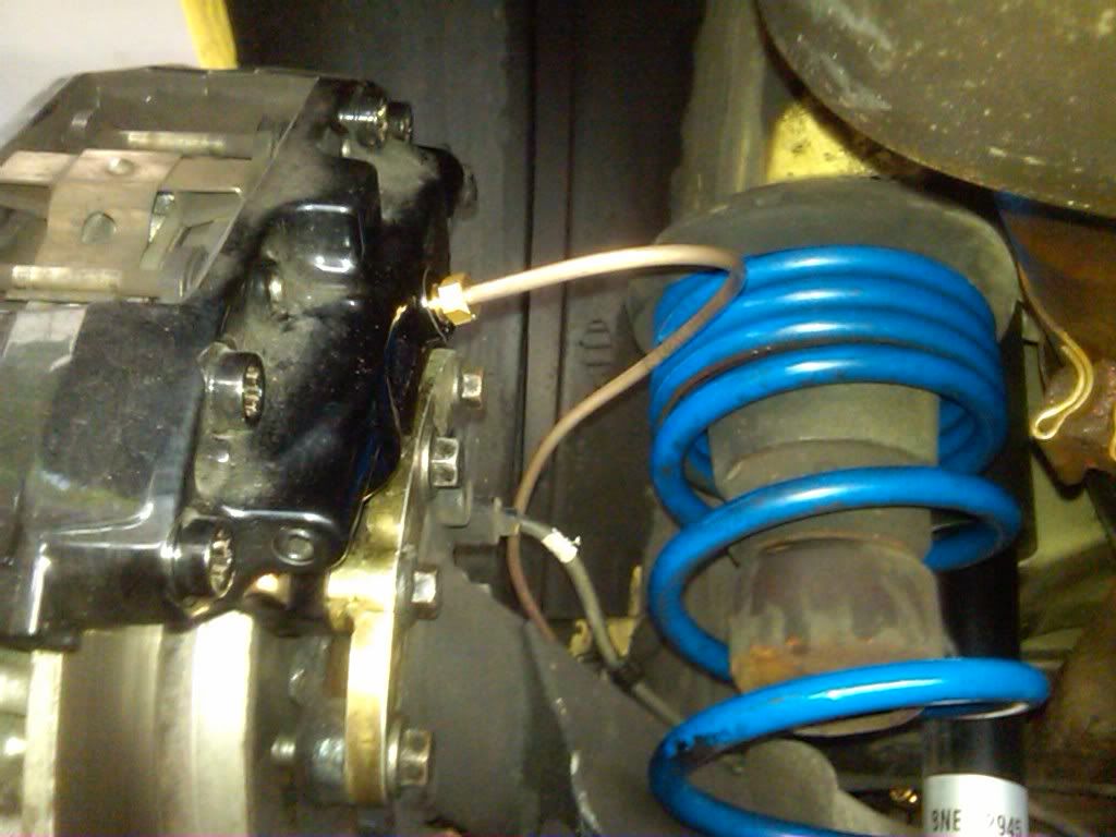

This is the only pic I have from when I replaced my line. Not too helpful, especially b/c you don't have the same brake caliper, but it still gives you a general idea.

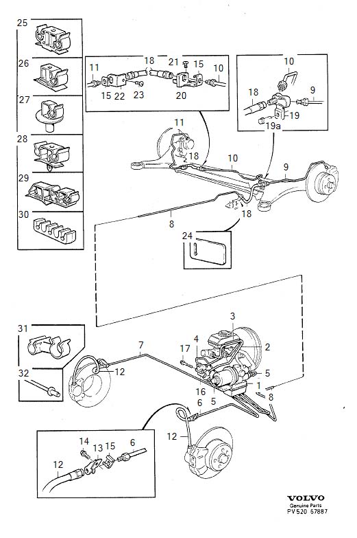

Here's a diagram of the rear brake lines:

Thanks for the pic. part #18 is the flex line, I gather, so that really is a short run, and I can simply take the old line off at the junction of the flex line. Much easier than I thought...
