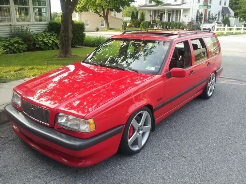

Whoo Hah !!!
Good work - looks just like mine
