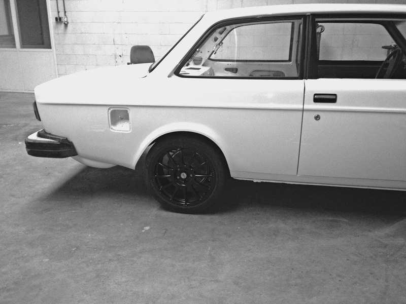

Put the lowering springs on the car and put the engine in,
The results of the springs are a bit disappointing but there isn't much in the car yet. Hope it will lower some more. Installing the engine also didn't change the front stance that much.

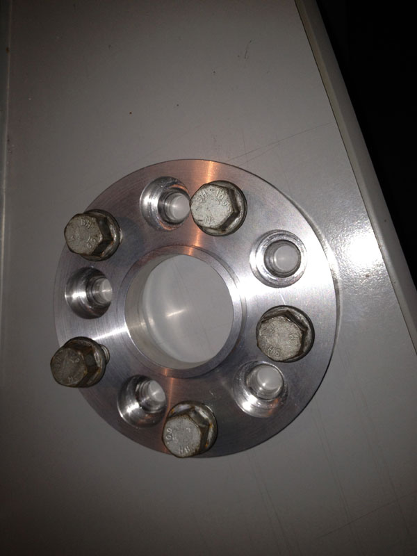

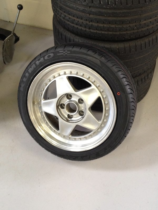

Made a 25 mm spacer to test fit a TDR/Kumho wheel as used on SDM,
Issue with the TDR rims is that they are flat on the mounting surface between the bolt holes while the studs are a little longer than spacer thickness so effectively the spacers are more like 27 mm instead of 25.
At least it gives a better idea of the dimensions with this car.

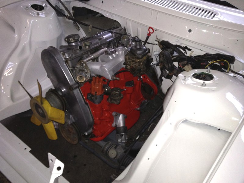

Figured out the wiring in the engine bay and reconnected the headlights and relay. Cleaned and painted the brake booster and master cylinder and put it back in place,
Cleaned and painted some other small items like the radiator brackets and starter motor,
(Still wet paint)

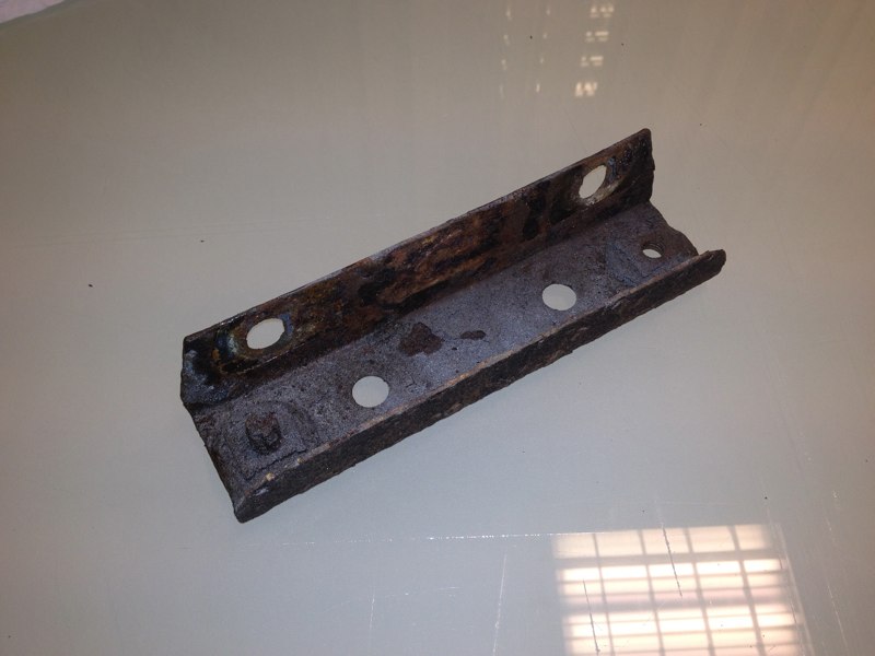

Repaired a mounting bracket used to mount the gas tank,
Had a broken bolt,
Which came out without further damage,

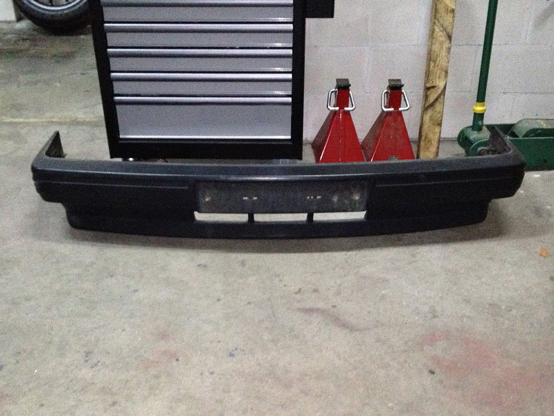

And a new style front bumper,

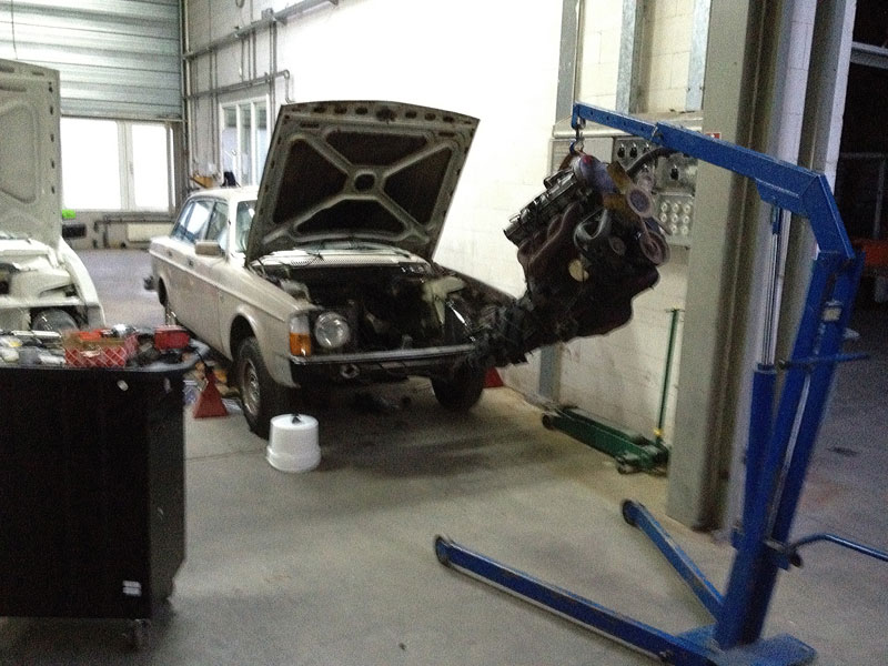

Moved the 244 to the new workshop,
Pulled the engine and gearbox from the car,

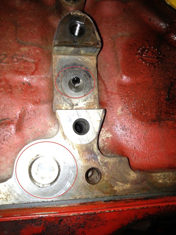

Cleaned the M46,

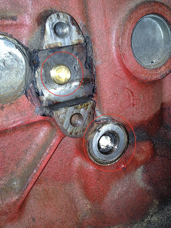

Bolted it to a B234F,
After removing it's balance shafts and plugging the oil feeds,
And put everything in the car,

Why remove the balance shaft? My memory of red blocks is so dim I don't recall what issues arose with the B234F.
I don't know anything about these engine's but the exhaust side balance shaft is in the way if you want to use a motor mount which uses the stock support on the 240 crossmember.

#918 Johann
  • 5,156 posts
Posted 13 April 2012 - 08:37 PM
Did you find a junk Ferrari F40 and took the wheels from it?
No Ferrari, they are Speedline Mistral
#919 Raintracks
Raintracks
  • 957 posts
  • Interests:1521
  • Location:O.C.
Posted 13 April 2012 - 09:50 PM
That's very clean! I love it.
The wheels set up looks great, are they non staggered?
///VST ¤ KW VARIANT II . JAYSONIC™ ¤ BLITZ ¤ LEVOC ¤ EUROSPORT ¤ SPR ¤ RäZO ¤ T.E.L. ¤ XENTECH 6.K.3.
#920 gdizzle
  • 20,459 posts
  • Location:La Plata, MD
Posted 13 April 2012 - 09:52 PM
He said they're 17x8.5 and 17x9 on TB.
