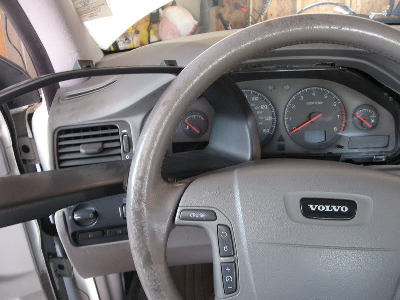

First off, to make this removal easier, pull the steering wheel out as far as it goes, by pulling down on the lever on the bottom left of the column, then pulling back on the steering wheel, then pushing the latch on the column back upward to lock it in place.

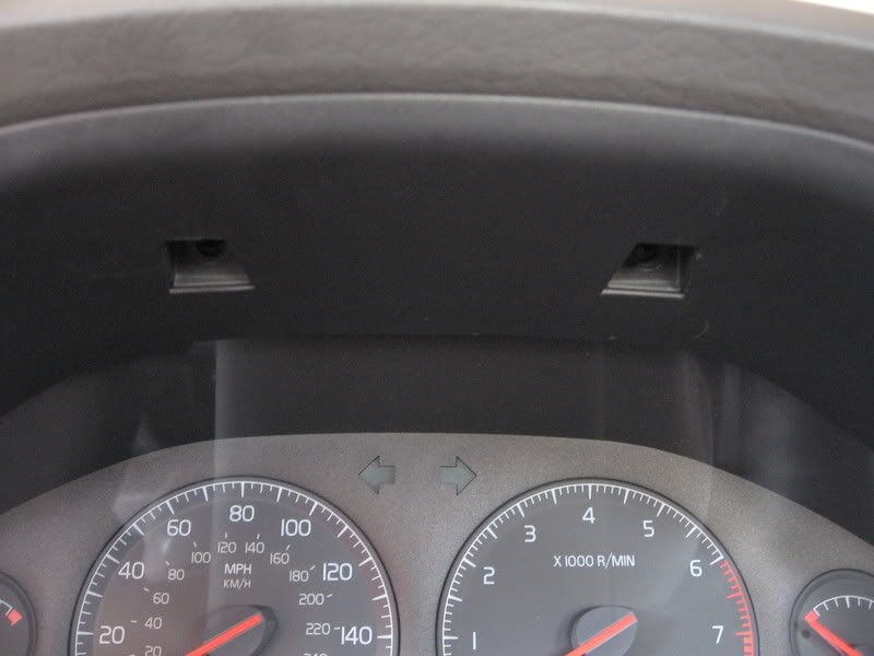

Here we go. Start off by prying out the two small covers that cover the torx screws holding in the trim around the cluster, this can be done by some with fingernails but easiest done with a small flathead screwdriver.

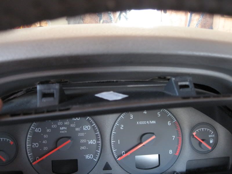

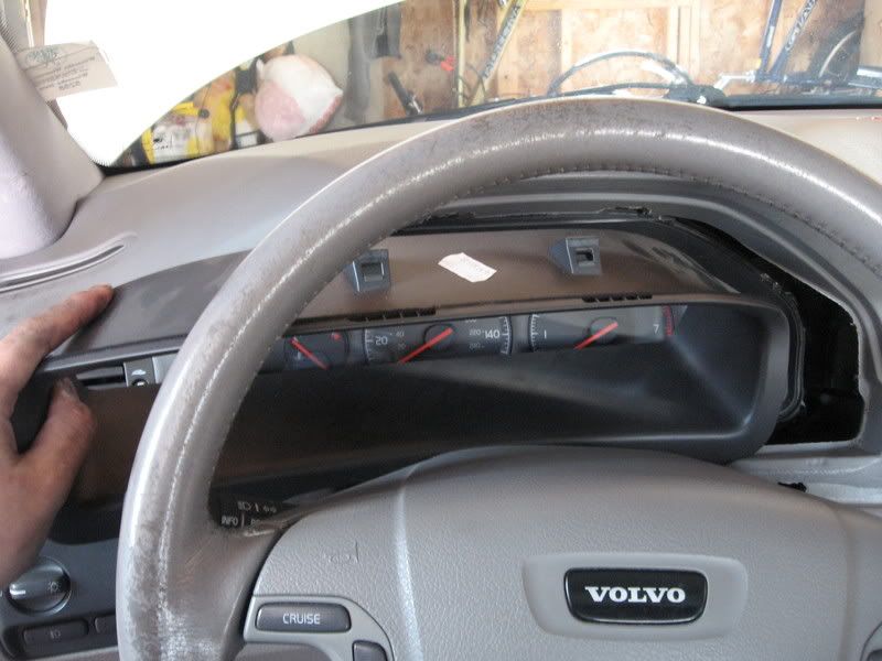

Next, take your finger or the small flat head driver and push downward in the center of the top of the cluster trim. Push downward and pull outward/tip forward. You have to push it down far enough for the spots for the torx bits to "pop" out of the nitche they're in.
Next, pull the trim outward and slide it out to one side behind the steering wheel.

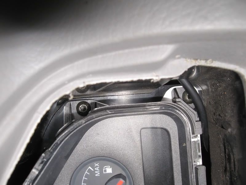

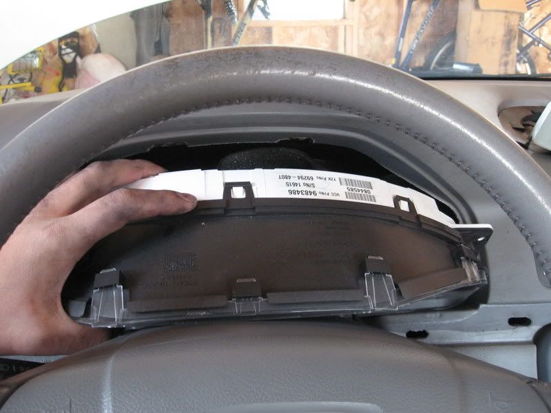

After that, you will now see 4 screws that hold in the instrument cluster. (The Vacuum line that you see in this picture will not be on your car, I have ran mine through there to mount a boost gauge to the center speaker area.)
Once you remove those 4 screws using the tool that I had recommended or anything else you may have found to work for you. The cluster is now almost completely free.

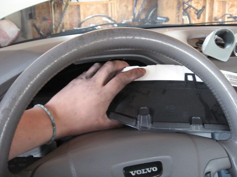

Tip the cluster downward from the top and then pull the cluster outward while it is face down.

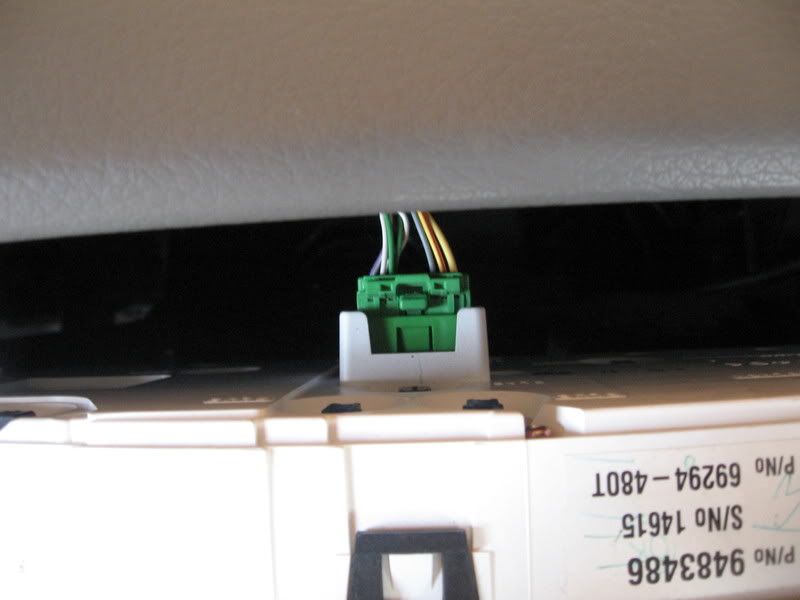

There is one connector on the back of the cluster that will need to be unhooked.

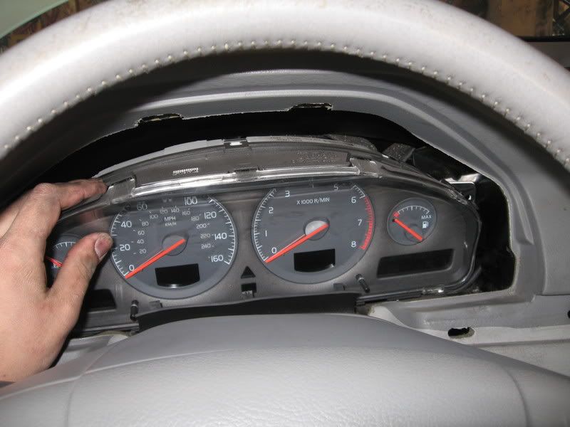

Now you can remove the cluster completely and slide it out behind the steering wheel (you can go in either direction, I just chose to go toward the right.)
Voila! Your cluster is now out of the car, if that is all you needed this tutorial for, you are done, otherwise, sit back, grab a drink and listen up for the next part of this tutorial, Installing LEDs in your instrument cluster.

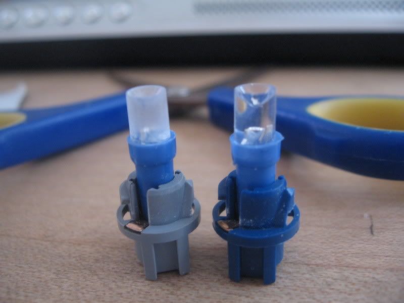

Here are the differnt types of bulbs that you will see attached to the sockets, they simply pull out, they require a little bit of force, using duct tape to wrap around the bulb and pulling on that, works best.

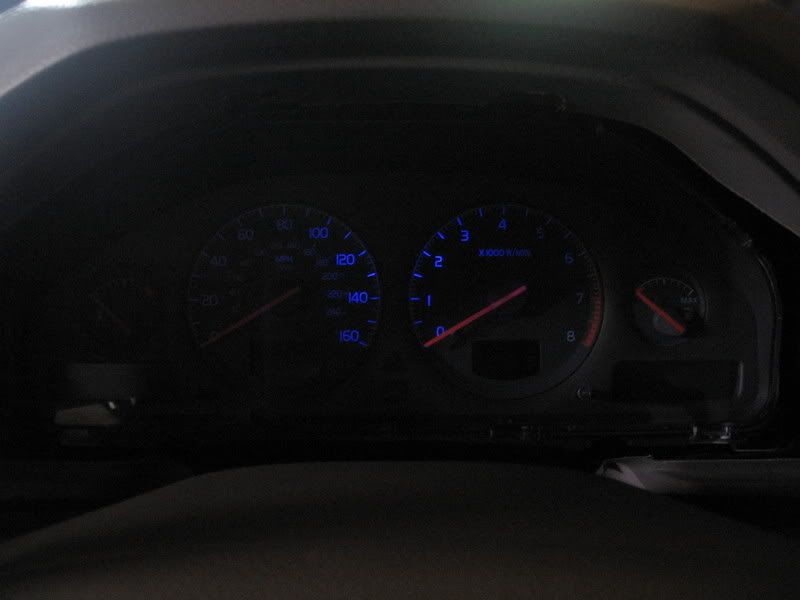

Once you have the bulbs out, you need to decide what colors you want to use for your cluster.
Now, here is the difference between the stock bulb and a T5 wedge Inverted LED bulb that I have chosen to use.
Remove the stock bulbs and put the new ones in their place. Reinstall all of the blue/gray/black bulb holders where they were (take a picture if yours happen to be any different than mine, otherwise you can follow the picture that I posted above if you forgot.)
At this time, to help get the light to disperse more evenly opposed to be directed straight outward, take some high grit sandpaper and sand down the bulb housing. I used 400 grit wetsanding paper and it worked very well. Here is the difference between a sanded bulb on the left and an unsanded one on the right.

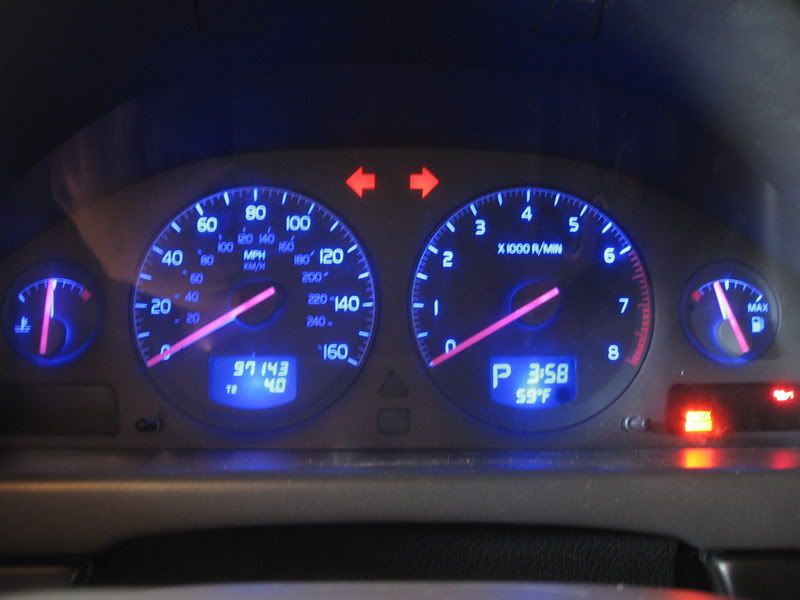

Now reinstall the cluster using the above directions but in reverse, when all is replaced, sit back and look at your new instrument cluster and then go show your boys and be the envy of the block with the only P2 Volvo with a Instrument Cluster LED Swap!
I hope this helps out anyone that may have thought about installing LEDs to change the color of their gauge cluster and to help show how easy it really is!
