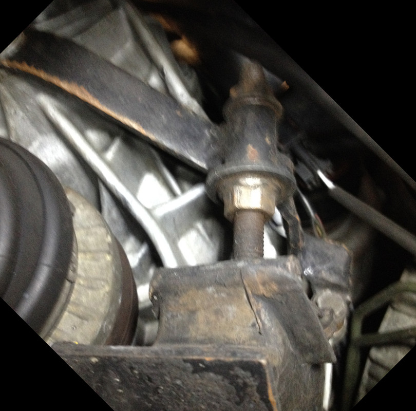

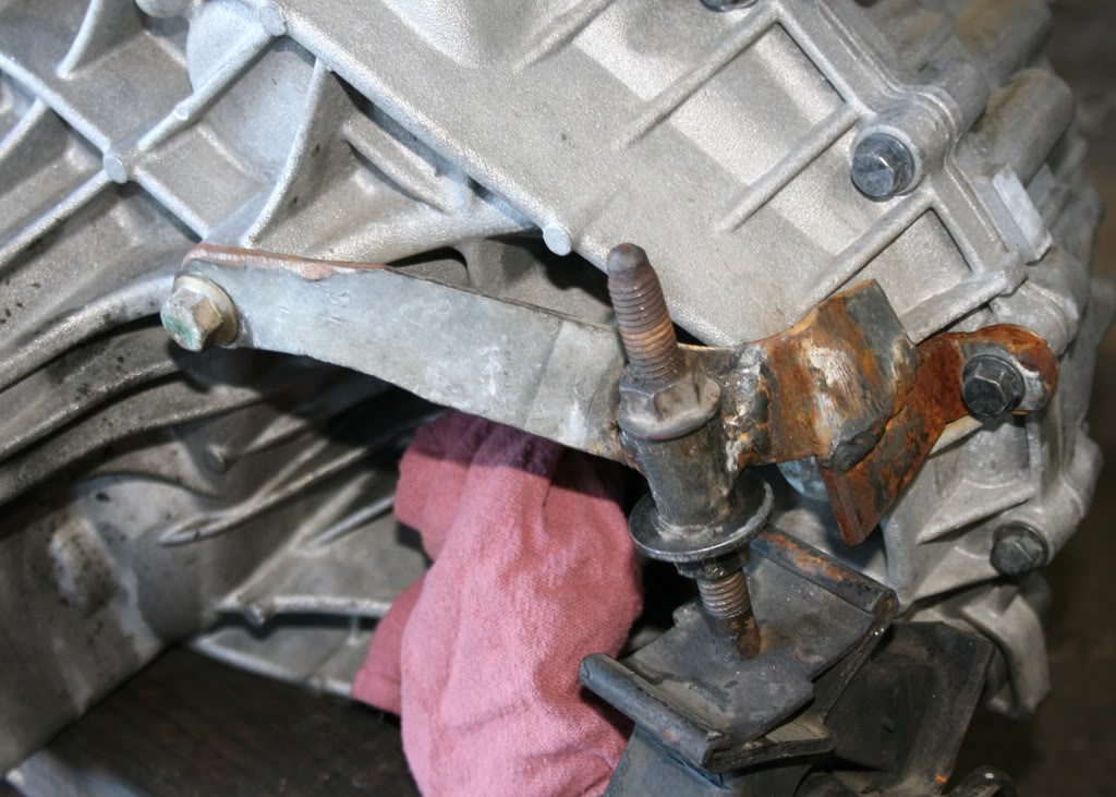

pic of the l/s rear fabricated mount bracket, that allows the use of the existing mount:
First mockup
revised
final design

Note: AWD requires Custom Trans Mount Bracket (use 9161101 rubber mount). Contact me if you want me to make you one

The trans is in - had a few glitches with the shifter cable brackets - one cable popped out last night when I was parking - had to get it back in on the street; and getting the clutch bled. It is a nice setup, pulls very nicely, can't wait to get the proper remap for the manual/16t. At 70 mph, it runs @ 2600 rpm. I haven't had it over 110 yet, I still need the fabricate the left rear mount bracket- the trans is sitting on a rubber block against the frame until I can get back to it tomorrow afternoon.
