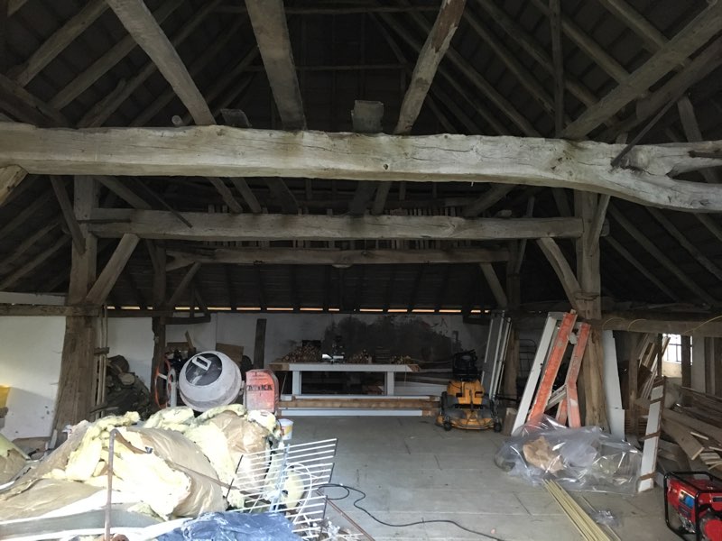

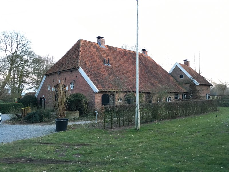

The house itself is a 168 year old farm house.. As pictured we also found a barn on the 4.6 acre property which comes with it. Later this year Area 55 will be history. The new property comes with number 31 so to keep tradition it will be named Area 31..

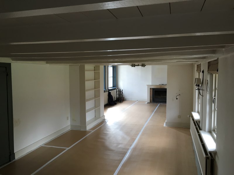

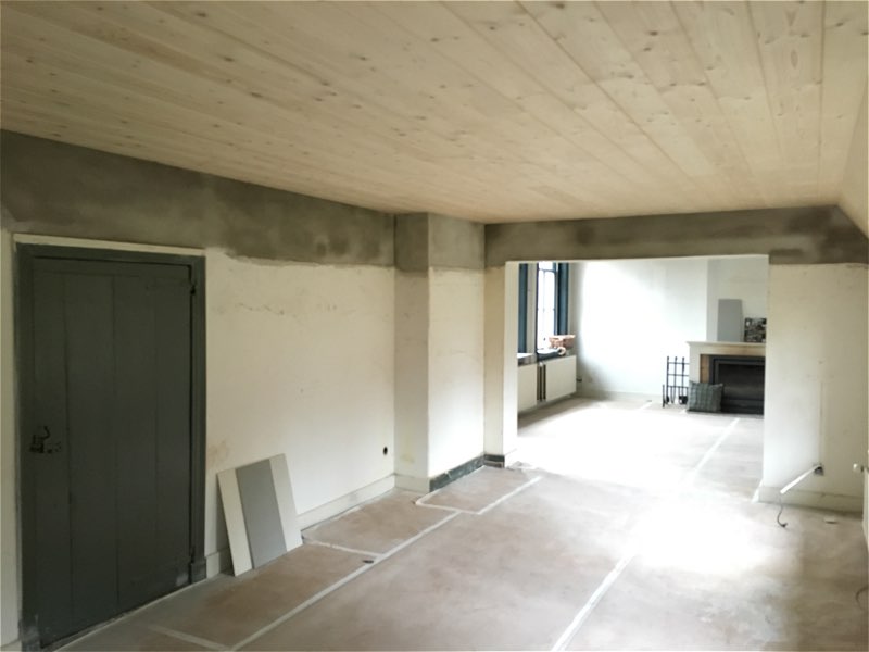

Officially the deal was sealed October last year but the transfer was March 1st this year. Currently rebuilding some parts of the house, other parts will mostly be left in the original style. One small issue was a part of the living room. The free height was only 1.95 mtr.,
The ceiling has been raised by roughly 30 cm.
With my 1.91 mtr. it brings a bit more breathing space. The other part of the living is 3.40 mtr. high. The other part being changed is the bathroom.

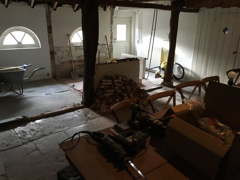

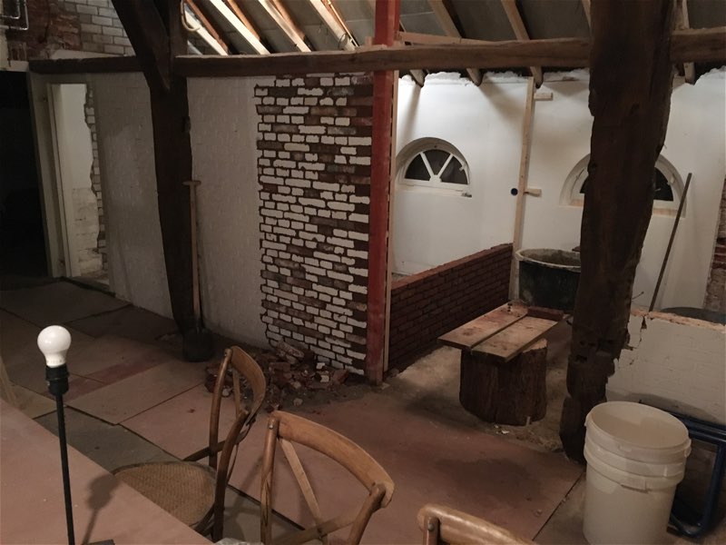

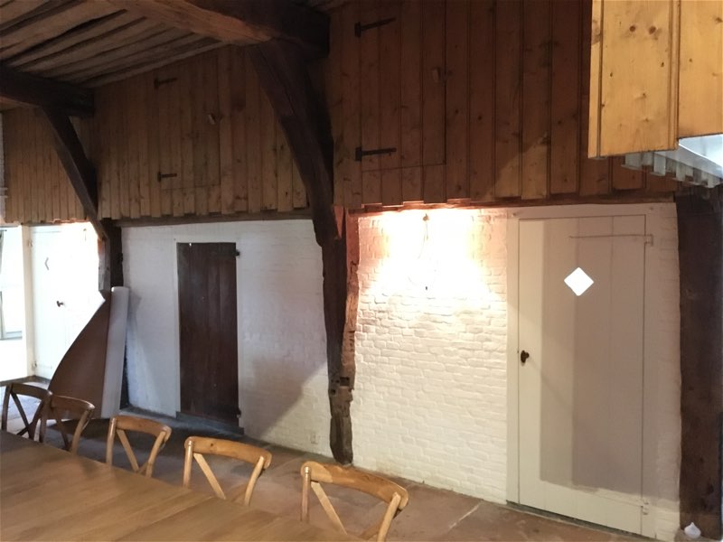

There used to be two small bathroom with a bedroom in-between. The bedroom and one bathroom have been removed and the other bathroom is going to be extended. The house being a traditional Dutch farm house the bathrooms and bedroom were situated in the former stable area. I don't know how it is called in US-English but the center part of the stable is called "de deel" in Dutch.
This part has been converted to living space including an old French fire place. The part where the removed bathroom used to be will become an extension of "de deel" to bring some more light in to the space. De deel didn't have any outside windows so no direct light coming in.
The brickwork is half way done. Had to reuse some old bricks because they had old, now non standard, dimensions. The other wall wil use new type bricks.
An impression of the outside light coming in,

Funny.. Currently rebuilding the new house and ran in to a similar issue..
One part of the living room was only 1.95 mtr. high. We upped the ceiling by 30 cm but there was also a huge support beam in the way. Luckily that spot is 2 mtr. high so "doable"

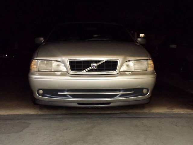

Universal glue will do..
Spoiler is nice. C bumper is ugly. Not your fault but Volvo's ..
Maybe some matte black wrap inside the intake area and surrounding the fog lights would make it better.

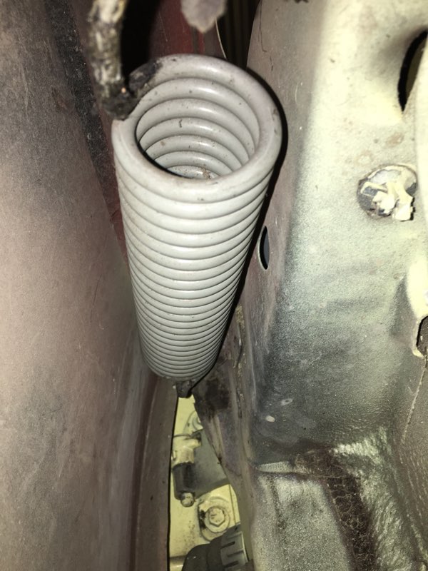

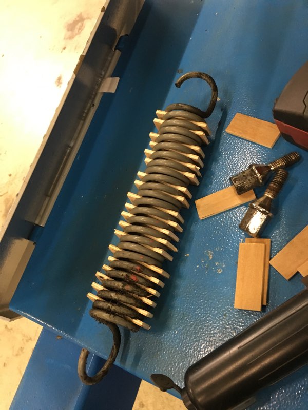

Had to install hood springs but didn't want to remove the fenders.. Searched the web and viewed Robert Spinner's video about removing/replacing hood springs...
Made spring long enough to fit. Installed both sides and closed the hood.. Heard the wood pieces falling out of the spring and done! .

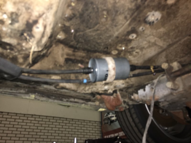

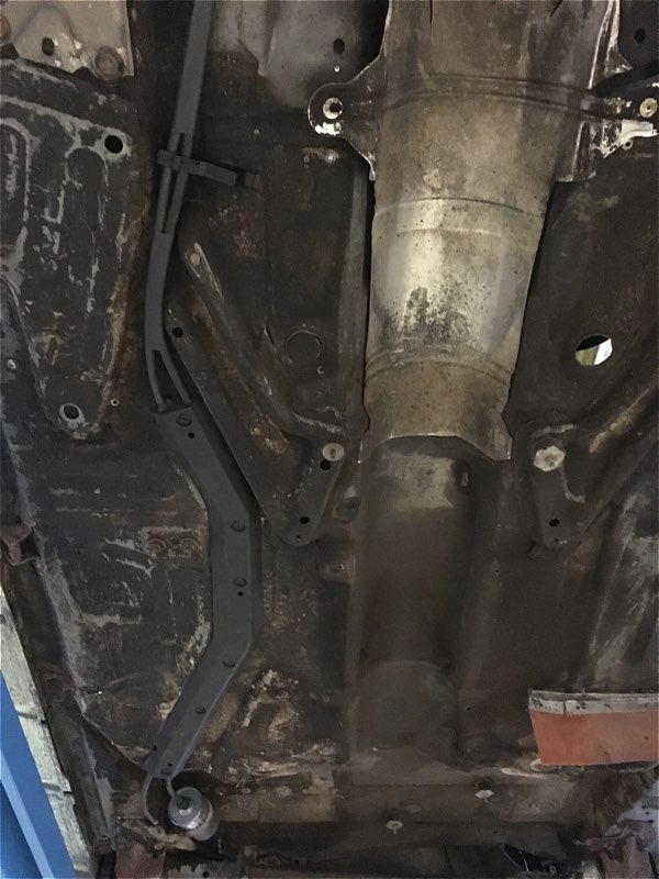

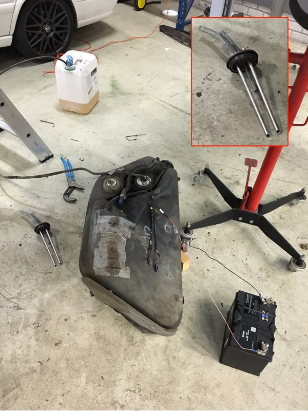

Received some parts for the fuel system overhaul. Also bought a used pump unit from the scrap yard.
Removed the tank from the car including ~45 ltr of fuel. Once out I removed the pump unit but no pump was in there. Obvious because no wires were coming out of it. Exchanged the unit with the one from the yard and emptied the tank while testing the pump while at it.
To mount the new fuel lines I ordered the plastic "line holder cover" or whatever it is called new from Volvo because I couldn't find used parts except damaged ones. A bit of a puzzle because of the battered underside of the car. Also all the threaded mounting studs were missing. Drilled holes and sourced screws which resembled the mounting studs.
And of course a filter,

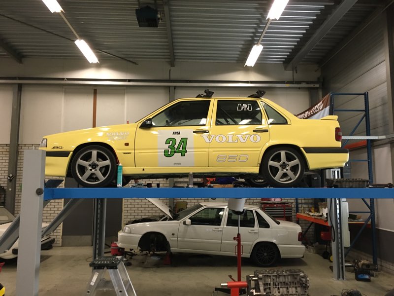

After four months time to do some work on the ex rally project again..

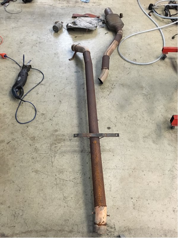

Car needs a fuel system overhaul. What is in the car is a big mess. Ordered new fuel lines and filter. Need to find a way to attach the lines under the car again. Underside of the car took a lot of beating and is slightly out of shape. Also remove the drain pipe called exhaust,
