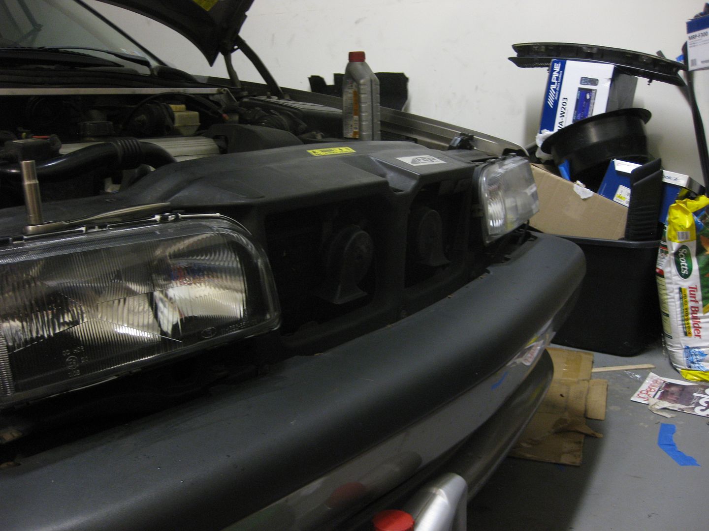

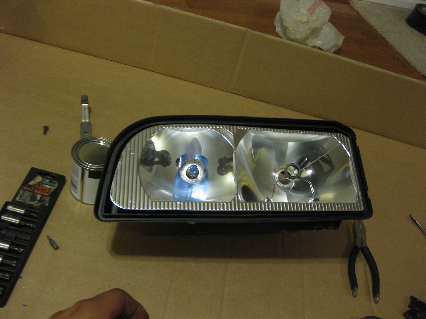

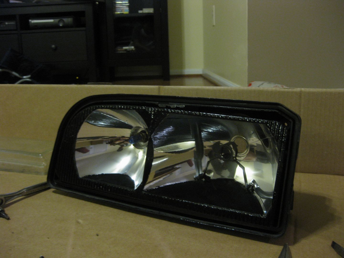

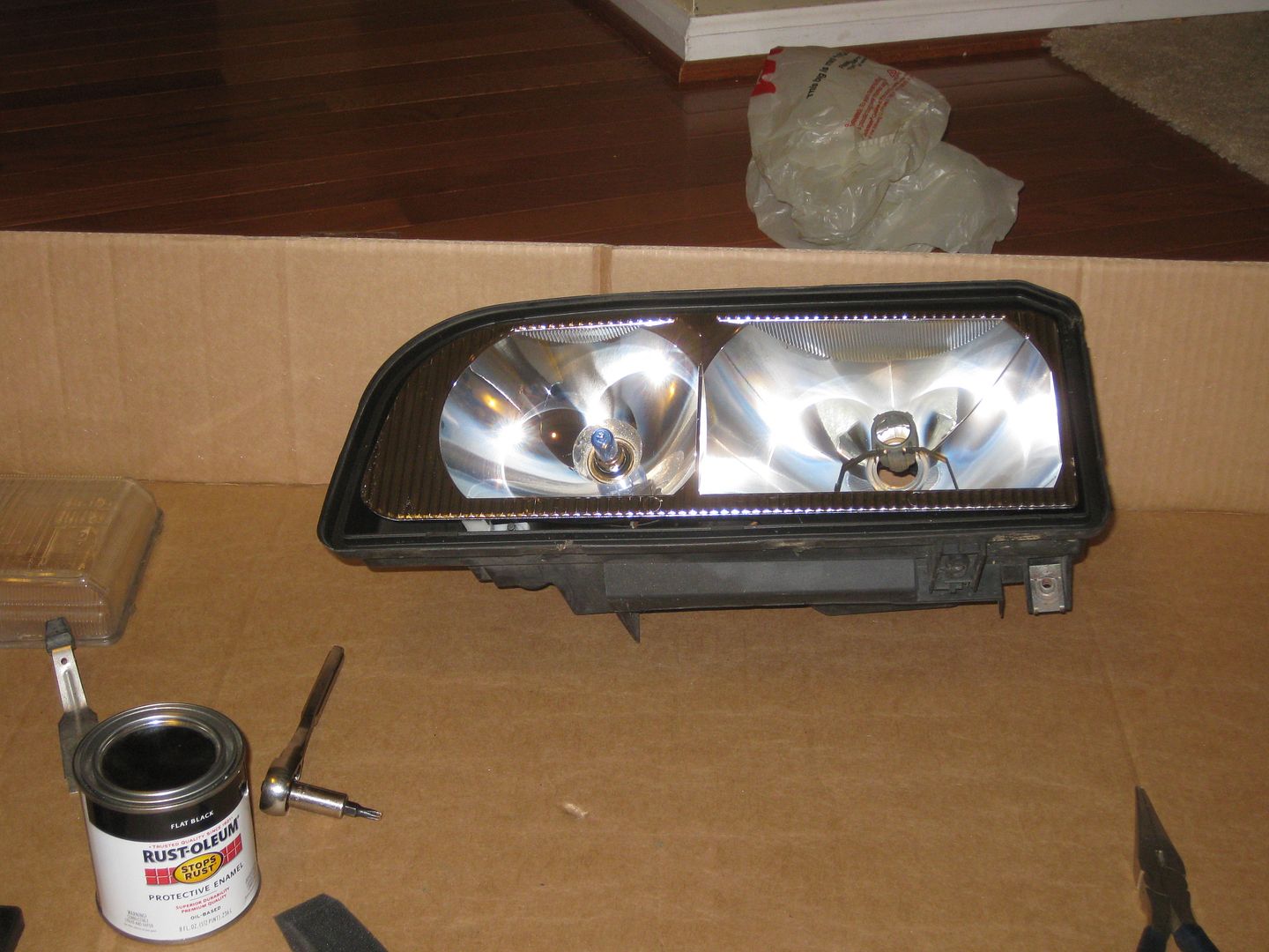

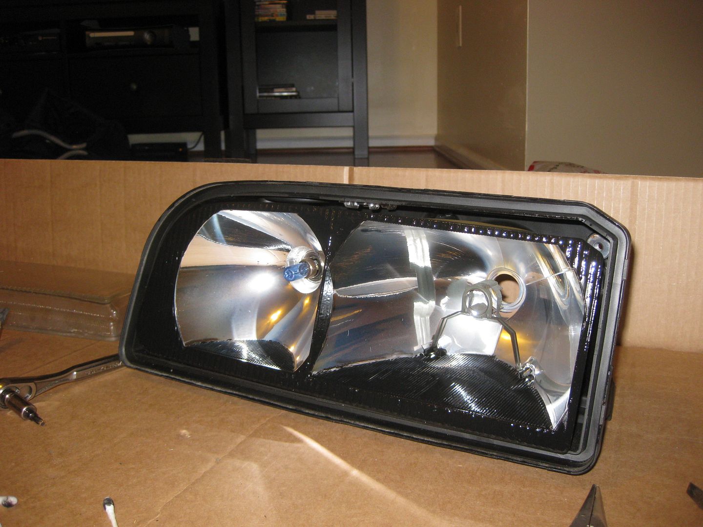

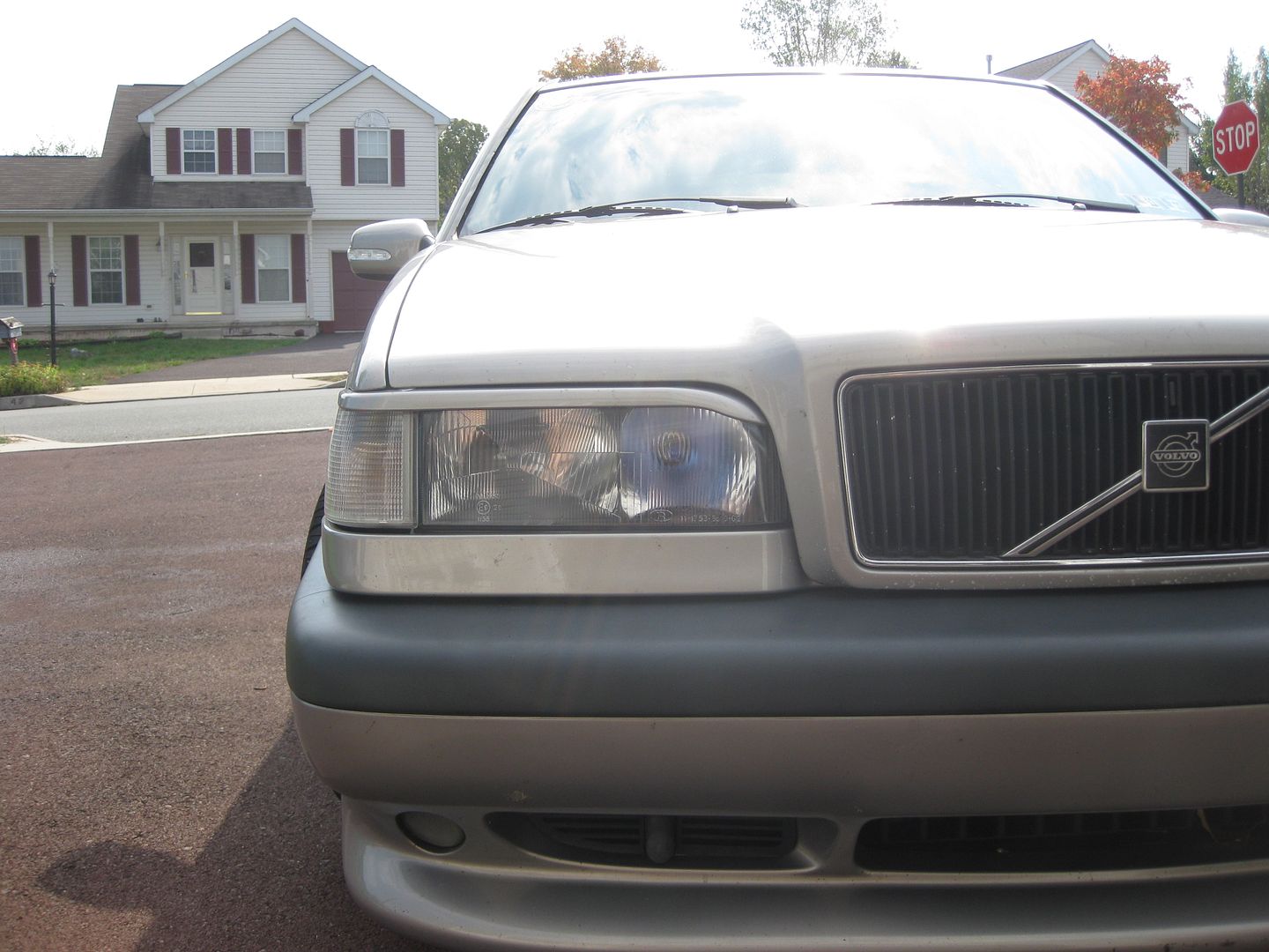

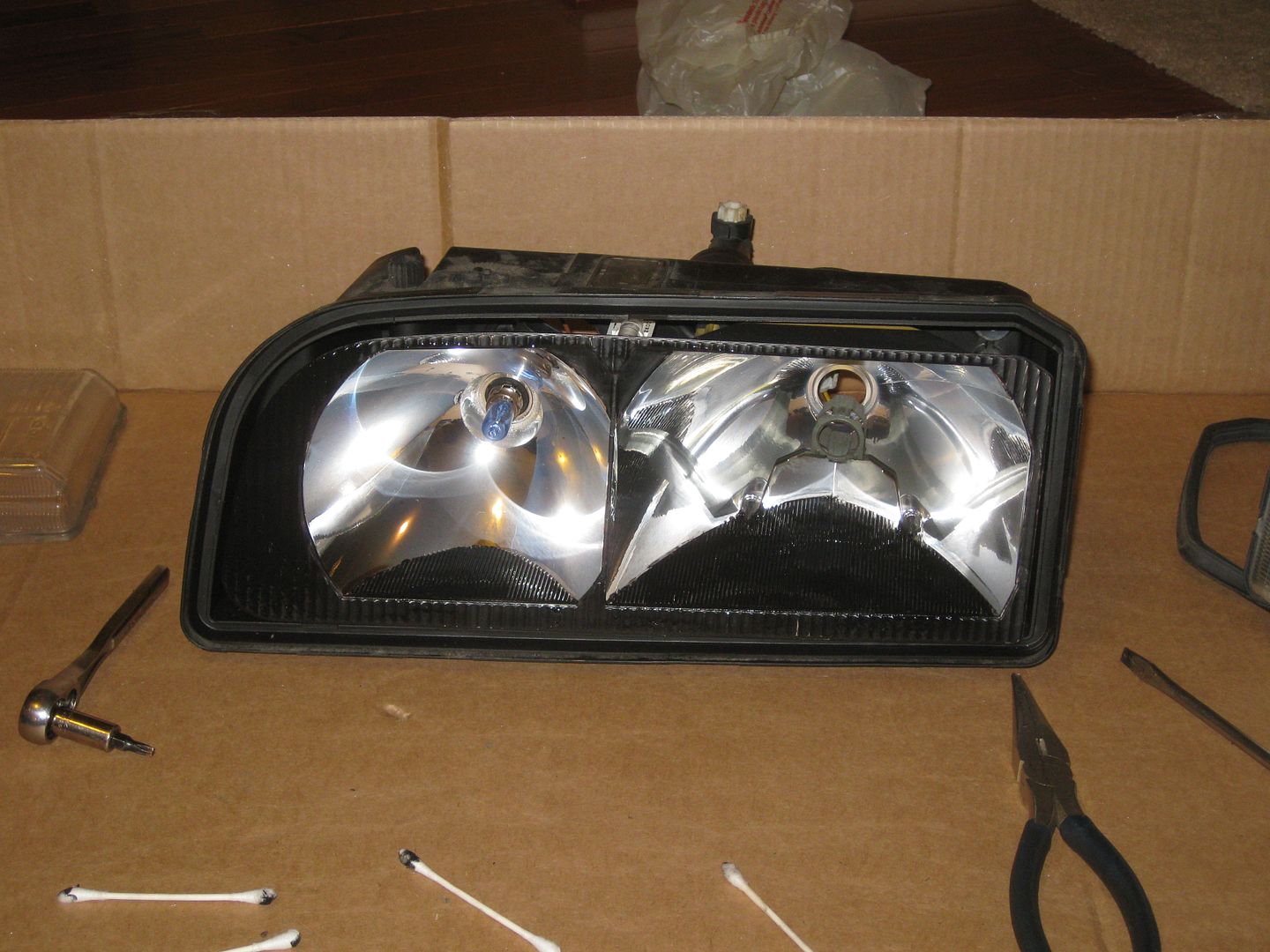

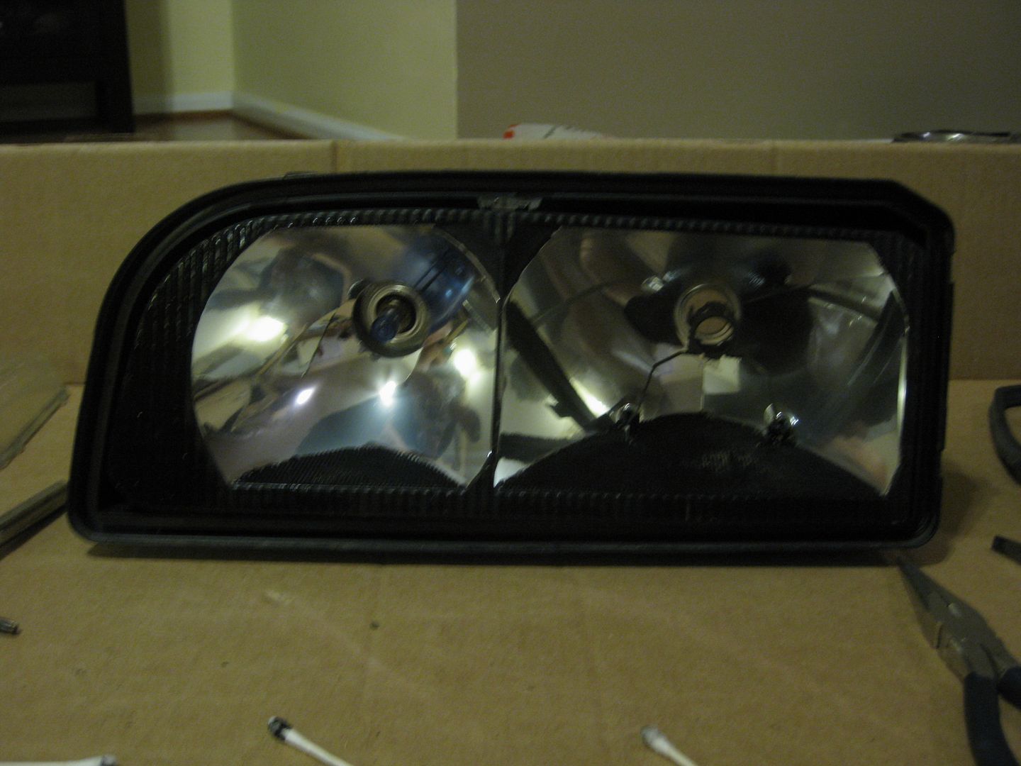

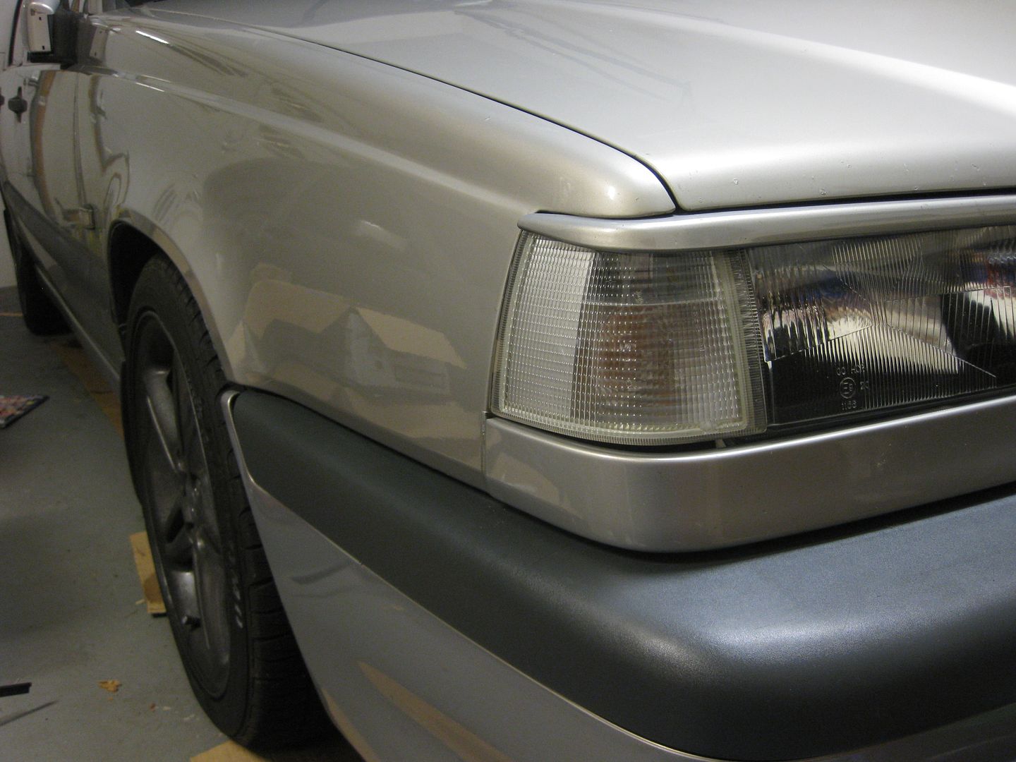

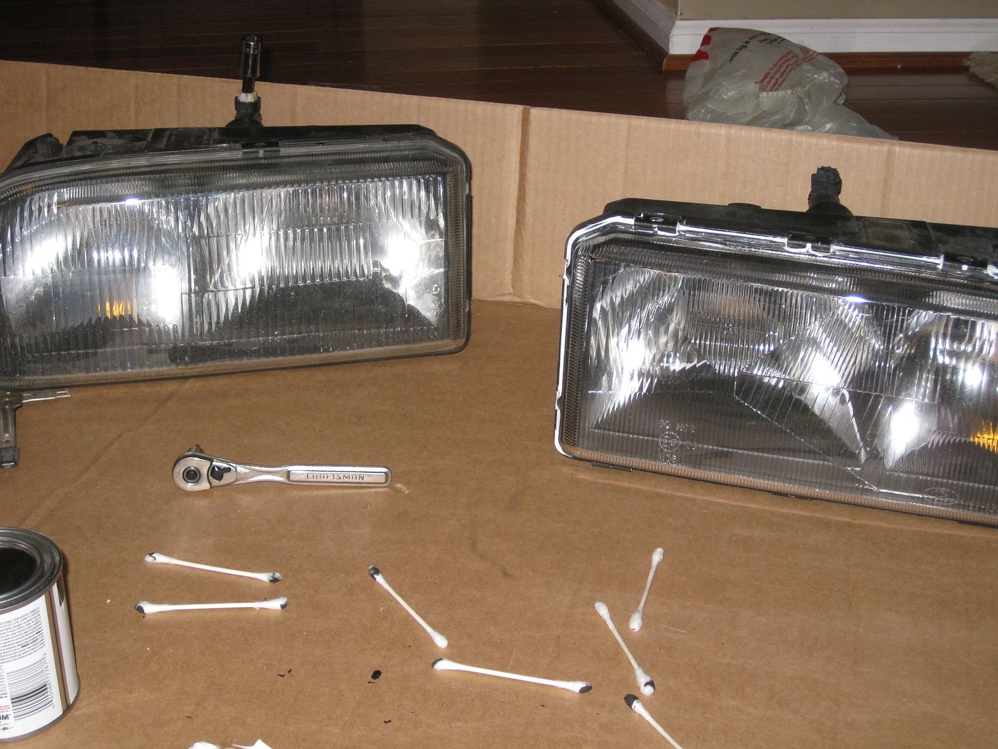

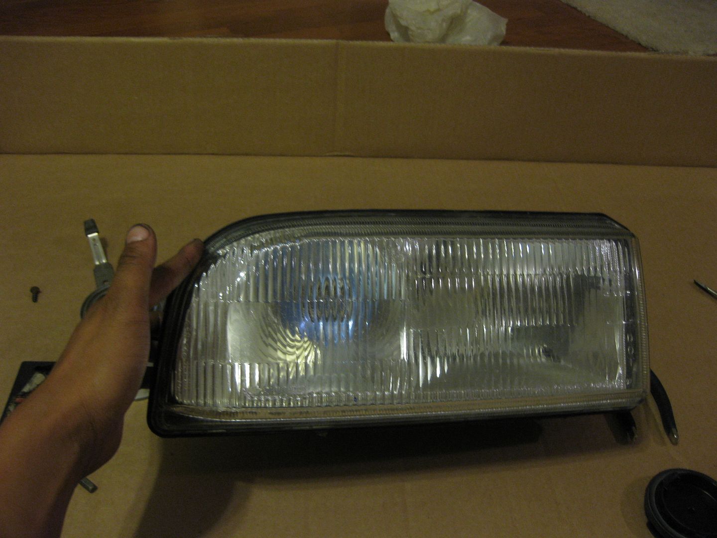

Jippi 855 GLT Posted October 12, 2010 Report Share Posted October 12, 2010 thanks to mattphi's write up i blacked out my extra headlights.. before: headlight: 1. pop off all the black clips around the light: 2. clean parts of the reflector you are painting with rubbing alcohol 3. using small brush and q tips paint the desired parts 4. reinstall lense. headlights with us spec lenses left light had us lense right one has ecode 5. reinstall and done installed one side with ecode: i will take better pics later.. Link to comment Share on other sites More sharing options...
slithereyes850 Posted October 12, 2010 Report Share Posted October 12, 2010 Looks nice man! I'm hoping to do this to my S70....if I can find some time lol also, when taking apart the lens it's only held together with those clips or was there glue you had to remove as well??? Link to comment Share on other sites More sharing options...
T5power Posted October 12, 2010 Report Share Posted October 12, 2010 Looks nice man! I'm hoping to do this to my S70....if I can find some time lol also, when taking apart the lens it's only held together with those clips or was there glue you had to remove as well??? just clips ;) Link to comment Share on other sites More sharing options...

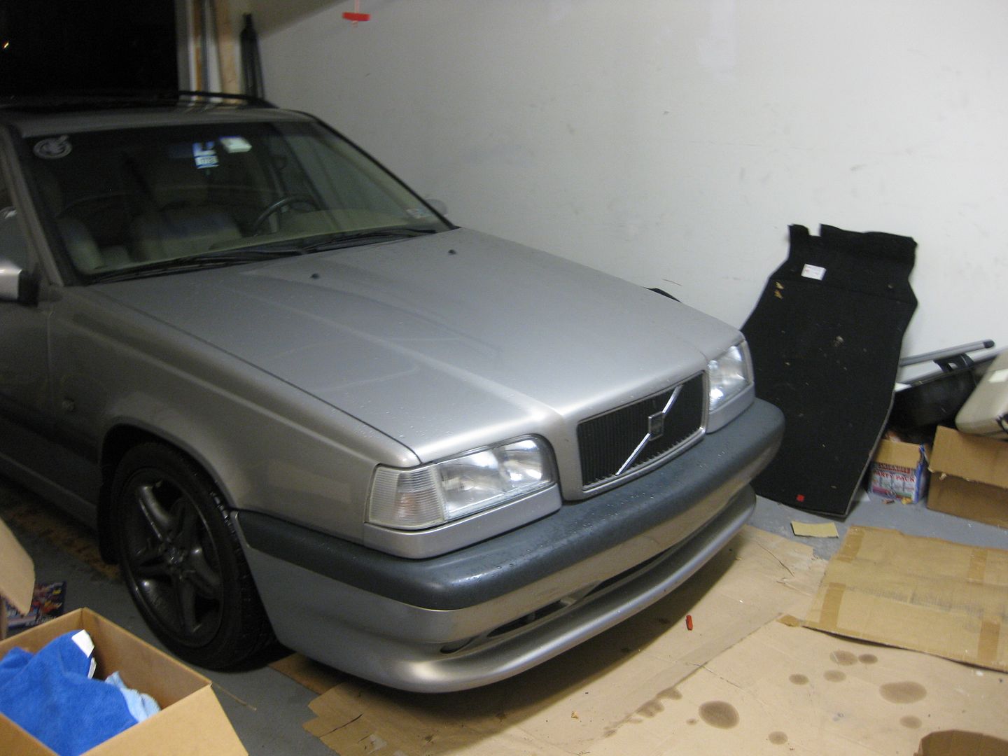

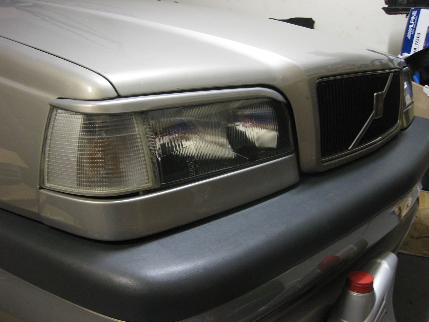

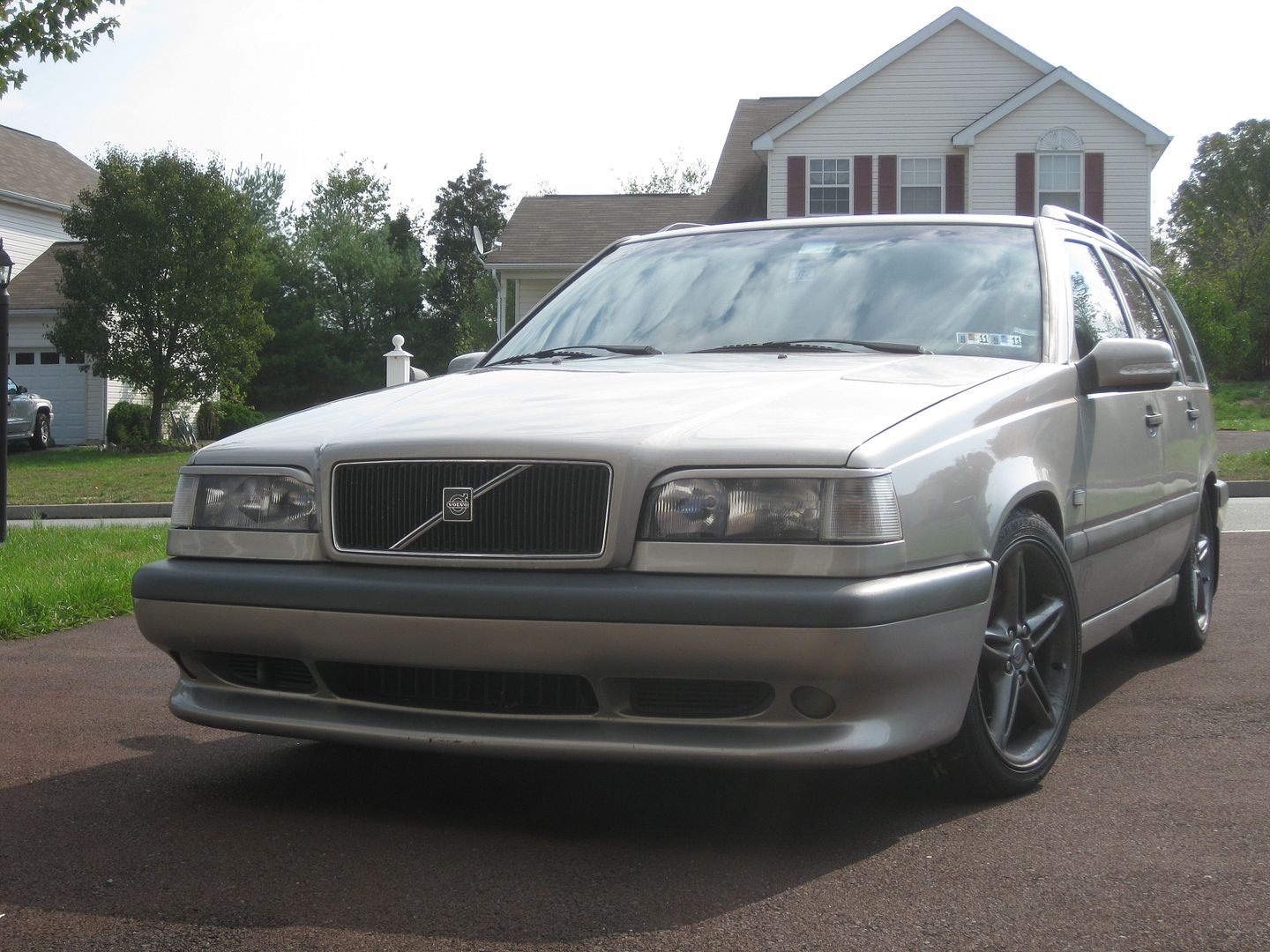

Jippi 855 GLT Posted October 12, 2010 Author Report Share Posted October 12, 2010 day pics... Link to comment Share on other sites More sharing options...
besthaticouldo Posted October 12, 2010 Report Share Posted October 12, 2010 so subtle it makes such a HUGE difference though. looks great man. Link to comment Share on other sites More sharing options...
Prezman26 Posted October 12, 2010 Report Share Posted October 12, 2010 Looks awesome Jack. Maybe next thing for me to do. Link to comment Share on other sites More sharing options...
TRACStar Posted October 12, 2010 Report Share Posted October 12, 2010 so subtle it makes such a HUGE difference though. looks great man. Agree 100% if I still had stock lights this would defiantly be done. It makes them look soooo much better, and the E-codes really set it off. :tup: Link to comment Share on other sites More sharing options...
