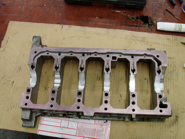

Boxman Posted October 5, 2011 Author Report Share Posted October 5, 2011 Well it's still on the engine stand and all I've done so far really is glueing the bottom halfs together. I couldn't do any more because I didn't have the right conrods. So it's not that much of a hassle to open it up again. Also I wasn't really sure about the thickness of the liquid gasket layer I put on. When applying with the roller, i could only barely see a thin pink-ish uniform film of liquidgasket - most of the gasket was absorbed by the roller instead of applied to the metal. I've seen others make it really pink (still uniform) while mine was closer to transparent than pink. As for the horror story; i've actualy heard several. One from a Dutch guy who said those Glyco's were bad, others from someone on eBay who spun them, but had no problems with OEMS, and another on here who had them fall apart, badly damaging his crankshaft.But those were actually the rod bearings, not the mains. Link to comment Share on other sites More sharing options...
Johann Posted October 5, 2011 Report Share Posted October 5, 2011 Surface needs to be cleaned very well, also degreased. After applying the gasket with a roller small drops must remain. The drops are tiny yes but when the surface is clean and also flat it should form an adequate film and seal well. Before seal, After, Use a fine meshed foam roller. And yes those are Glyco bearings.. ;) Link to comment Share on other sites More sharing options...
