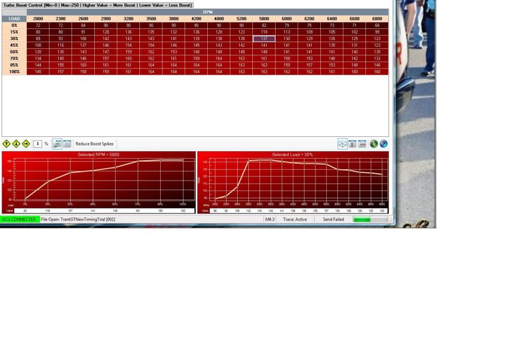

Über855R Posted February 14, 2013 Author Report Share Posted February 14, 2013 http://i66.photobucket.com/albums/h280/Bendino1/TimingMap_zpsb7b47ab5.jpg http://i66.photobucket.com/albums/h280/Bendino1/FuelMap_zps79a0a05e.jpg http://i66.photobucket.com/albums/h280/Bendino1/BoostMap_zpsb6be118a.jpg These are the current maps I am running. This is about 12 psi and the afrs are basically ironed out. I used a tune from 854GTA+, modified ever so slightly. The car seemed to detonate in the range at the bottom of the timing table so I lowered the advance to 11* and that seemed to go away, it was at 12 previuosly. I considered going down another degree but there doesn't seem to be a problem so I am not messing with it for now. The boost table is fun to play with. I had to keep pushing my boost values lower and lower in the 0-30% load range to try and keep the overboost situation from happening. It seems to be working out but I need more testing to be sure. Things do seem to be working pretty good with the boost control but I might have to chase down a spike still at part throttle in the middle of the load range I got 15 psi a couple of times accidentally. The bypass valve seems to be doing its job, even at low boost levels on lift off I can hear it fluttering open. I think my boost spikes are just from boost control issues. The gauge shot up to 20-22 psi for a half second or so. Scary. But the big flashing lights did a good job of letting me know and I backed off. It's amazing how quickly this turbo can build boost. I imagine when I actually want 18-20 psi it will be there at a moments notice. Link to comment Share on other sites More sharing options...

lookforjoe Posted February 14, 2013 Report Share Posted February 14, 2013 These are the current maps I am running. This is about 12 psi and the afrs are basically ironed out. I used a tune from 854GTA+, modified ever so slightly. The car seemed to detonate in the range at the bottom of the timing table so I lowered the advance to 11* and that seemed to go away, it was at 12 previuosly. I considered going down another degree but there doesn't seem to be a problem so I am not messing with it for now. Fixed links. Looks like the maps could use more refining. Not sure why there is so little timing in some areas. Fuel map usually you want a little more fuel in the peak (mid range) areas. Transitions can be smoothed better - I wouldn't have the same values from 6-35% Link to comment Share on other sites More sharing options...
