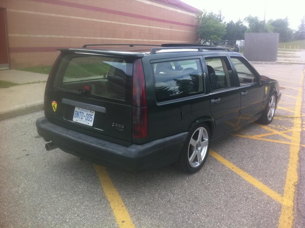

Kevin. Posted June 18, 2013 Report Share Posted June 18, 2013 He has a yellow now OP, that isn't a AWD with a M58 is it? Just want clarification since the only manual 850 wagons I have seen stock were olive green and were the AWD M58 transmission. In the US and Canada, anyways Link to comment Share on other sites More sharing options...
RBoy8 Posted June 18, 2013 Report Share Posted June 18, 2013 So you still got the Volvo or what? He has a yellow now ^ that Kev, that most likely is not an AWD. Link to comment Share on other sites More sharing options...
survolvo Posted June 18, 2013 Report Share Posted June 18, 2013 I didn't think the m58 was AWD, it has the LSD in it though right? Confused it with a m59, carry on. Link to comment Share on other sites More sharing options...
woah4 Posted June 18, 2013 Author Report Share Posted June 18, 2013 M56 Fwd car, no lsd. M58's were AWD, basically mechanically identical to an m56 but with an adapter for the rear axle where the passenger side axle leaves the housing (to the best of my knowledge). Didn't want an AWD even though I did have an opportunity at a few of them, as they are LPT and the awd is notoriously weak. I want to make some power. The M59 has an LSD, but was only on 850R's and I think it is known to not be as strong as an M56... I intend to get a quafie when I get to that stage. -Billy Link to comment Share on other sites More sharing options...
