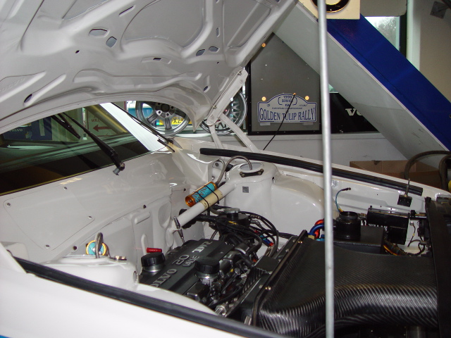

Johann Posted August 23, 2005 Report Share Posted August 23, 2005 Take a look below the windscreen.. ;) Link to comment Share on other sites More sharing options...
