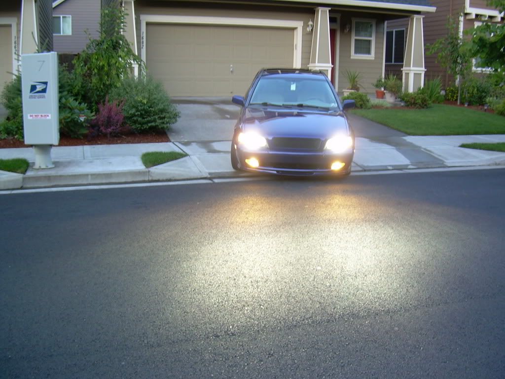

'93 Dave Posted November 7, 2007 Report Share Posted November 7, 2007 hids with stock lenses..crazyness glare Link to comment Share on other sites More sharing options...
TBM Posted November 8, 2007 Author Report Share Posted November 8, 2007 hids with stock lenses..crazyness glareYeah, I have HIDs in my stock lenses, and was looking for a comparison. Do you have a pic of the car above with HIDs and ecodes? Link to comment Share on other sites More sharing options...

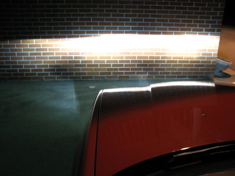

'93 Dave Posted November 8, 2007 Report Share Posted November 8, 2007 Yeah, I have HIDs in my stock lenses, and was looking for a comparison. Do you have a pic of the car above with HIDs and ecodes?i skipped ecodes and went with something better Link to comment Share on other sites More sharing options...
TBM Posted November 8, 2007 Author Report Share Posted November 8, 2007 Jewels? They look more yellow than your stock lenses...prolly a bad pic? Link to comment Share on other sites More sharing options...
RedTurbo850 Posted November 8, 2007 Report Share Posted November 8, 2007 The HID will have the same beam as the E-codes but it's going to light up much whiter and brighter. Link to comment Share on other sites More sharing options...

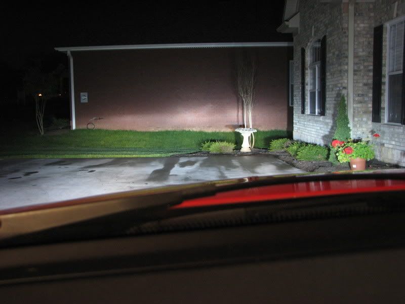

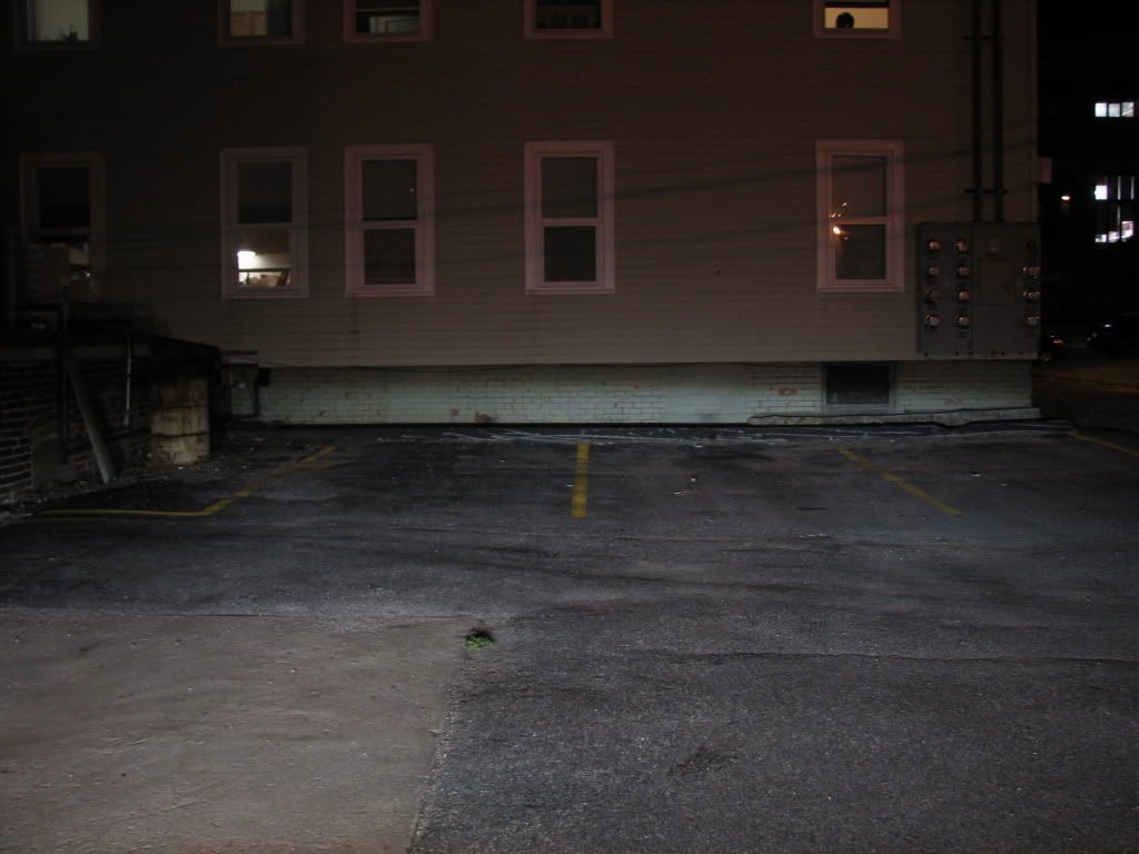

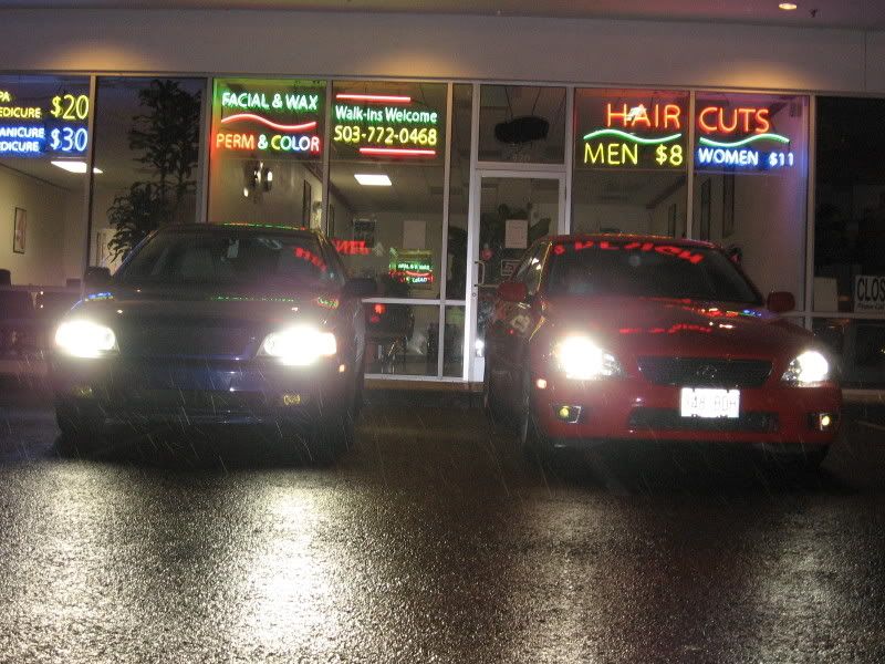

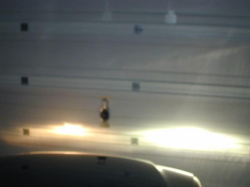

theForgottenone Posted November 8, 2007 Report Share Posted November 8, 2007 I was lazy to take before shot for comparison in good angle.Left OEM, right E-code - 4300K mydepot kitLeft OEM, right E-code - 4300K mydepot kitVersus my friend IS300 stock HID. Those with 8K or 12K HID bulbs, see if you can get the road light up like this in the rain Angle shot but you get the idea of light distribution on the road. Link to comment Share on other sites More sharing options...
TBM Posted November 8, 2007 Author Report Share Posted November 8, 2007 theForgottenone:Would you say the Ecodes are worth it? Link to comment Share on other sites More sharing options...
msestina Posted November 8, 2007 Report Share Posted November 8, 2007 theForgottenone:Would you say the Ecodes are worth it?Ecodes are Euro spec. Consider in Europe, they drive at much higher speeds, sometime unlimited. To drive that fast at night you better be able to see further down the road and to the side as objects will come up quick. They are better. Link to comment Share on other sites More sharing options...

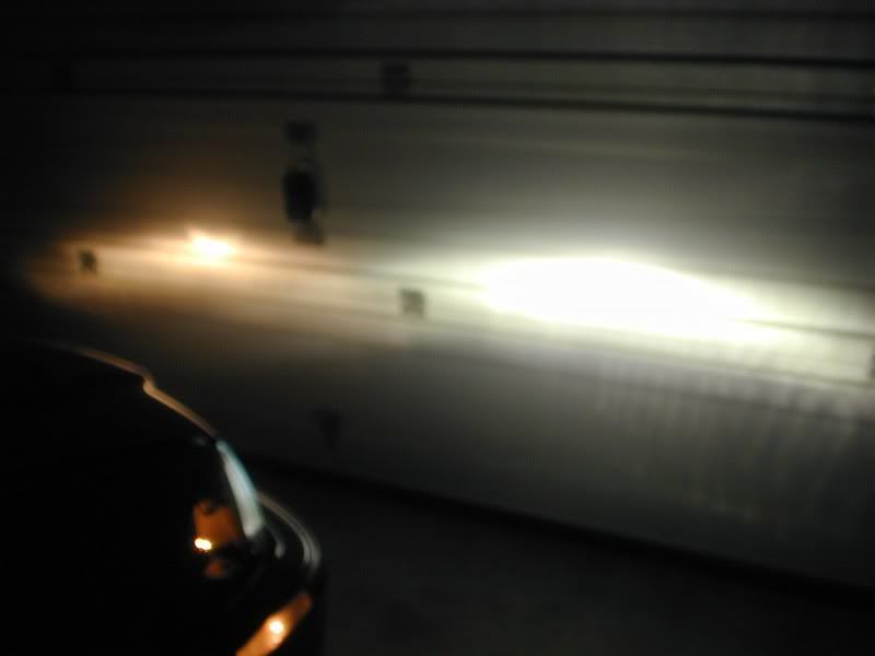

NGB Posted November 8, 2007 Report Share Posted November 8, 2007 Jewels? They look more yellow than your stock lenses...prolly a bad pic?Those are Acura TSX projectors.Those are Acura TSX projectors.I have Infiniti FX projectors (the stock fluted lenses are why I do not have a sharp cutoff): Link to comment Share on other sites More sharing options...
theForgottenone Posted November 8, 2007 Report Share Posted November 8, 2007 theForgottenone:Would you say the Ecodes are worth it?If you do not have projectors setup, E-code is better for distributing light evenly and not giving the oncoming drivers any glare issue with HID compare to DOT headlight lense. Otherwise, projectors is the best setup. Link to comment Share on other sites More sharing options...
