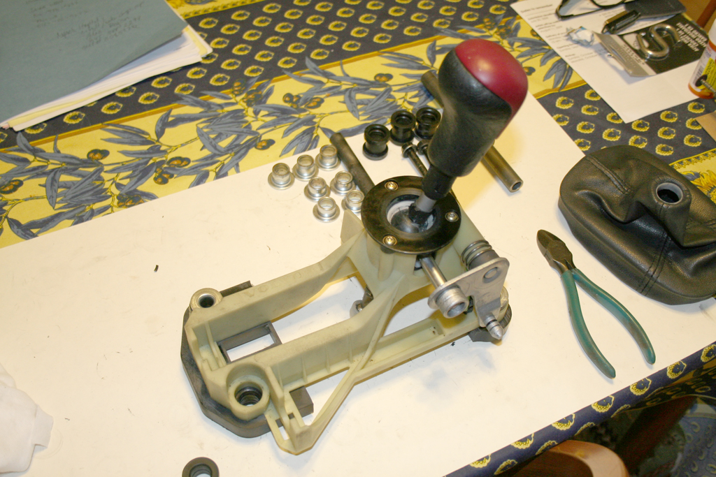

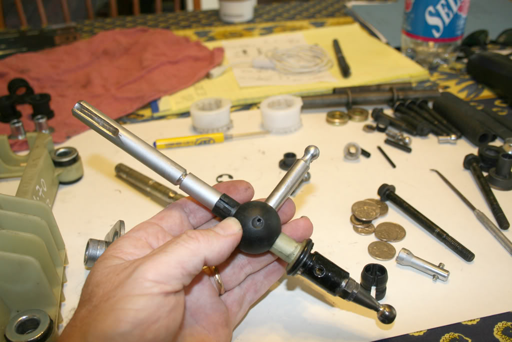

lookforjoe Posted April 30, 2009 Author Report Posted April 30, 2009 http://i27.photobucket.com/albums/c190/huseinholland/CarMods/Shifter%20Mods/XCM66shortShifter0005.jpg just need to add the groove for early ('00) shifter - spaceball shift uses a totally different attachment method Ball Stud for earlier (-'00) cables is larger OD - I had to cut the ball off the old shifter, drill it out & braise it onto the tailgate stud I am using... Quote
