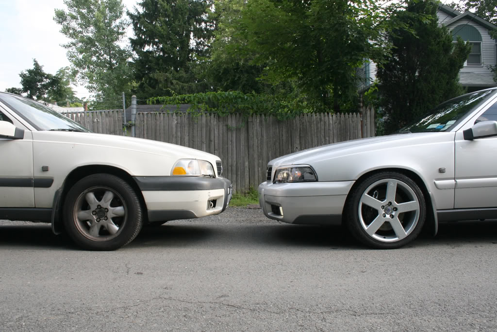

lookforjoe Posted July 13, 2009 Author Report Posted July 13, 2009 TME Spring Set http://i27.photobucket.com/albums/c190/huseinholland/CarMods/V70XCloweredTMEsprings0007.jpg http://i27.photobucket.com/albums/c190/huseinholland/CarMods/V70XCloweredTMEsprings0009.jpg http://i27.photobucket.com/albums/c190/huseinholland/CarMods/V70XCloweredTMEsprings0008.jpg compared to stock XC 2 Quote
Chilled man Posted July 13, 2009 Report Posted July 13, 2009 wheels need more color As always man AMAZING 2 Quote
