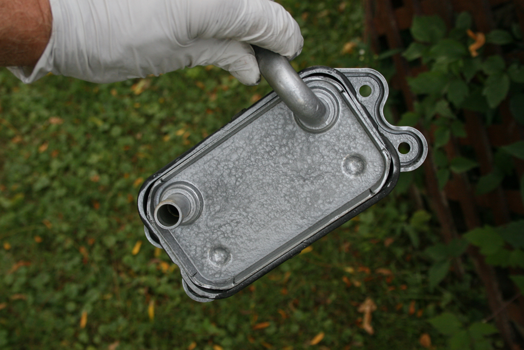

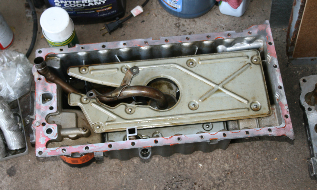

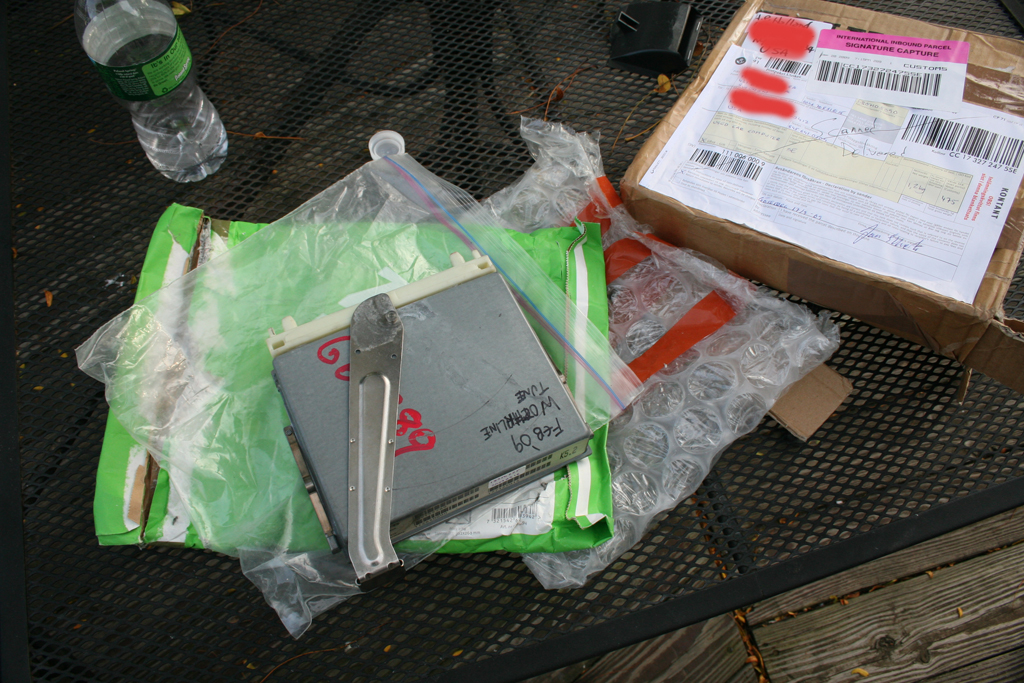

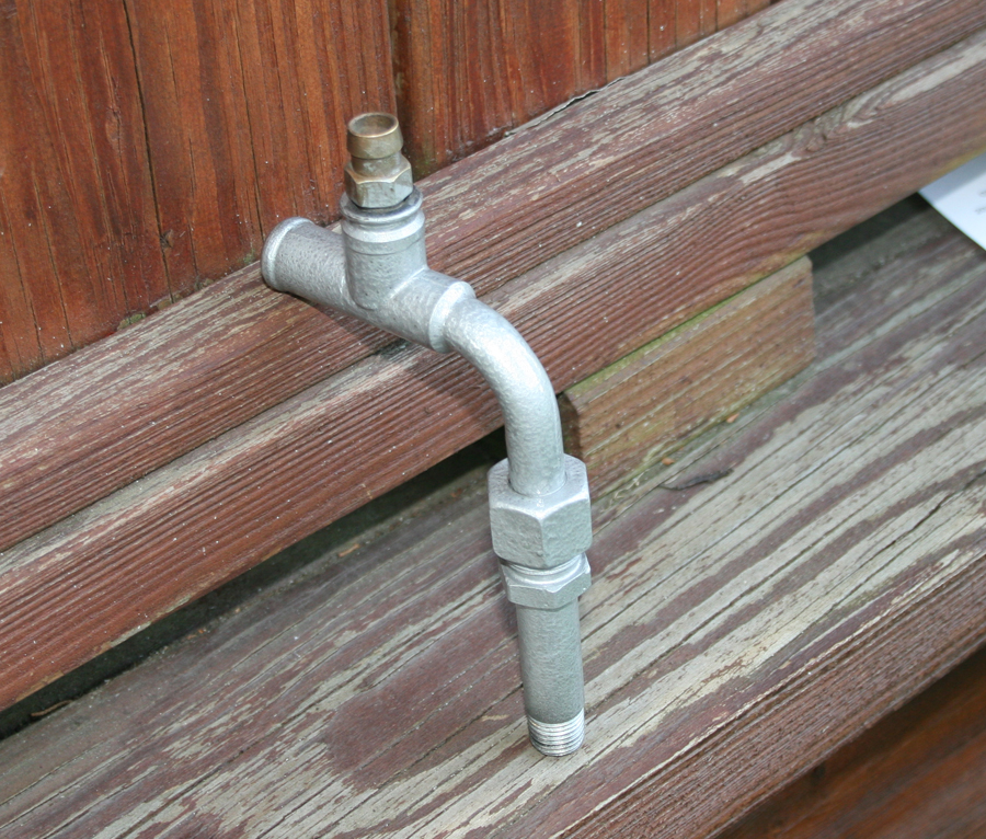

lookforjoe Posted September 25, 2009 Report Share Posted September 25, 2009 Haven't been driving the XC of late - the X1/9 has become my DD However, my revamped tune came today! Set for 625cc injectors and my 20g!!! Looking forward to checking it out! (still waiting for TT to release the ME4.4 I paid for back in July) However... I have to put my car back together first - I took the pan off so I can update to the newer style w/oilcooler... Newer pan & pickup -98 pan repainted revised water pipe for oil cooler feed pipe oil cooler Hopefully I'll have time after work tomorrow to put it back together... 4 Quote Link to comment Share on other sites More sharing options...
rbodor3 Posted September 25, 2009 Report Share Posted September 25, 2009 did you galvanize everything? 1 1 Quote Link to comment Share on other sites More sharing options...
lookforjoe Posted September 25, 2009 Author Report Share Posted September 25, 2009 did you galvanize everything? Hell no - that's rustoleum hammer finish :lol: 1 Quote Link to comment Share on other sites More sharing options...

yangotang Posted September 25, 2009 Report Share Posted September 25, 2009 besides the pan and pickup tube, what's else is needed to get this mod done? Quote Link to comment Share on other sites More sharing options...
lookforjoe Posted September 25, 2009 Author Report Share Posted September 25, 2009 besides the pan and pickup tube, what's else is needed to get this mod done? All the pieces I show - water dist. pipe & return, turbo oil & water feed lines, oil cooler, new oil cooler hoses, all new seals & gaskets, a bunch of clamps for all the lines.. anaerobic sealer... about $100 in new 'soft" parts Quote Link to comment Share on other sites More sharing options...

lookforjoe Posted September 26, 2009 Author Report Share Posted September 26, 2009 Got the water dist pipe back in this evening - I would NEVER do this job unless I really needed to - it's a royal PITA to get it in with the exhaust/driveshaft/turbo oil&water lines in the way. Pick up tube is in... Oil pan ready to go back tomorrow.. I'll be taking some video once it's all up & running.... Quote Link to comment Share on other sites More sharing options...
