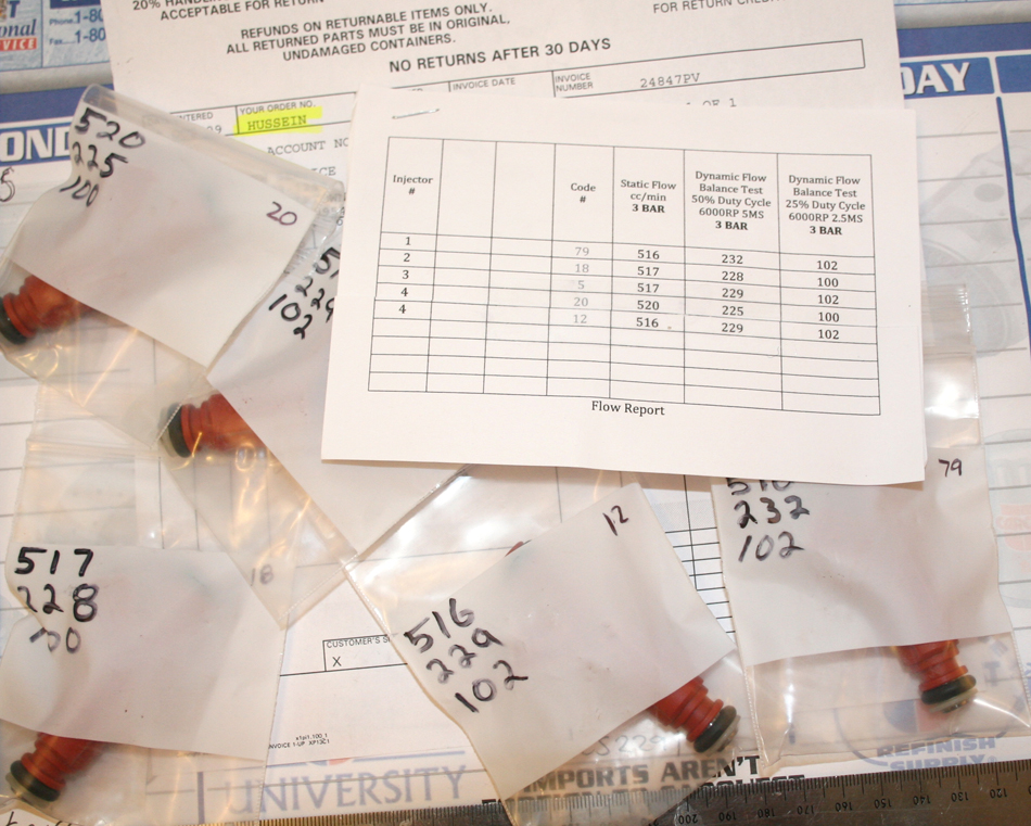

lookforjoe Posted October 10, 2009 Author Report Posted October 10, 2009 50lb Red's came today; Five-O provides flow data with the set should have time to install them tomorrow.. Quote

lookforjoe Posted October 12, 2009 Author Report Posted October 12, 2009 Ordered Innovate IN-3790 & SSI-4 so I can start datalogging my shit. Getting tired of the seat of the pants testing & trying to note what AFR's are at... this does mean I'll need to start using a fkn PC, I guess. My mac laptop doesn't run Windows, it not intel processor. I'll need to do this for TT anyway, so I guess I'll just have to get used to the darkside ..put the 50lb reds in today, @ 4bar base (605cc) - 3.2bar under vacuum 5.2bar under current boost level of 22psi. AFR's settled to 14.7 @ idle no problem, but in a 3rd gear pull, AFR's climbed to 14 by the end of 3rd gear. So, it's too lean @ 605cc, and I'm still not up to 24psi I'll try tweaking the base pressure to get the 625cc range back. This all suggests that the 625cc Siemens just don't like ME4.4 - I guess. The vendor said they all flow tested "fine" but won't provide flow data unless I pay $10 per injector. Guess I won't be buying from EFI Components again. Quote

lookforjoe Posted October 13, 2009 Author Report Posted October 13, 2009 If I had the time and didn't need my car as a DD I would have loved to do your setup with the 20g. But because of time I had to throw on a "19T". Nevermind f'ing with the downpipe, all the drain tubes and feed lines would drive me absolutely insane for a weekend project. Not to mention I'm not the best welder. I gotta get this 98 s70 N/A up and running (got for $200) So I can have a second commuter to do my turboooooooo upgrade If those red injectors are doing you well let us know as I'm very curious about them, and let me know how your walbro holds up The injectors are modified by Five-0 to run @ 50lbs, and they're working great! The FP is the stock AWD pump - which is higher volume than the FWD models. I don't intend on replacing it anytime soon. Once the tune is revised so I can drop my base pressure back under 3.8bar, this pump should be fine. It was OK with the greens @ 5bar, just couldn't go over 17psi boost because it would lean out, but that's more likely due to the discrepancy between the tune & maxxing out the greens... Quote
