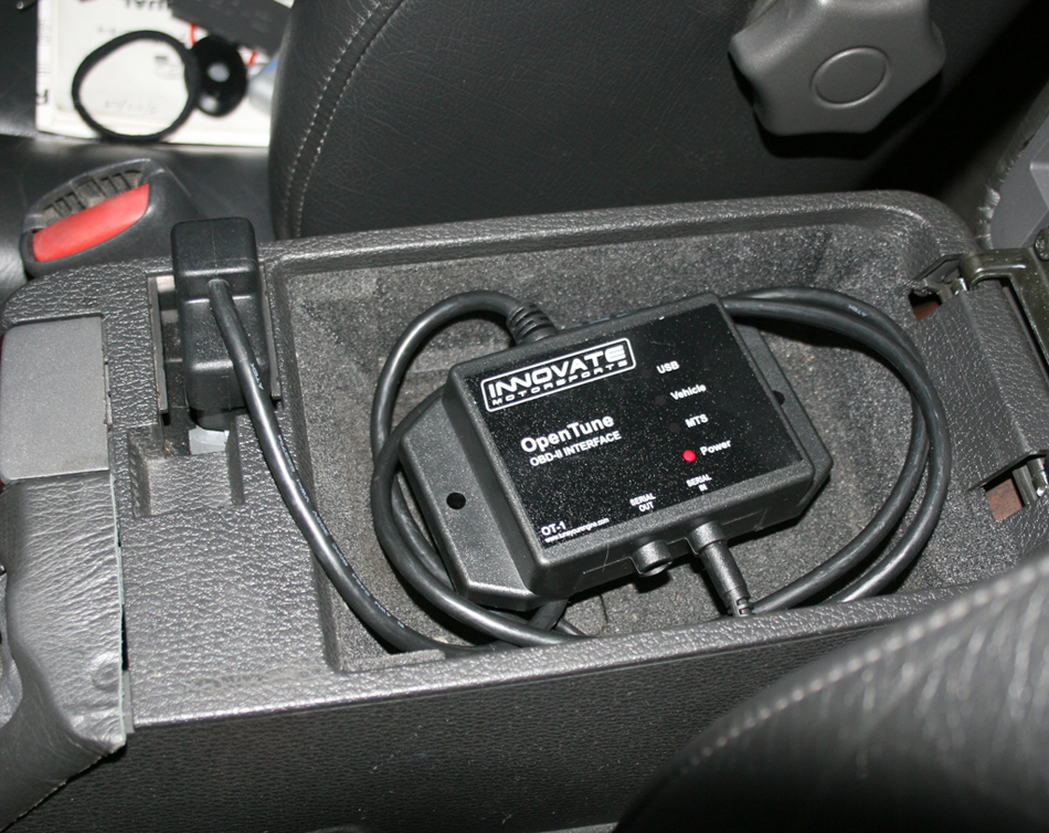

lookforjoe Posted October 17, 2009 Author Report Posted October 17, 2009 Datalogging equipment arrived today.... Innovate OT-1 & SSI-4 Put this up under the dash -converts analog signal from AEM Wideband for input into the OT-1 serial cable from SSI-4 routed under center console & out into armrest storage.... OT-1 connected.. tomorrow I have to do some trial datalogging... to evaluate the fuel & ign mapping then I can move onto TurboTuner :D Quote

lookforjoe Posted October 18, 2009 Author Report Posted October 18, 2009 1) OT-1 doesn't work - no "vehicle" light - it's not drawing ECU data. Tried with & w/o SSI-4 connected. LCM Programmer does not see any connected devices via USB/serial adaptor (OT-1). So, no datalogging. 2) TT ECU sets a CEL P0605 (ECU RAM error). Map Trace feature disabled. Basically a shit weekend. On the upside, Adam @ TT is great to deal with, responds REALLY promptly, and is taking care of it, BUT, it still means I won't have a working TT setup for a couple of weeks, maybe longer. Quote
