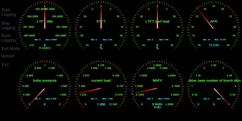

razorx Posted March 4, 2015 Report Share Posted March 4, 2015 I have been thinking about every day data logging, any trip, It would nice to have the facility to turn any daily drive into a data logging session. What do you need: A PC small enough to fit in your hand shoe department, Can be an intel NUC or an Asus Transformer. This PC will run Tuner Pro. I have an Android double DIN device but any Android device like your phone can take over the screen of this tiny device running Windows and TunerPro. Just using RDP. What will be the result: In car real monitoring data everyday. As well as logging and saving te information concerning your ride. To make this idea more visuable i'll illustrate this with an example: This was a carputer I created a long time ago. You see the one touch interface around the central screen. The central screen can be anything. TunerPro too. Nicely resized. With the use of frontends like CentraFuse, Stardock or Frodo and some help of NirCMD it is possible to put TunerPro into the main sceen. How should this look? A raw scetch: Link to comment Share on other sites More sharing options...
