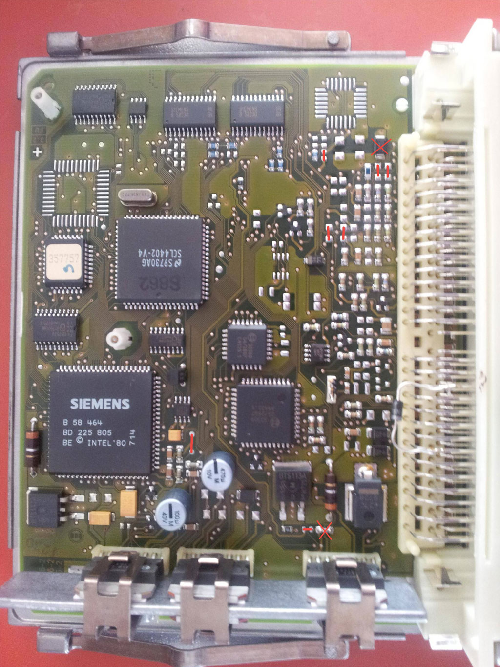

Johann Posted February 26, 2013 Report Posted February 26, 2013 The one I have here compared to above posted pic,
Tightmopedman9 Posted February 26, 2013 Author Report Posted February 26, 2013 Johann, is that a turbo ECU?
Johann Posted February 26, 2013 Report Posted February 26, 2013 Johann, is that a turbo ECU? I think, or pretty positive, it is NA but the cover on it is from another ECU with the wrong number. (Says 850 2.3 T5 ...)
Tightmopedman9 Posted February 26, 2013 Author Report Posted February 26, 2013 Hmmm... that is different. Can you get the datasheet on the chip in the far bottom right corner? It isn't on any S70/C70/V70/850 ECU's I've seen. On another note I got SAS disabled in software, so no more need for a diode. I'm working on taking care of EVAP right now...
