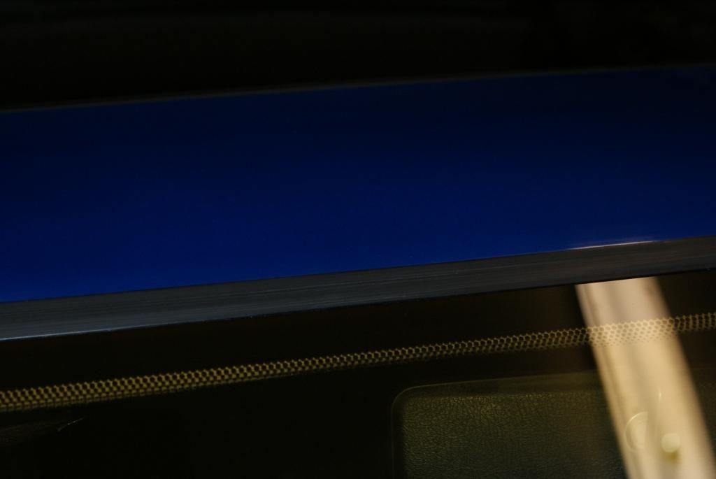

dougy Posted December 22, 2014 Author Report Posted December 22, 2014 Did you swap s80 rear seats in as well can't tell by pics yes, just the bottom to match the fronts...it tight/hard to cram it in, but possible. Yeah. Same reason I'm asking so many questions. Parts of my brain see my car as "probably should part it/crush it" and the other parts say "paint it... saaaave it." This helps. forgot all about front upper windowsill weatherstrip...so i installed that last night...used a thin double clear tape to put on the edge / inter lip over the newly painted channel...then filled in with 3m windshield weld and put that chopped of s80 weatherstrip...reason for the thin clear double tape , if i ever hate remove/replace windshield ,I 'll be able to simply peel the window weld of the painted edge and not cut and damage the new paint. it will never come/fly off and it is waaay better quality rubber than aftermarket stuff. here it is all done. 3 Quote
