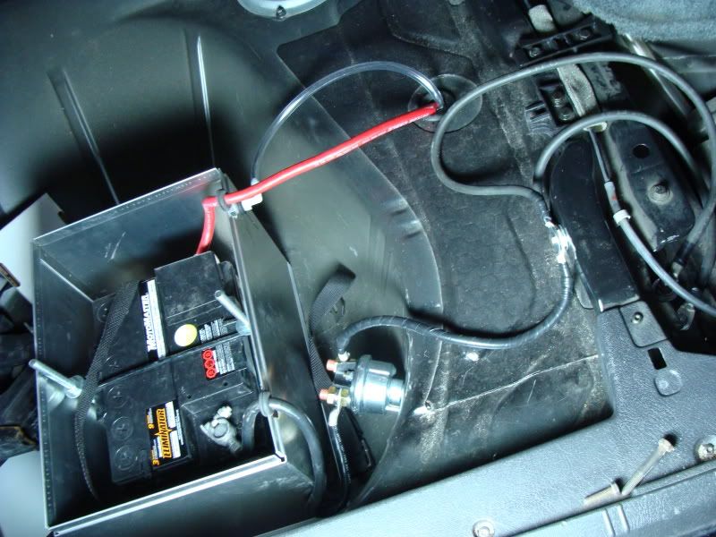

project_850 Posted December 20, 2014 Report Share Posted December 20, 2014 I did: I ran the wires under the car, super easy using the Taylor Vertex kit. For my wife's car I actually copied what you did with your 855R: Link to comment Share on other sites More sharing options...

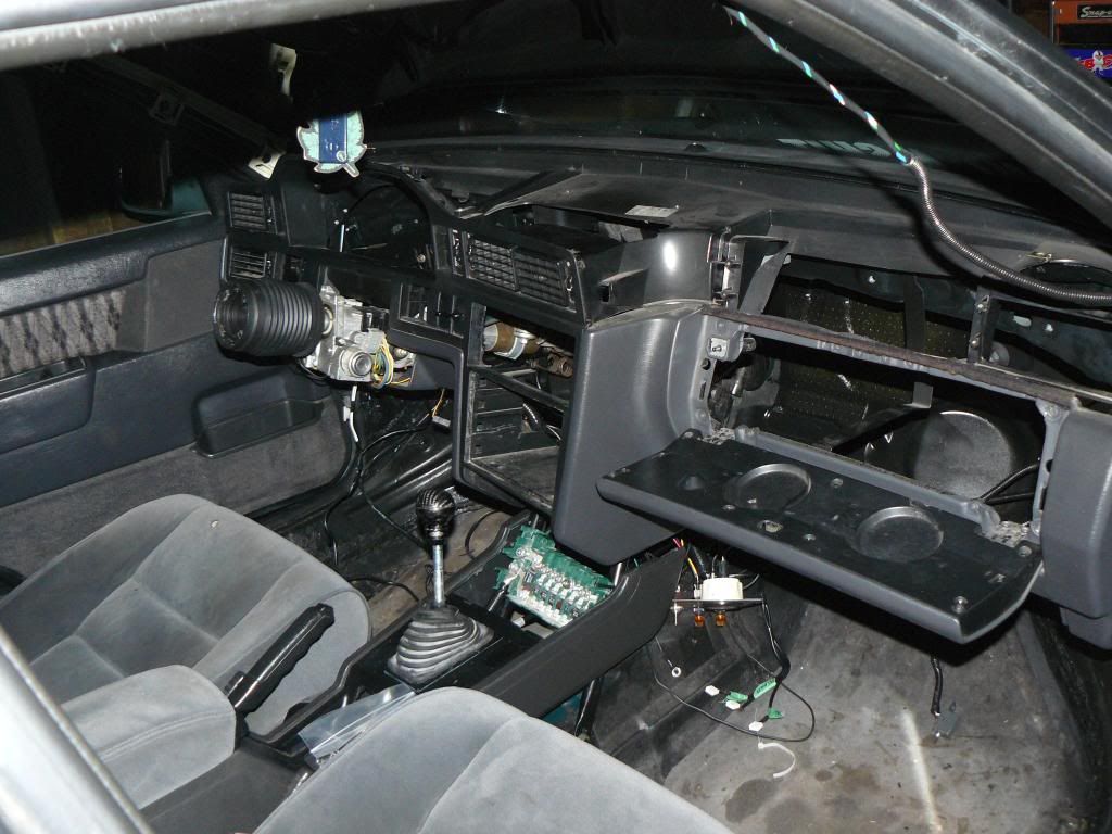

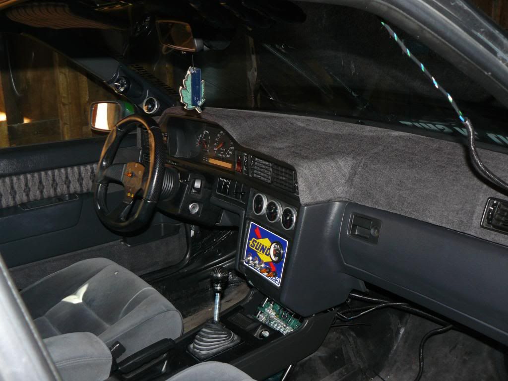

Falcone Posted January 19, 2015 Report Share Posted January 19, 2015 I bought 25ft of black 0 gauge cable. Went to Jy and grabbed a fuse distribution block from the trunk of a 540i, and tore all my interior wiring out. Re did everything to run thru the fuse block. Only powered what I needed Wiring the cabin Back together Battery is a gel battery thats mounted by the wheel well in the trunk. Still have my spare Link to comment Share on other sites More sharing options...
