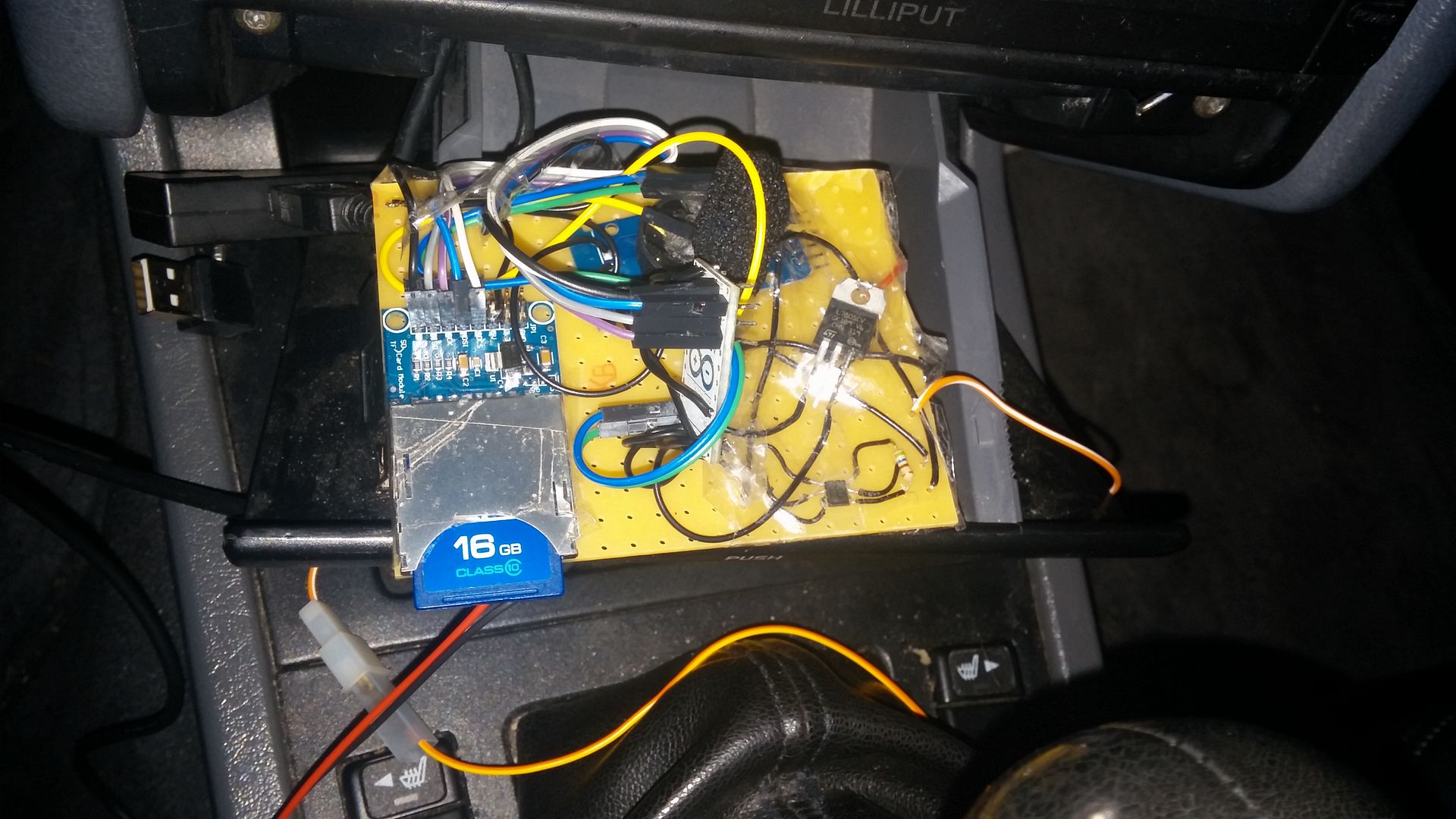

Popular Post venderbroeck Posted September 15, 2015 Author Popular Post Report Posted September 15, 2015 (edited) It's been a while, but I've been working on a new trinket in my spare time.Here it is:This gem is a little rough to look at still, but it makes up for that in functionality.Everytime I start my car and a sd card is inserted in the slot, it will:-Create a file with the current month day hour and minute as the filename.-determine the size of the frames that are coming in.-record the frames on the sd card-update the "last modified" timestamp of the file after every frame.And the thing that really makes this awesome is that it creates the log in the correct tunerpro .xdl format. So it can be loaded straight into TunerPro.I'm thinking of adding a usb port to make it a direct replacement for the vag com cable.I'll probably also add a piëzo speaker to signal for knock events and stuff like that for some added functionality.I'm still contemplating wether to put it all inside a obd plug housing, or to make a seperate housing with an optional obd extention attached to some screwheaders.After driving around with it for a bit I can say it really simplifies things. Just stick in the card, start the car and just forget about it. Leave it in for a week or a month, and it produces a neatly ordered row of logs for every drive you did. Edited September 15, 2015 by venderbroeck 1 12 Quote

gdog Posted September 16, 2015 Report Posted September 16, 2015 (edited) Pretty f****** sweet!!Can't tell from here but what kind of electronics you got in there? A micro-controller proto board plus level-changing logic?BTW: how is it that you have any spare time?! Edited September 16, 2015 by gdog 1 Quote
venderbroeck Posted September 16, 2015 Author Report Posted September 16, 2015 Thanks everyone ^^I have a micro, the sd-card module, and a RTC in there.Also a little something for the k-line interface, and you can see the lm7805.I don't have much spare time as I'm also building a logbox for someone.That's why it's still looking like that.Most of the work was reverse engineering the xdl format, and programming. 1 1 Quote
