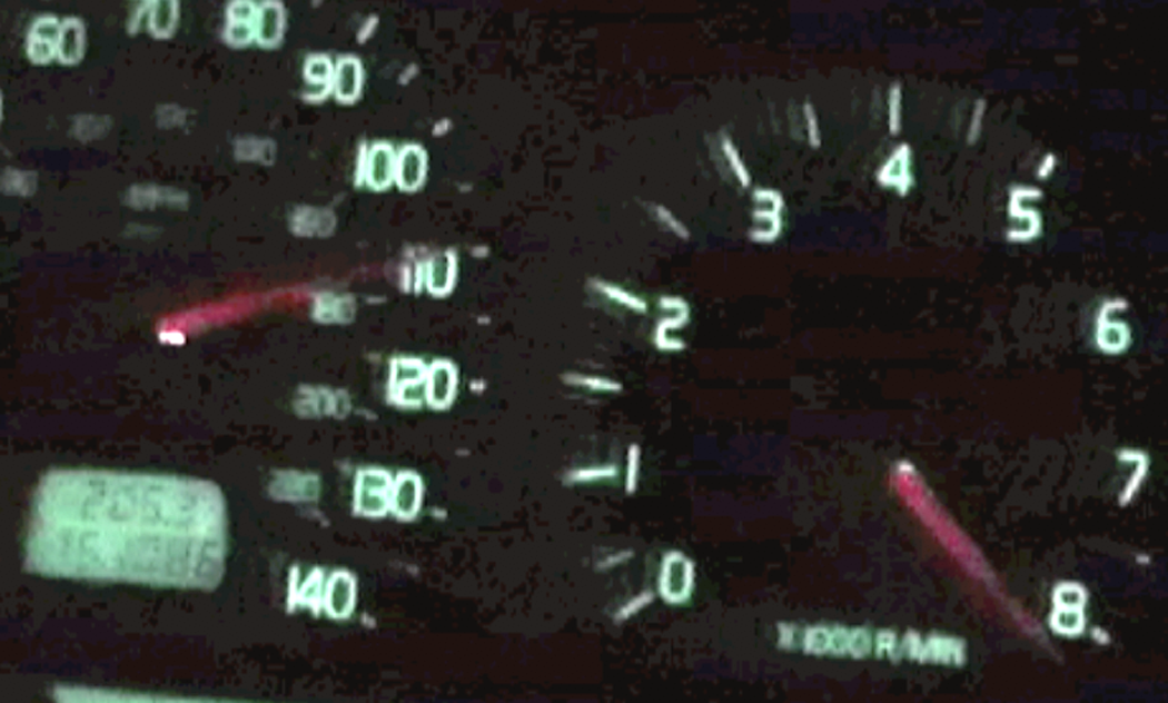

Simply Volvo Posted November 6, 2020 Author Report Posted November 6, 2020 Car is running really well in locked 4WD mode 3 Quote
B_Dub Posted November 7, 2020 Report Posted November 7, 2020 Thing sounds angry, glad it’s hookin’ up! Turn it up and hold on for dear life! 😂 1 Quote
lookforjoe Posted November 7, 2020 Report Posted November 7, 2020 Nice!!! It is so much fun running a T5 motor to 8,5- 9K rpm - nothing beats the sound it makes, and with the AWD it just goes as you have found 1 Quote

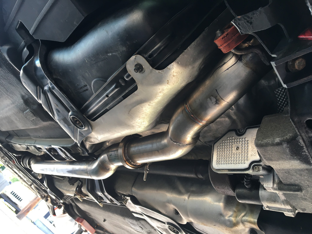

Simply Volvo Posted November 28, 2020 Author Report Posted November 28, 2020 (edited) Took a little break for a few weeks. Started back up this week and bought a TIG welder to make SS 304 3.5" exhaust. I'm really enjoying the TIG so far and picking it up fairly quick. I purchased a Borla XR1 3.5" straight through muffler and 3.5" Vibrant bottle style resonator which are not pictured below. Also not pictured is the flex coupler which came today. Edited November 28, 2020 by Simply Volvo 2 Quote

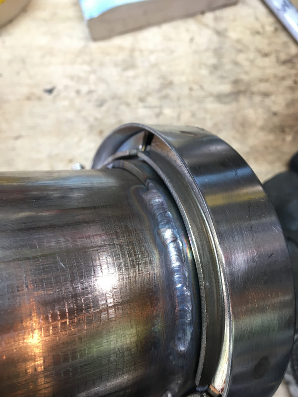

lookforjoe Posted December 17, 2020 Report Posted December 17, 2020 Looking good so far Matt! Better to go low amp & allow the metal to fuse instead of a large bead w/SS. The V-Bands are the toughest (for me) - getting a good angle & flowing the SS Vband into the pipe. The trick is to always start on the heavier gauge piece - which is sometimes easier said then done... This is one of mine - not a perfect weld by any means, but OK. I keep the clamp on it to reduce warping the flange from the heat. The main thing with SS is to STOP if the metal gets too hot - I'm bad at that as I'm not a patient person by nature Curious why you didn't opt for some Mandrel bend sections - makes life much easier, except for really tight areas like the DP/hotside bend. Some blobby welds visible here. 1 Quote
Simply Volvo Posted December 17, 2020 Author Report Posted December 17, 2020 (edited) 1 hour ago, lookforjoe said: Looking good so far Matt! Better to go low amp & allow the metal to fuse instead of a large bead w/SS. The V-Bands are the toughest (for me) - getting a good angle & flowing the SS Vband into the pipe. The trick is to always start on the heavier gauge piece - which is sometimes easier said then done... This is one of mine - not a perfect weld by any means, but OK. I keep the clamp on it to reduce warping the flange from the heat. The main thing with SS is to STOP if the metal gets too hot - I'm bad at that as I'm not a patient person by nature Curious why you didn't opt for some Mandrel bend sections - makes life much easier, except for really tight areas like the DP/hotside bend. Some blobby welds visible here. Thanks H for the tips. I definitely have found using pulse and fusing the metal together to be the most effective and easiest. I spent a lot of time tuning in the CUP size, gas flow, etc was getting lots of nasty black SS welds in the beginning. I didn't opt for mandrel because the DP needs to use 2" CLR and I wanted as much weld practice as possible. Im quite over the pie cuts at this point though... getting better at welding (still blobby and some pinholes), but getting there! I don't think i will buy prepolished SS again. The welds are weird. They get this weird shiny brown color. Maybe im still using too much heat (50A 1hz pulse 25-50% DC), but Ive been told its left over polishing compound that is hard to remove before welding. Here is some of my latest progress (you'll notice me mention a lot of things you said too) as I've had other tell me the same. Edited December 17, 2020 by Simply Volvo 3 Quote
