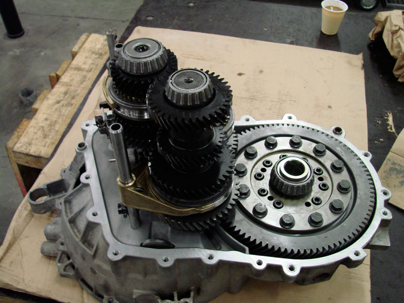

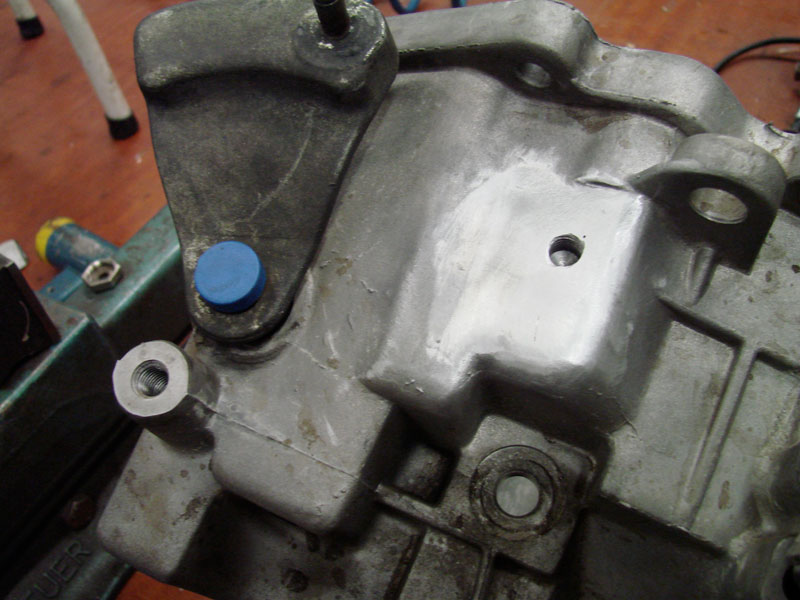

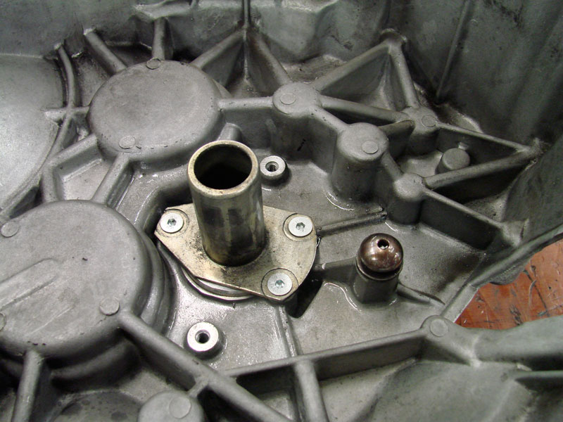

Johann Posted June 30, 2008 Author Report Share Posted June 30, 2008 Converted the M56H S/V40 gearbox to external clutch cylinder,For the conversion the big shift lever on top of the box needs to be changed to 850 style and there is a piece of metal on top of the casting which needs to be removed to make room for the shift cable,All other is identical to the 850 gearboxes. Quote Link to comment Share on other sites More sharing options...

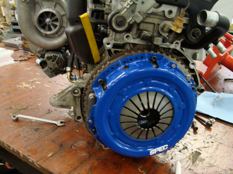

Johann Posted July 23, 2008 Author Report Share Posted July 23, 2008 Spec stage 3+ and a Quaife LSD added,The S40 gearbox as it is didn't work out. The cast is missing some mounting holes for the rear gearbox/engine mount. I decided to transfer the internals of the gearbox to the original GLT gearbox housing. Engine is back in the car now. Quote Link to comment Share on other sites More sharing options...
