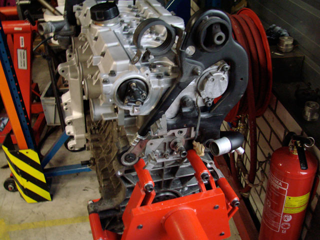

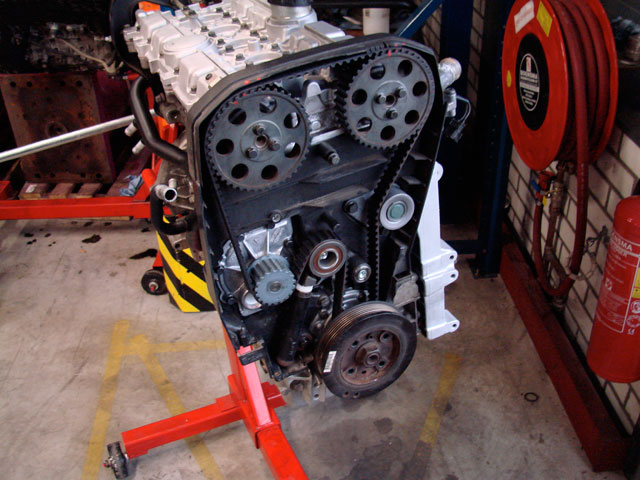

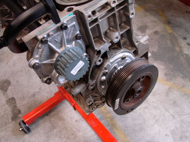

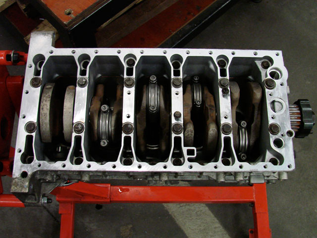

Johann Posted February 2, 2008 Author Report Posted February 2, 2008 2001 crank and China rods,Water pump, oil pump added, Quote
dmelviØØ7 Posted February 2, 2008 Report Posted February 2, 2008 So the advantage of a 2001 crank is increased displacement? Direct drop in? Quote
Johann Posted February 2, 2008 Author Report Posted February 2, 2008 So the advantage of a 2001 crank is increased displacement? Direct drop in?No, same stroke but ~8.8 lbs less. Direct drop in yes. Quote
dmelviØØ7 Posted February 2, 2008 Report Posted February 2, 2008 No, same stroke but ~8.8 lbs less. Direct drop in yes.Oh nice. Thx Quote

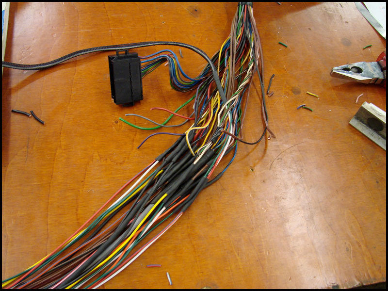

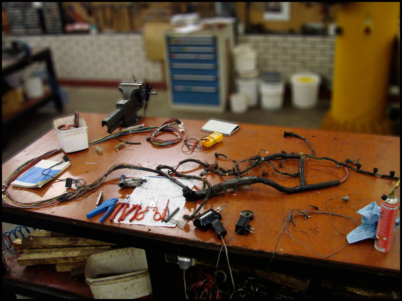

Johann Posted February 25, 2008 Author Report Posted February 25, 2008 Update,The engine rebuild is finished so far,Started another thing I kept postponing..The wiring loom for the standalone EMS,Because it is all experimental I left the looms at full length. the ECU will probably end up somewhere in the centre console..Changes made are,MAF connection removed. Injector setup changed from batch fire to sequential. connections used are,2 x knock5 x injectors1 x TPS1 x CLT1 x IAT1 x MAP2 x trigger1 x narrow band lambda for CLLThings left are RPM, ignition drive and some power.Loom is already back in the car connected on the engine, need to make a pass through in the firewall. Quote
