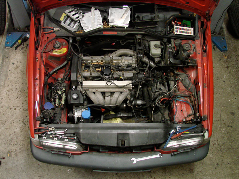

CO.T5M Posted March 5, 2008 Report Posted March 5, 2008 is that a supercharger is see in the picture if so mad props for doing it Quote
fearless Posted March 5, 2008 Report Posted March 5, 2008 (edited) Hey cool, it's in. B) Edited March 5, 2008 by fearless Quote

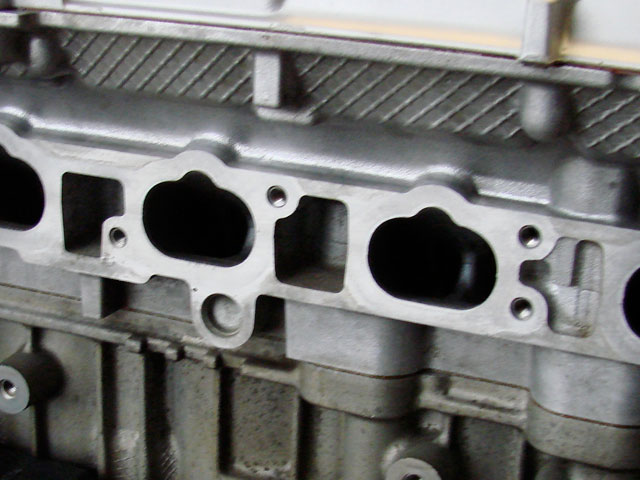

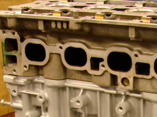

Johann Posted March 6, 2008 Author Report Posted March 6, 2008 So that wouldn't be a direct bolt on for a turbo car then...The manifold bolt pattern is the same but the port shape is totally different.NA,Turbo, Quote

dmelviØØ7 Posted March 7, 2008 Report Posted March 7, 2008 The manifold bolt pattern is the same but the port shape is totally different.Damn that sucks. It would be kinda cool if it were done. Oh well, I guess I'll just throw it away :( Quote
